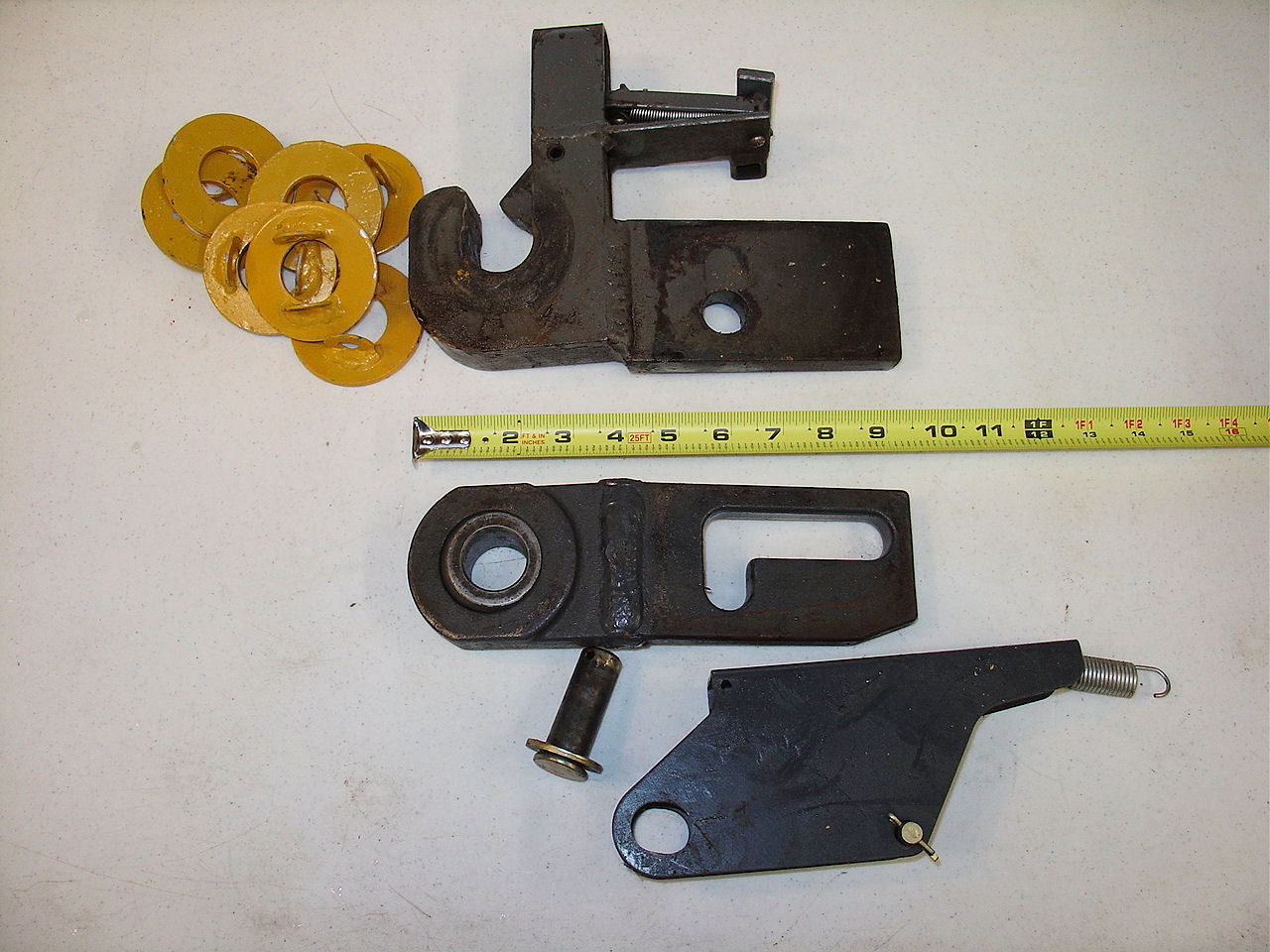

Anyway, there is another option with the Pat's. If you have the extendable ends on your lower arms then Pat's will make a hitch that will replace the extendable arms. That way, no geometry is changed and an adapter is unnecessary. But the extendable feature is lost.
The Greenwell Mfg. website is not that easy to negotiate so you might choose to call them and ask about the custom built hitch for extendable arms. I owned a set for a while but wanted to have the extendable feature also. Sold them to a TBN member with a M7040.
EDIT: Ooooh...just found a photo of the custom made Pat's (on top). OEM telescoping fixture is on the bottom.

I do have the extendable arms on the MX5100 but have not used them much (only have them on the MX and have not had that long) and tend to forget about them. But they are handy and I should get in the habit of using them. Replacement ends is an interesting option. Thanks for the photo; it is clear what they have done. But it also makes me wonder if they could have the top feature (quick hitch) and still have the horizontal slot for extension. But the extendable arm has a spring mechanism so maybe there is something in the engineering? I assume there is a reason, as having both quick hitch and extendable would be the ultimate.
And what are the yellow washers? Looks like maybe you had a bunch of custom ones made (or made them yourself) with two tabs for the lynch pin to keep it straight and in place. I've already used the hitch enough to know that I've had to reposition the washers a few times to keep them out of the way of the arms coming up from below.
