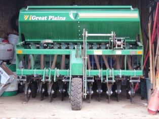

Just loaded this heavy beast onto a refer headed to the east coast with my cabbed 7040. Easy peasy, thanks Pat!
