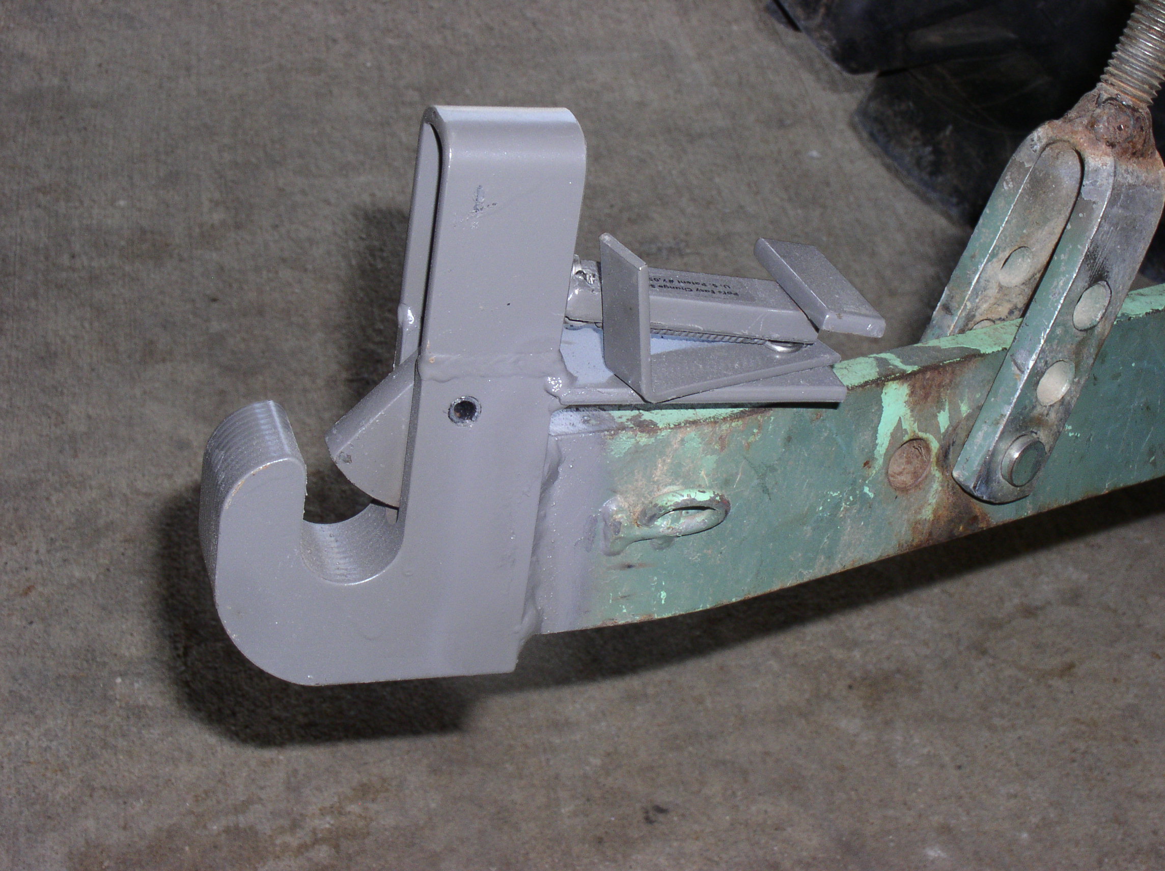

The economy hitch is not surface-finished to the same standard
as the grey coloured one that I bought and they supply the washers too.
Pat'S Quick Hitch Cat 1, Stabilizer Bar Included
Are Agrisupply still getting through the old stock style ?

Here is a photo of what AgiSupply sent me. Other than color, I see that the grey one has a rounded base as opposed to a cut-angle. So I guess there is a difference, but ....

With some tool and die backgound they do NOT look equal to me.

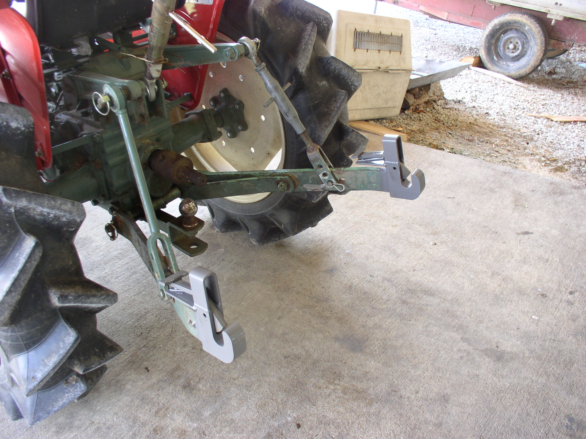

I have a question about whether the Easy Change System will fit on my tractor. I have a Kubota L3800. I read in the TBN store that the straight portion of the lift arms need to be approximately 4 inches long for the Easy Change to fit properly. I just measured the straight portions of the lift arms on my tractor and found they measure approximately 3.5 inches long. Does anyone know whether they will fit my lift arms? Thanks very much.

They'll fit your hitch . Just took this photo . Notice the measurements and compare with your actual ; quite standard .

Thanks for the photo! I just measured from the front of the link hole to the start of the bend in my lift arms. I have the same dimension you have on your tractor, 2.5 inches. I also remeasured the straight portion of the lift arms and I have approximately 3.5 inches. I will place an order this week.
BTW - I intend to use them to hook up to my 5' bush hog. The PTO shaft looks like I will have plenty of adjustment. May need a longer top link. Will know when I install the hitches. Do you hook up to a bush hog, if so how do they work for you?

The extra length of the arms require a few inches of twisting added to the top link , and your propshaft will be too short ( mine was .... ) probably.

Make sure the hitches are spread to the correct separation BEFORE you adjust the alignment to "square" ( the 2 bolts assem on each side ) with the implement pin orientation , or it won't hook-up to the Hog neatly.
You'll easily see what I mean if it's out-of-wack when you first attach something.
