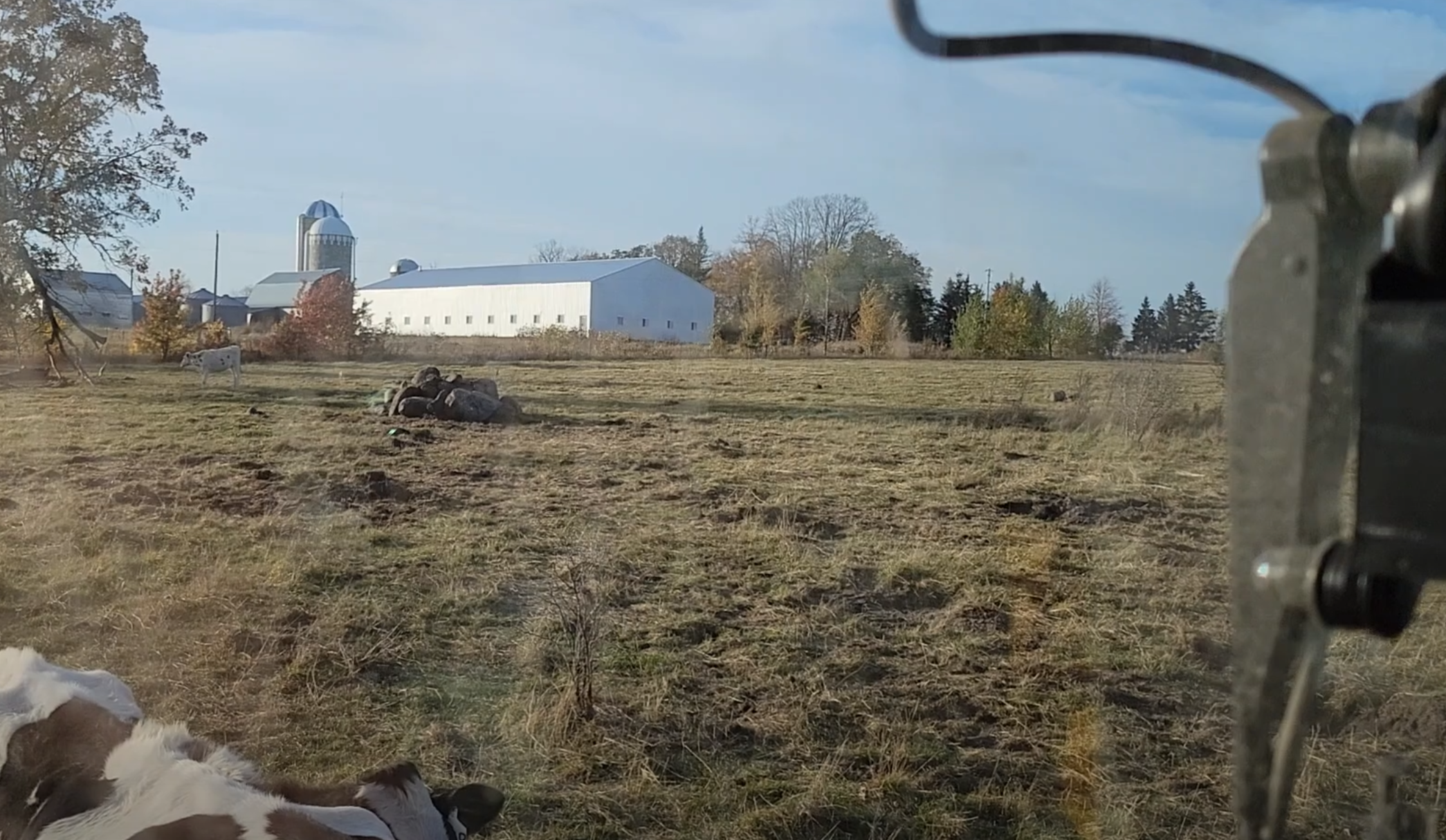

so I'm fairly deep into my project and I can add what I've done and learned so far.
I split the pasture into 2 chunks, one side that was flatter I went the entire enchilada - plowed it, rocked, excavator, rocked, disc, planted. It will continue to get better as I plow and disc it. It is now tillable land.
The other side is still in progress, I am wanting to avoid plowing it up as its the larger chunk and has some nice trees that I would like to keep for ascetics and shade for cows. This side I have been attacking slowly with a tracked skid loader and rock grapple bucket. I plan on having the excavator man come back for a day and I tag team with him. The excavator is really what is needed if you have large stumps or boulders, I can't stress how much easier it is for them to pluck that crap out instead of me spending 20 minutes on a single boulder.
I think if you're looking for smooth field, there isn't any replacement for a dozer. If you're looking for good enough you might be able to get away with hiring an excavator for a day to do stumps and then fill in as best you can with a tractor. Sounds like your situation is far better than mine though lol. The rocks in my photo were taken basically from the area right around the pile. You can see a section that I bush hogged and with the rocks removed it's not terrible.
I have another thread with more photos of my progress:
