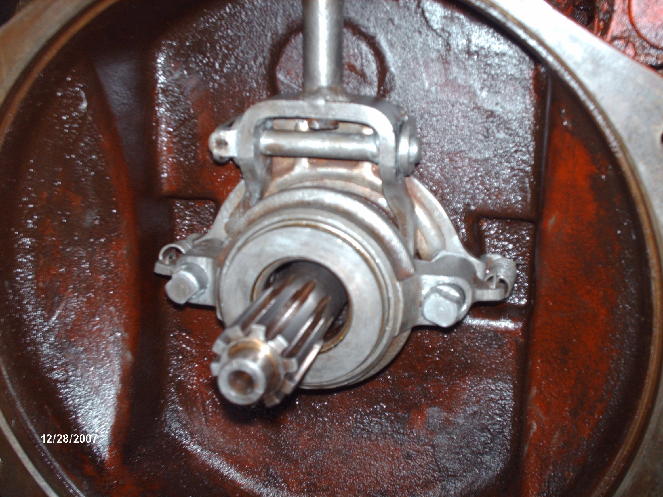

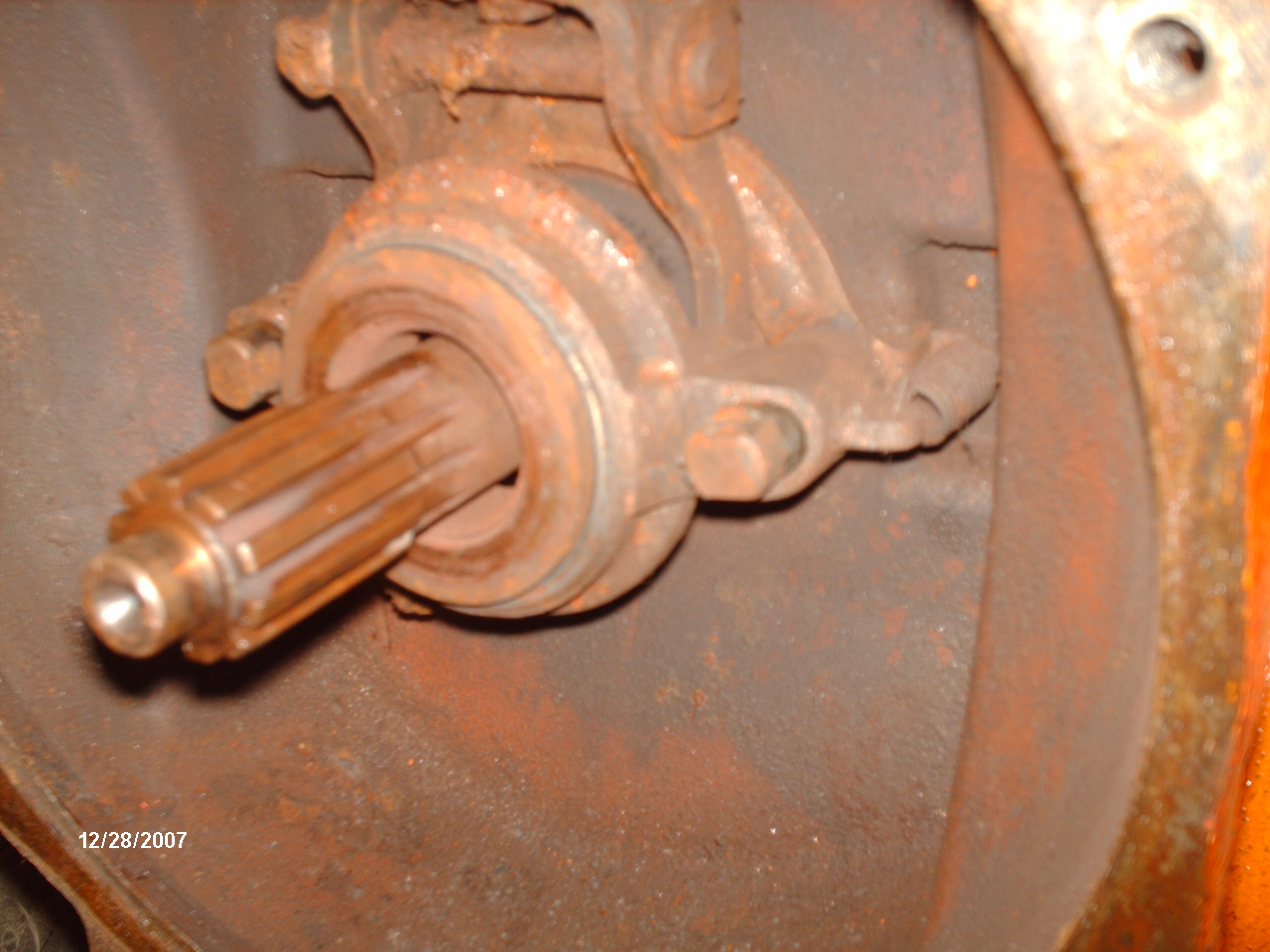

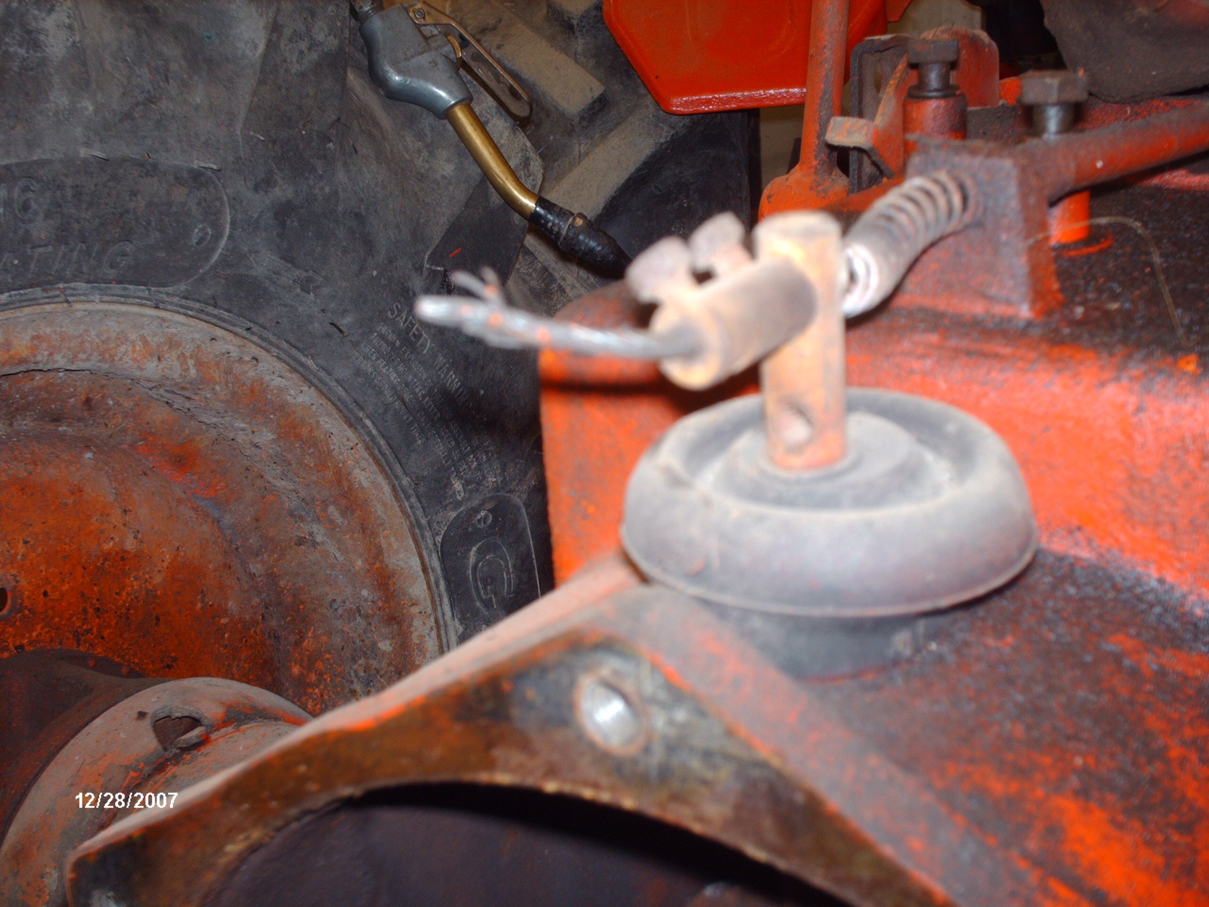

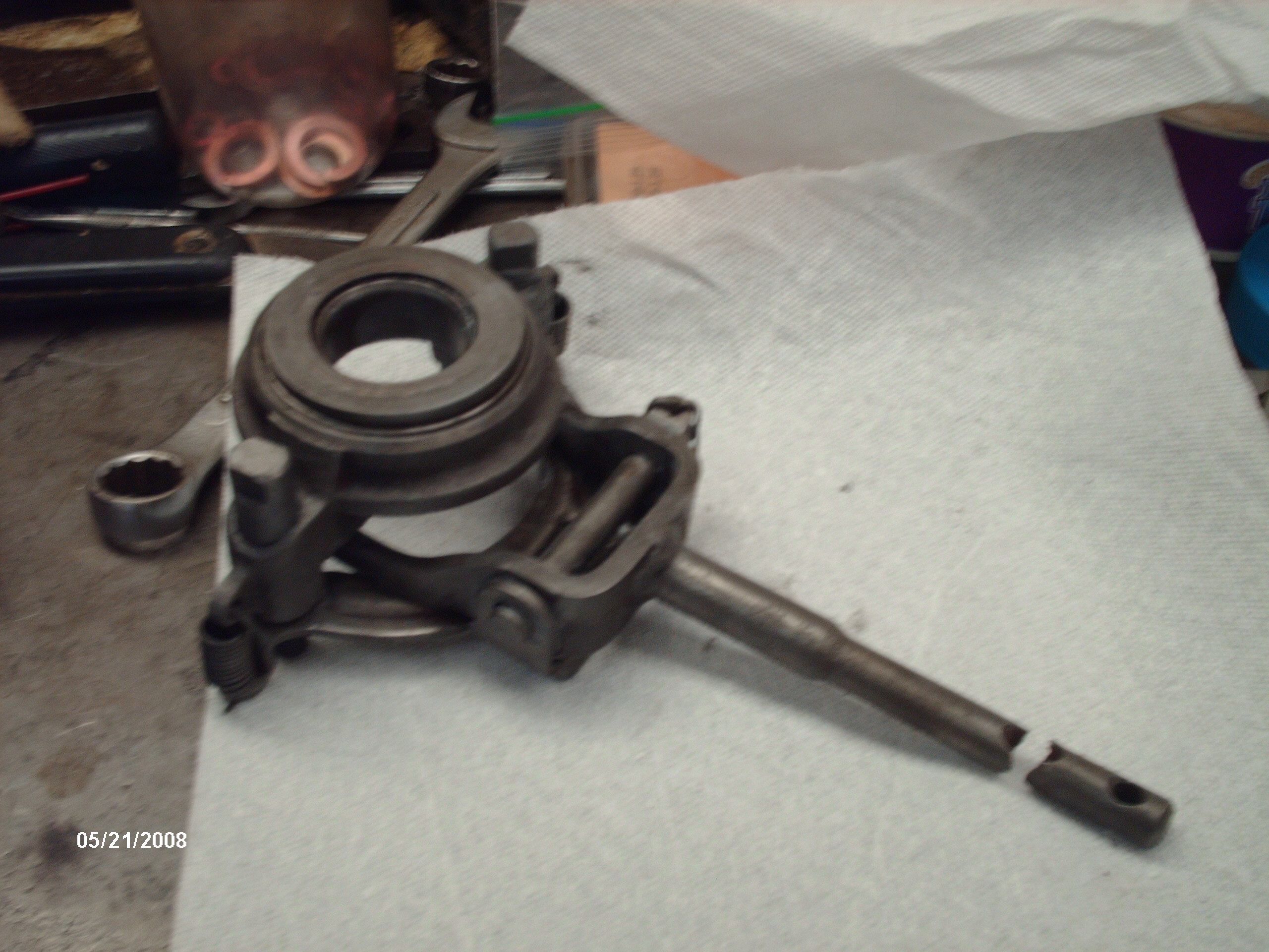

Here are a few of the clutch fork pics I took when I had my 997 apart a few years ago. I had to take it all apart again to repair the broken shaft...it is a very typical set up...
The shaft seal in the third pic can be replaced by a nipple from a calf feeding bottle - available at farm stores...according to Ray S. from CT.
Joe
