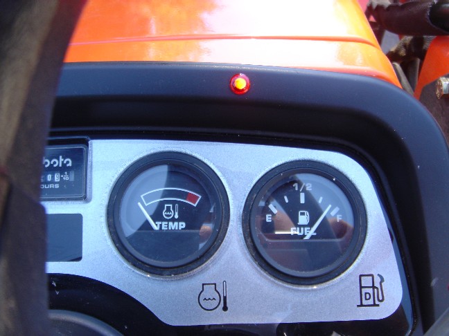

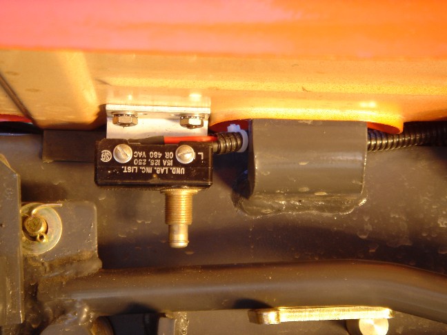

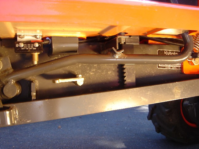

How about some up to date up dates on adding on a brake light on a tractor, I have a devil of time trying to remember the brake is on when set for pto winching, I know only one out of 5000 people have this issue......... I found these pics on old a BX thread, wondering if this just the old way, only way or is there a better way.........

My experience, even on tractors WITH a light it will never fail to drive with it on.
BUZZER works best.
I am in the habit of "stabbing the brake pedals" every time I get on the M , no light or buzzer on it either. Just a habit to to prevent driving.
Personally, I think unless you a driving with the brakes on for a LONG time, a "brief forgot" is no worse than using them to stop on the road from speed or steering use all day.

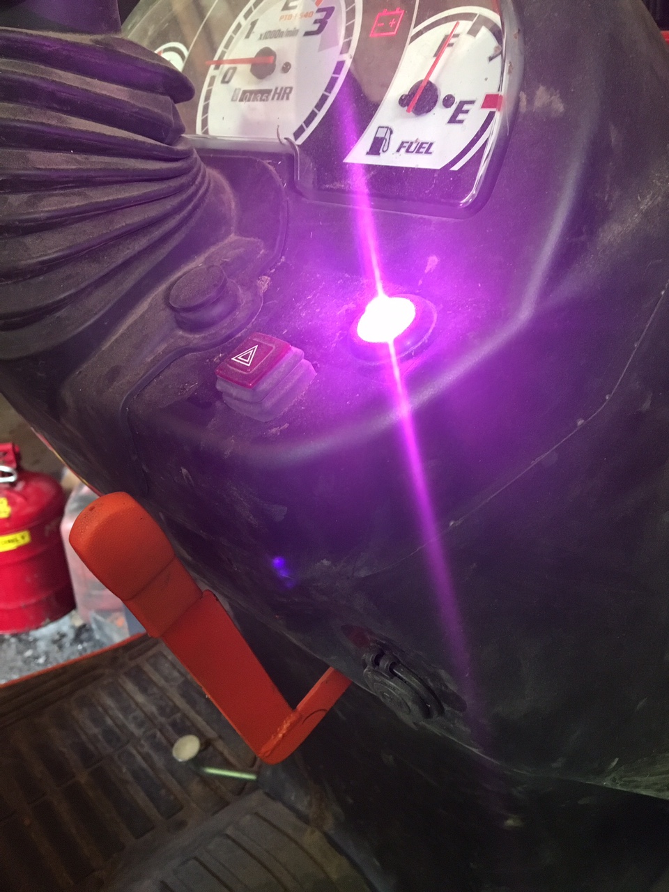

Added this parking brake “on” lamp on Kubota B26. Under the steering wheel boot was already a metal bracket with hole perfect for a universal motorcycle rear brake switch ($10). Had to drill a small hole for a spring in the brake handle to connect to the switch. While doing that added an extension up which helps with ergonomics and better secondary visual. LED rubber mounted marker lamp on the dash. Wife used and approved.
Do you have something like this>>>>> https://www.amazon.com/s?k=universal+motorcycle+rear+brake+switch&ref=nb_sb_noss
