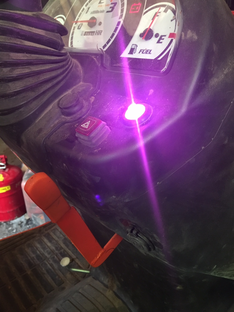

/ Parking Brake Alarm? #7
Did two things. Really bright led marker light and added a right angle extension handle to the level to have a better visual and ergonomic engagement. This tractors sees multiple operators and had problem with operating with the brake on. 100% fixed.
On eBay several flashing light and buzzer fixtures.
Buddy of mine so irritated wired his tractor to quit like a safety switch when his wife would try to move with the brake on.
