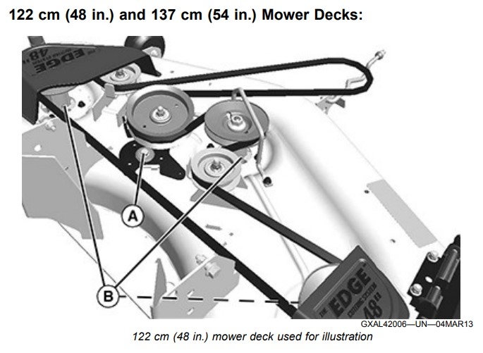

A multiple spindle mower deck belt pattern shows the middle spindle has much less belt to pulley contact than the outside spindle pulleys, making belt slip on the center one easy to understand.
Kinda got to disagree with you there.... At least on my two JD mowers....

That is a much better belt pattern than most multiple spindle decks.
Looks like my Husqvarna 54” deck belt routing.
