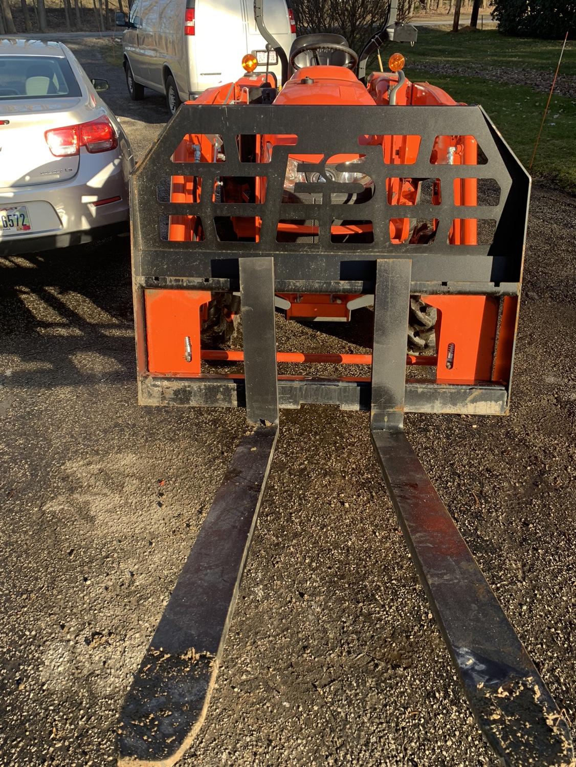

Looking for a set of pallet forks for my Kubota MX5800. I like my Everything Attachments grapple & landscape rake & am considering one of their pallet forks. What size (42" or 48") & capacity do y'all recommend for my tractor?
I bought the QD 48" 4000# and use them on my 25 and 65 HP tractors. Bought the longer ones for more surface contact on wide items. Very handy when you need such an implement.
