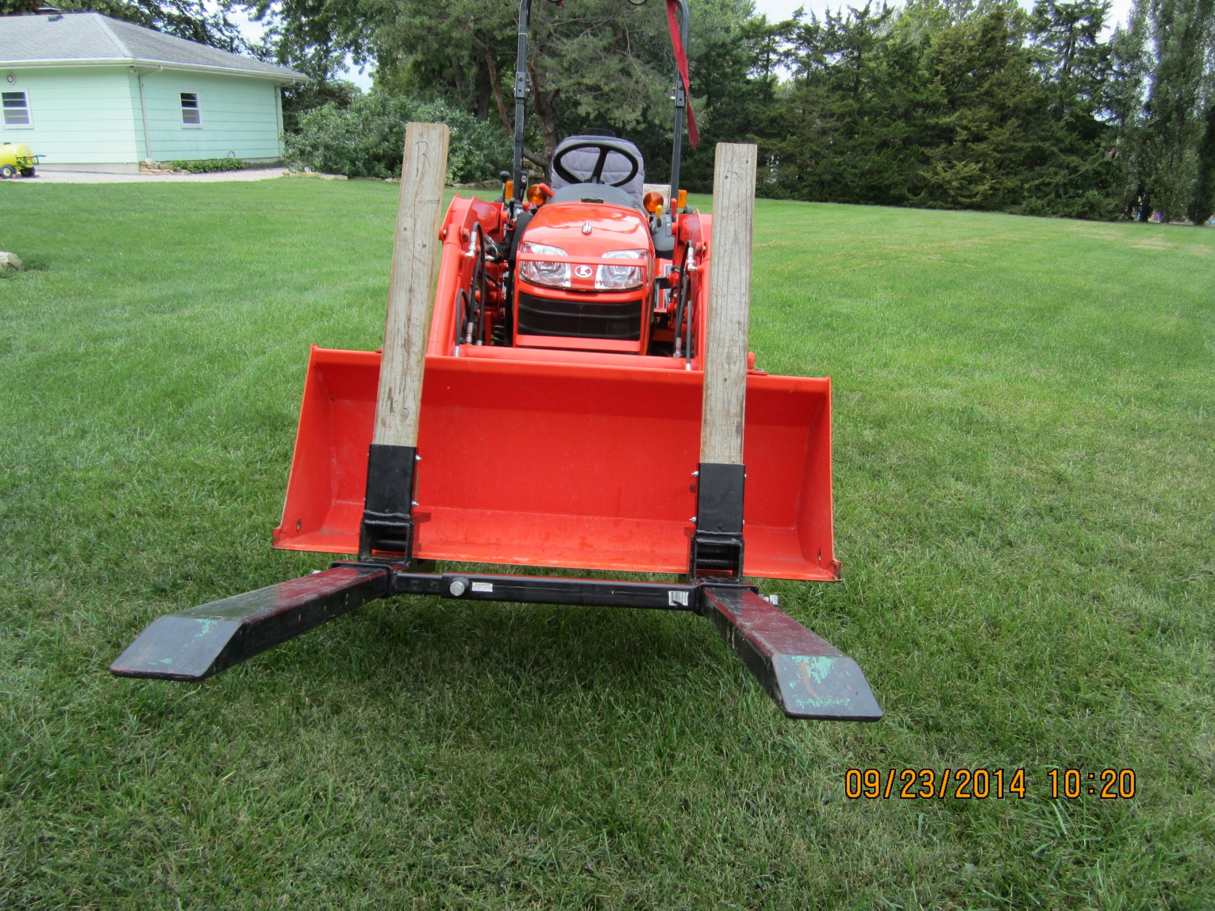

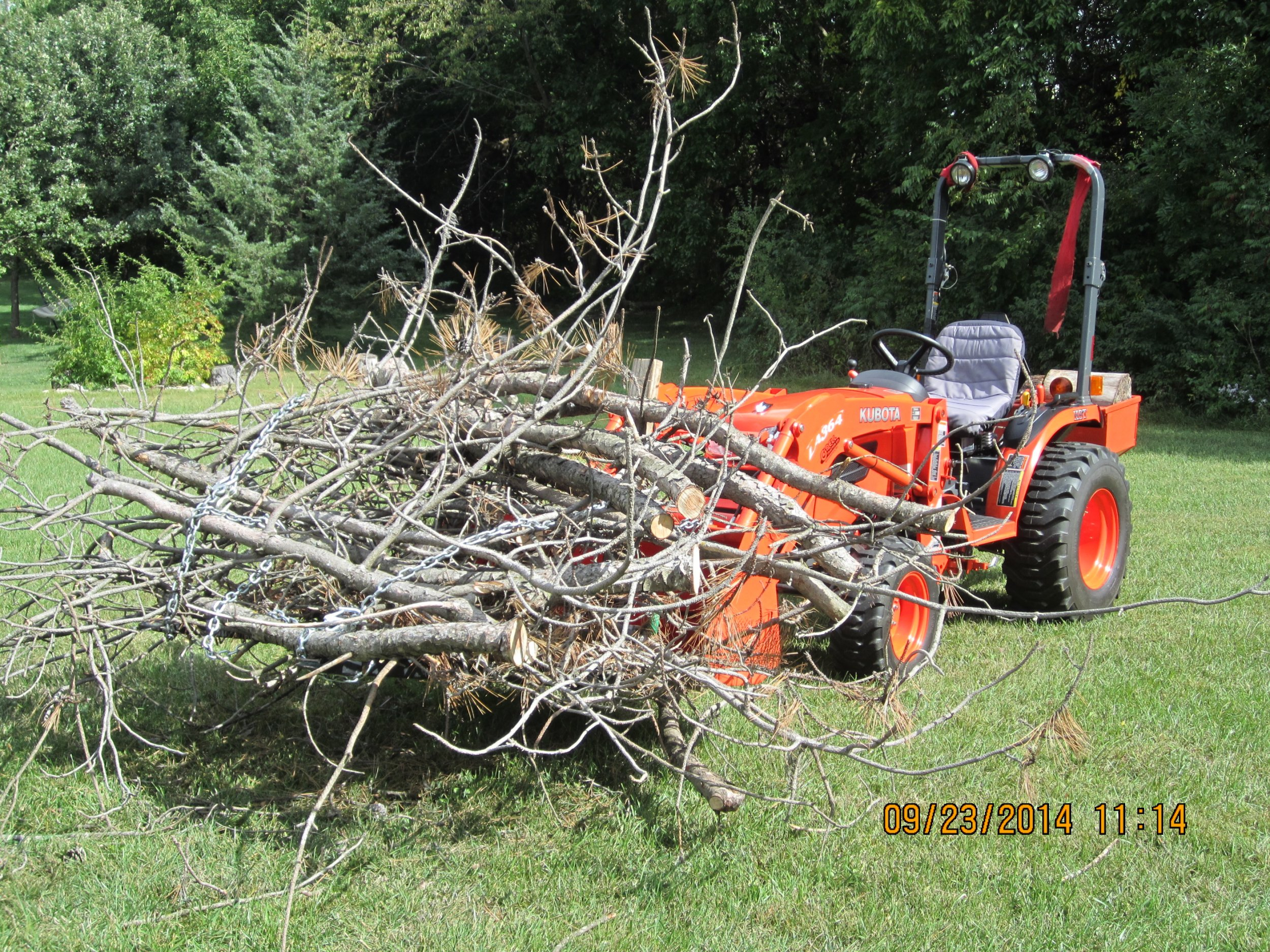

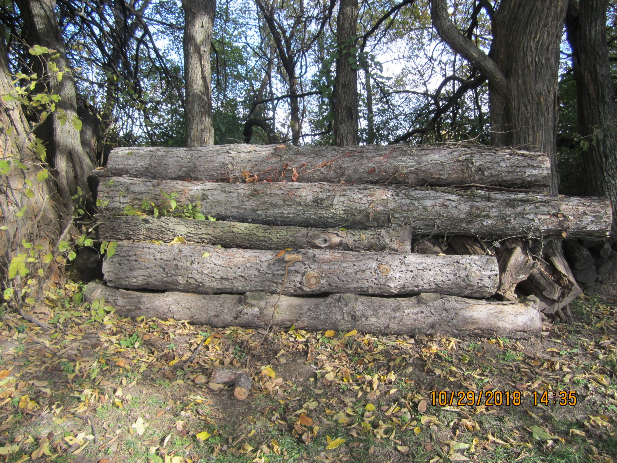

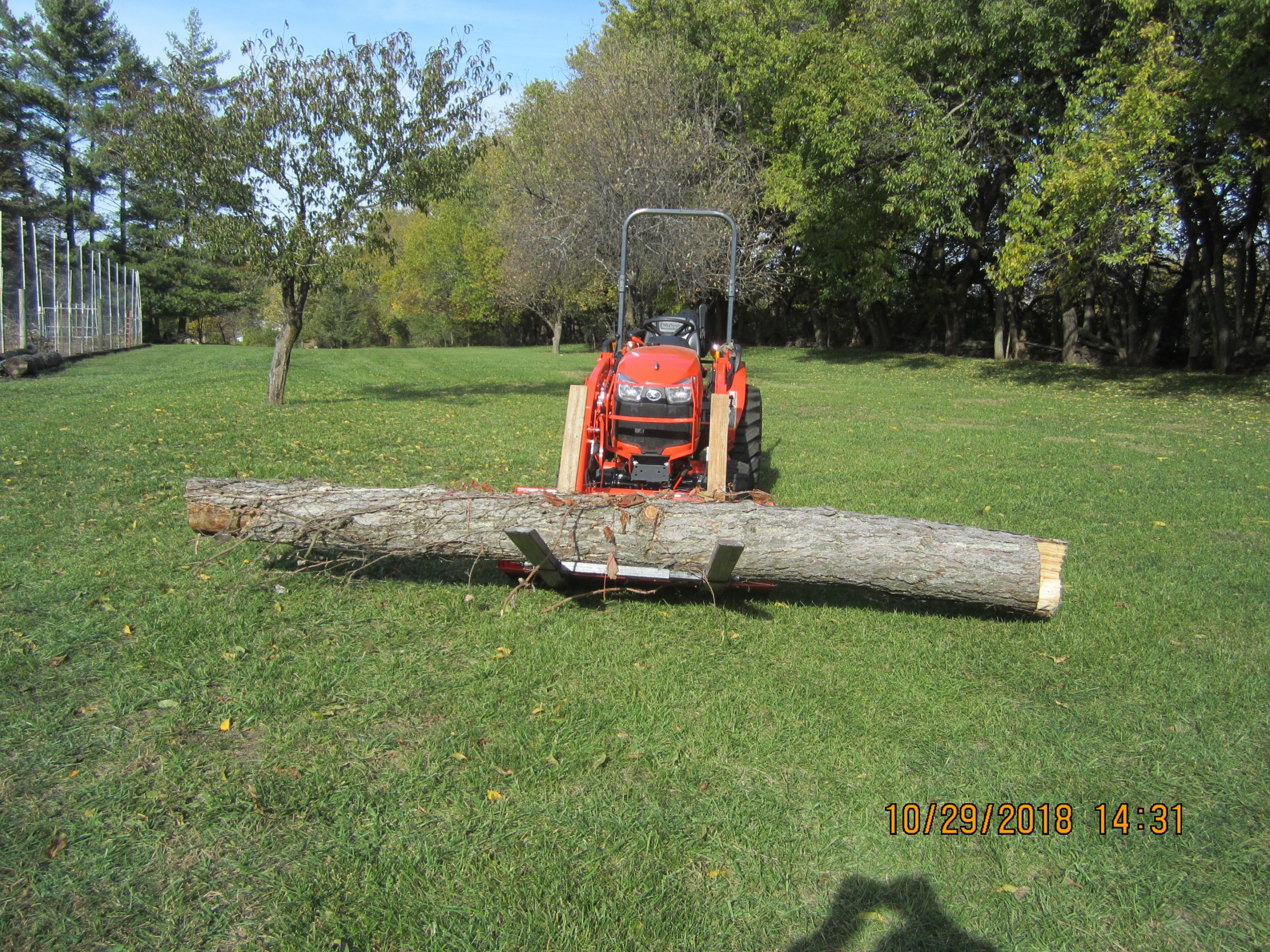

I have clamp on forks on three different Kubotas....BX2660, B2620 and B2650. They worked well on all three machines. They have served on moving large fallen pine logs....24 inch X 12 feet, on brush, on square hay bales, on moving old junk around etc.,...even some very large rocks.
The buckets were never damaged. The "Bucket Solutions" company were the manufacturer. I needed no chains for securing.
Cheers,
Mike
