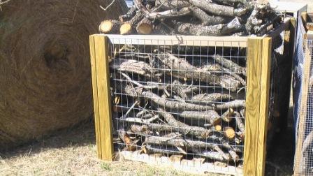

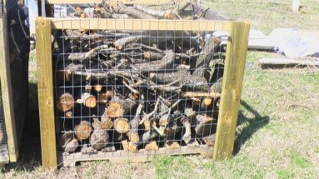

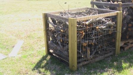

I forgot one thing, what type of corner pieces did you use? pressure treated? How did you attach them to the skid and themselves?
Thanks
Good afternoon, Bob --
Yes, they were pressure treated and nailed to each other and then nailed to the pallet. The pallets were 48 x 40. The wire in the fencing, I don't know the exact size but you cna probably look at Tractor Supply's site and it will tell you. It is probably a 1/16" in diameter or slightly larger and it was attached to the wood at all points with 1/2" narrow air staples . . .
