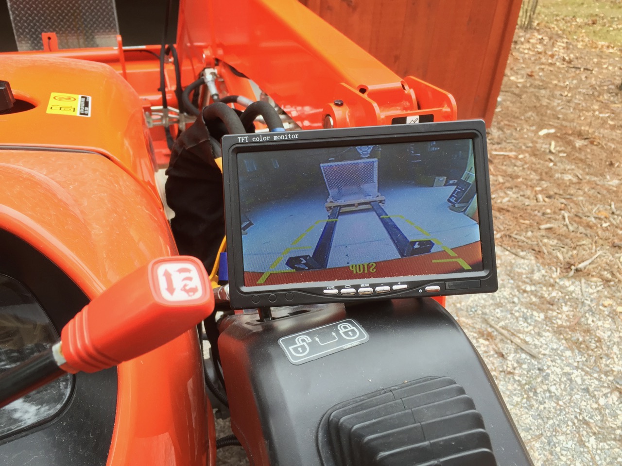

Some great suggestions here, guys - thanks.
The camera approach sounds like the most effective although I may end up combining a couple of the other suggestions along with that.
How do the camera and monitor get power - or are they battery powered?

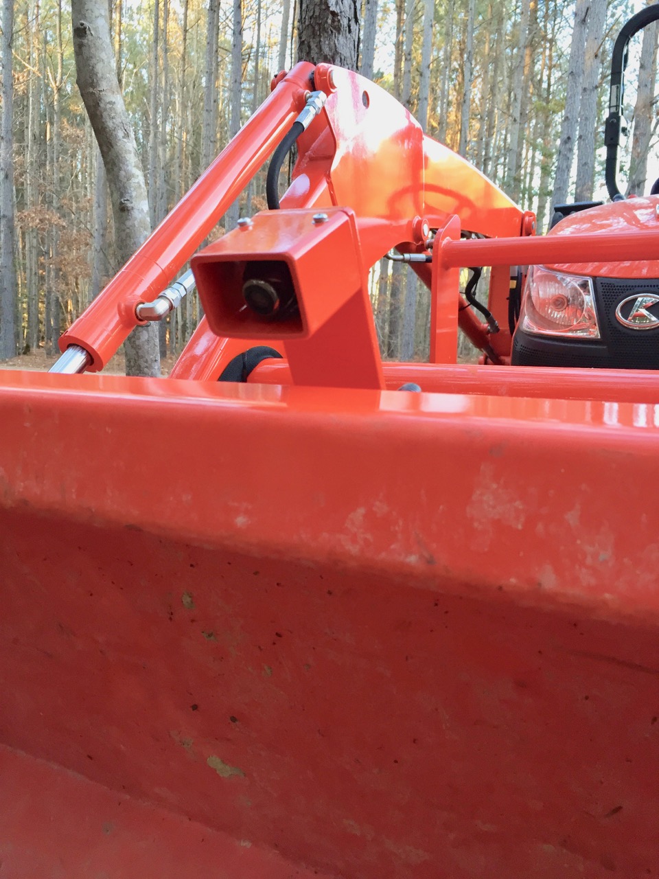

Generally they want 12 VDC from the tractor but they draw minuscule amperage.
Since I did not trust the built in power switch I left it in the 'ON' position and added a simple toggle switch.
My installation has seen 2 winters and operates just as well as the day I installed it. While the specs were not clear mine has not failed even to -30 deg colds.
When blowing snow I did find it kinda odd that the camera reflected yellow snow from reflections from my beacon strobe light.
