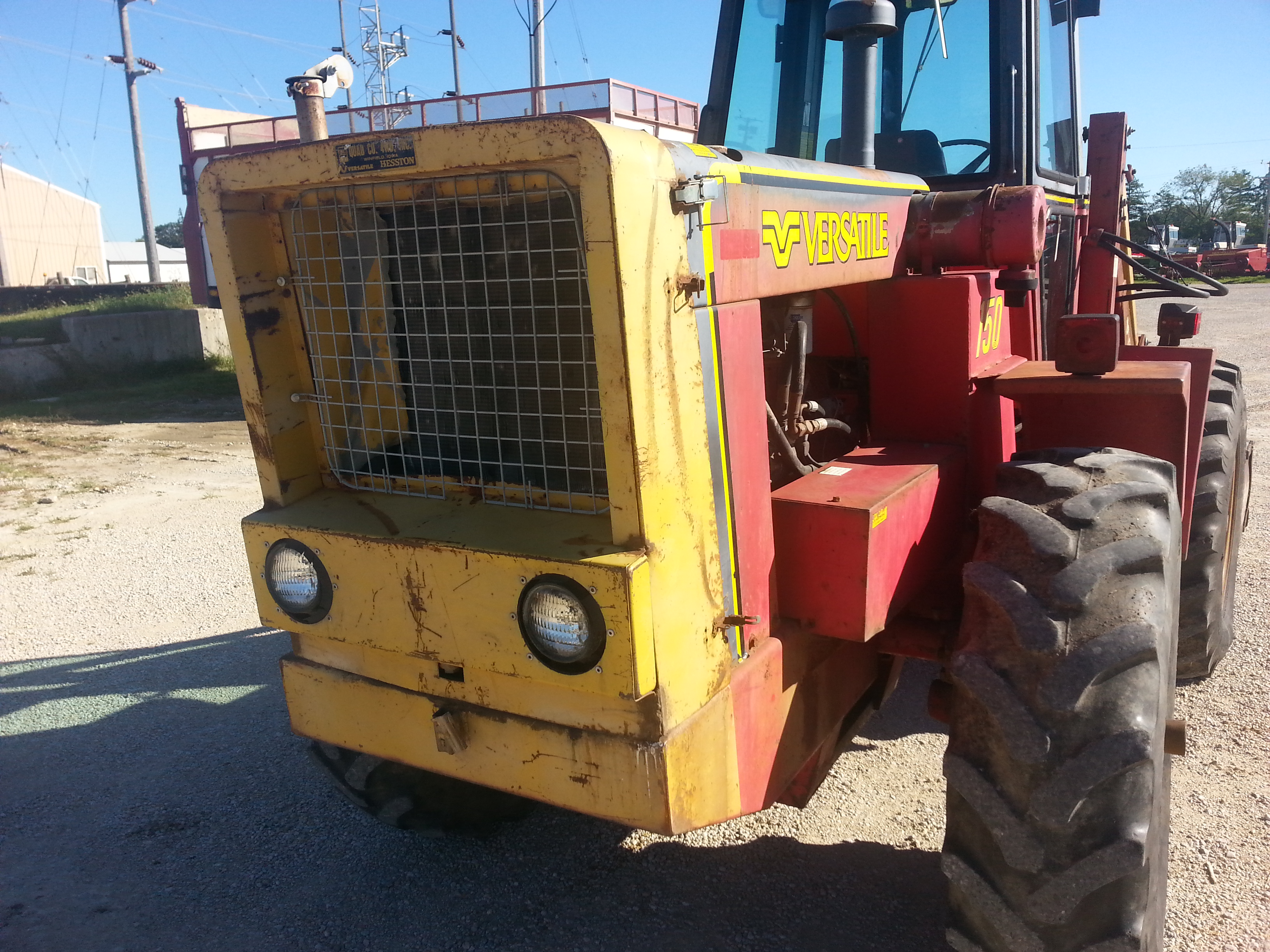

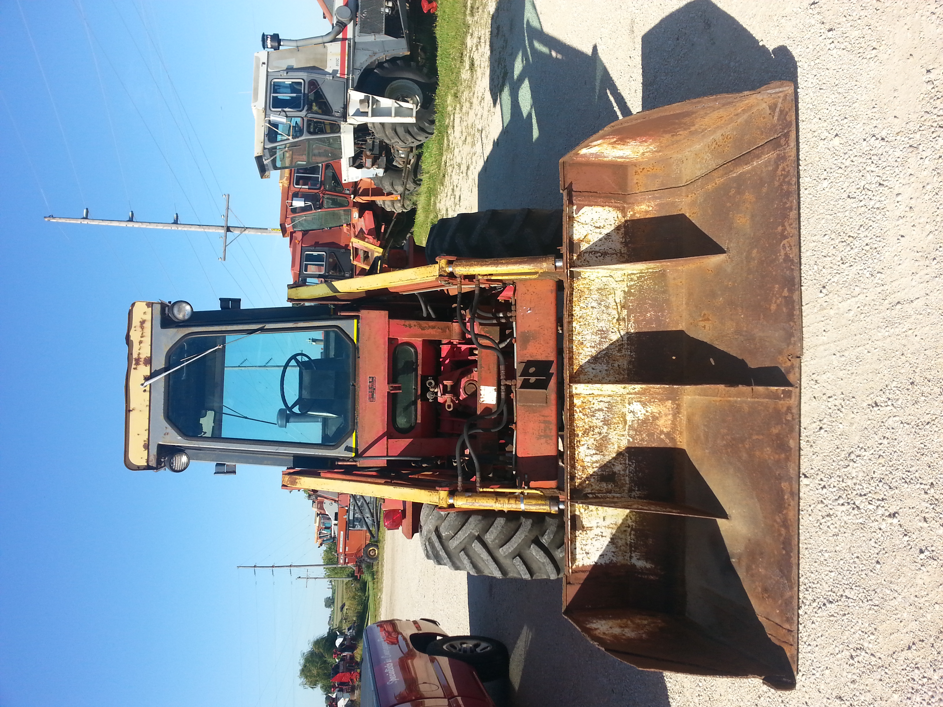

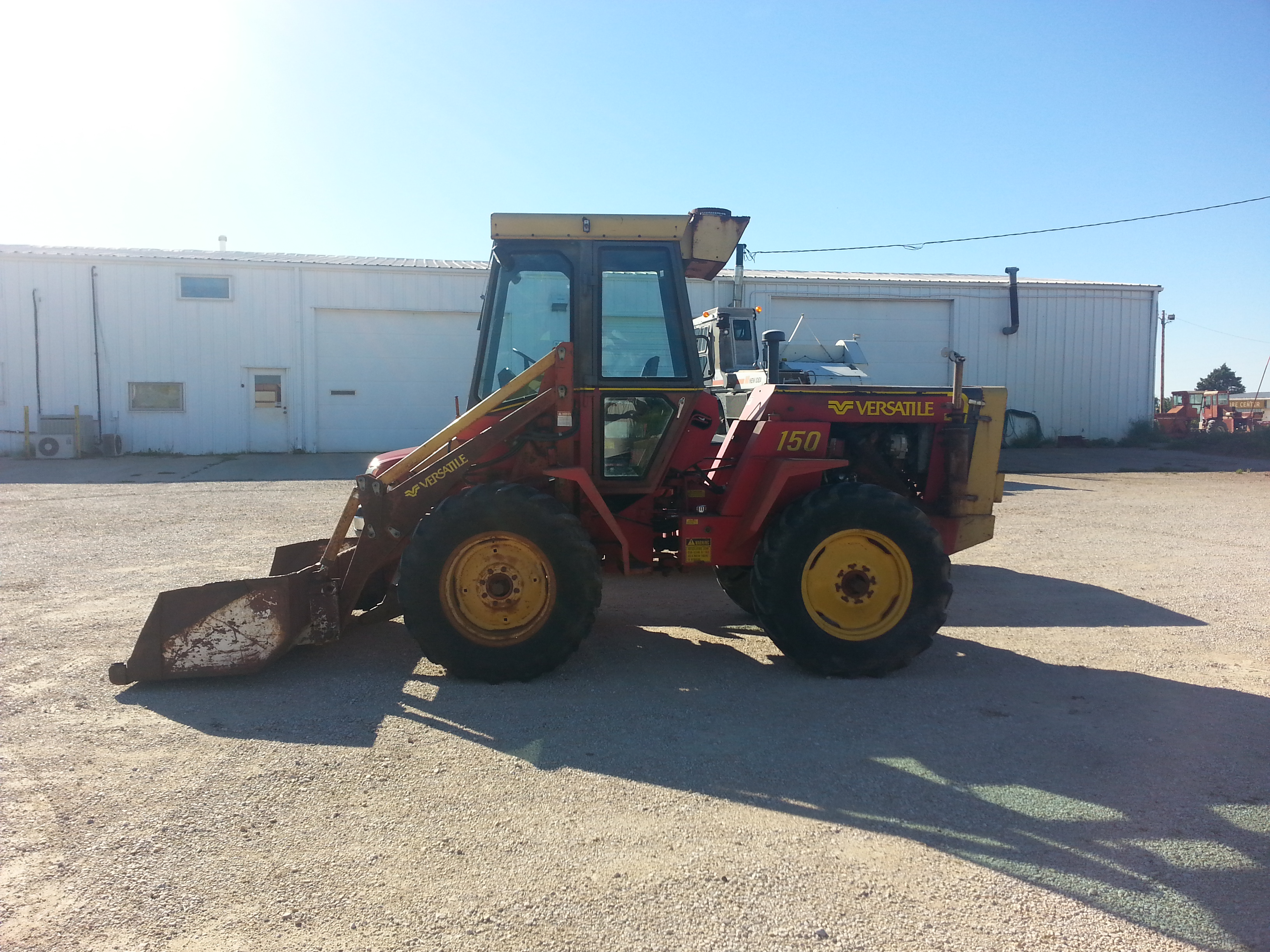

With my Versatile 150 I can see the front edge of the scoop or the forks or whatever else I have on. It is not a problem.

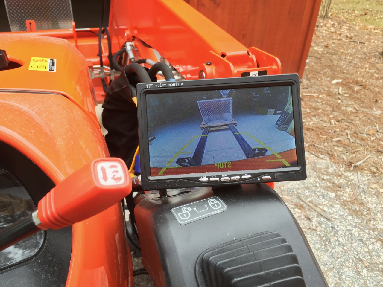

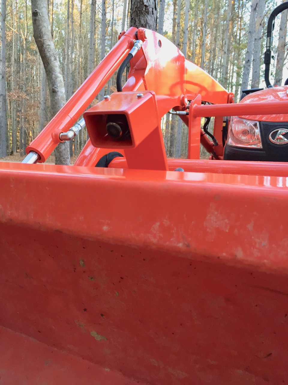

I welded up a camera frame/housing that magnets to the back of my bucket. Makes it real easy to aim my clamp-on forks.

That is brilliant.
Cameras are a wonderful thing in the right situation. They can take some unbearable task and make it bearable and even pleasant.
Yeah, and it's amazing you can get this stuff so cheap now. I think I spent about $25 for the screen and $10-12 for each camera (also have one on the ROPS aiming rearward). Even if I break something it will be cheap enough to replace.
