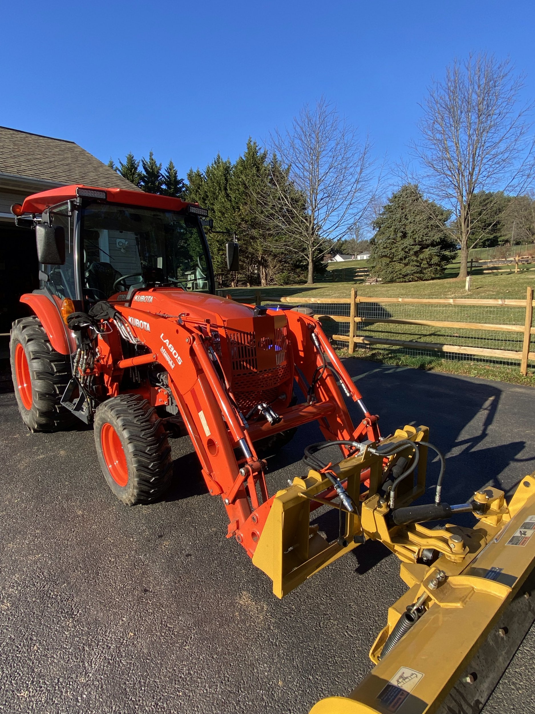

I have 42" forks that I can't see well. For this plowing season I installed front and rear cameras which will make seeing the forks easy - just haven't tried them with camera yet.
Rj,
Not to derail the thread, but who's front blade attachment is that on your loader?
Link if you have one?
