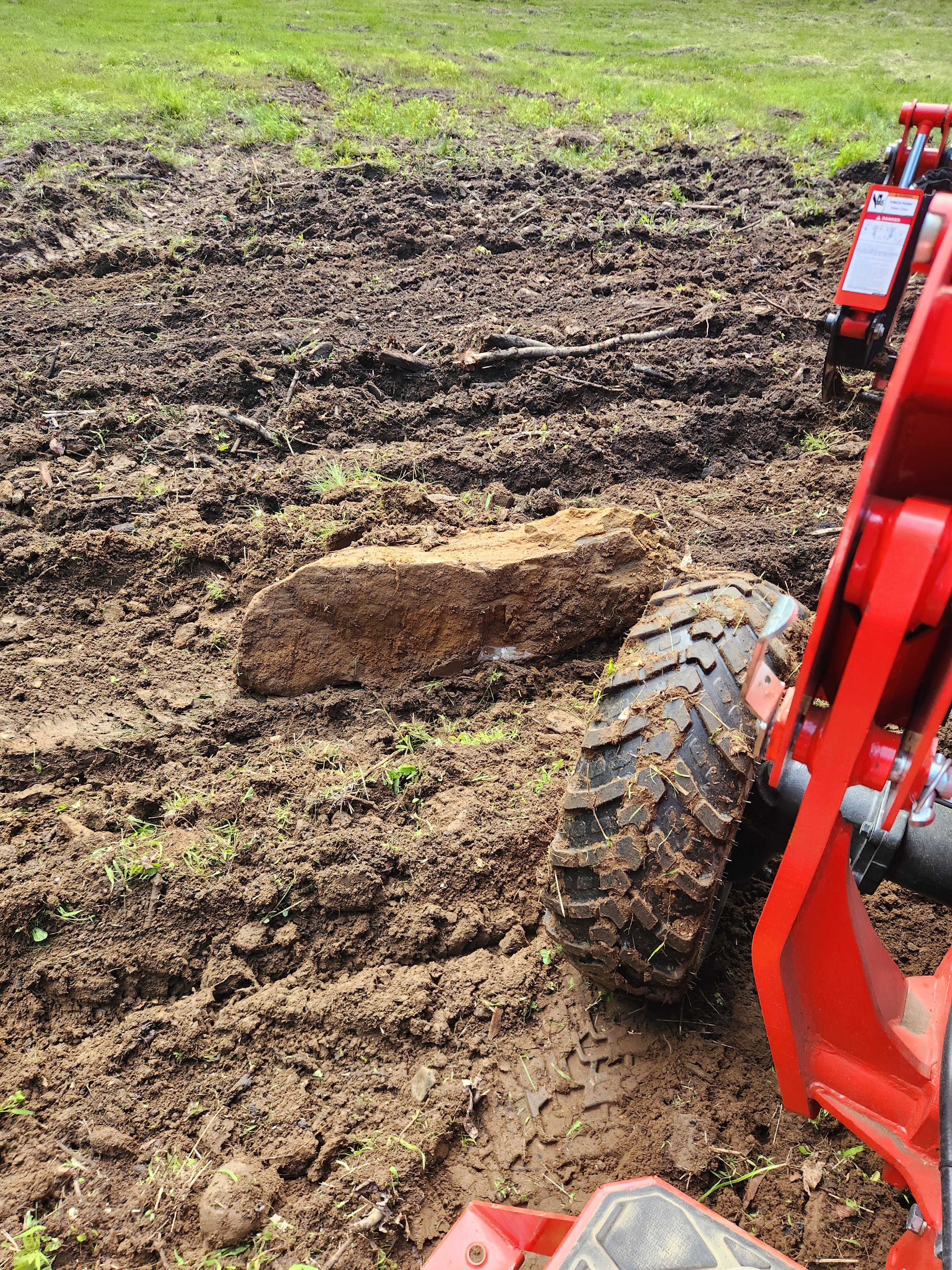

In the farming days I hit innumerable rocks over the years.
2 standout.
I was v-plowing in the orchard.
Not deep, maybe 8-10".
That ground had been worked for a 100 years or more and most recently when we put the peach orchard in.
How did this monster hide so close to the surface for so long?
I was zipping along in 1st high, kinda bored, then I was almost on the hood of the tractor.
The v-plow caught the rock, got bent all out of shape and almost stalled the Massey.
How it didn't break the lift arms off the tractor?
Similar in another orchard block I was preparing for planting.
Ploughing up aboot 10 acres, boredom sets in.
The rock was shaped like the old rubber erasers we had in school.
Aboot 2' wide, 5' long and 18" thick.
It was sitting at around a 30 degree angle long way down a foot or so underground.
The plow went under the high end and again stopped the tractor instantly with me over the steering wheel almost losing teeth on the hood.
I give Massey every credit for building a tough rear end.
This rock took the neighbors backhoe to dig out.
Again! Where and how do these rocks hide out for so long and then one day just show up?
Not just the fist sized ones but the big SOBs.
Then where does driveway gravel go?
a few plausible reason,
1-frost pushed them up
2-previous plow didn't plow as deep
3- during previous plowing you lost top soil (wind + water eroded it)

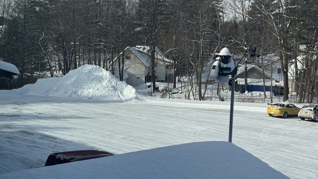

The snow pile at one end of our lot is getting up there. The other end has a 20' drop-off, so that stays pretty small.
No, I don't do that with my little B, we hire it out to a company that uses a snow pusher on a full-sized loader.
