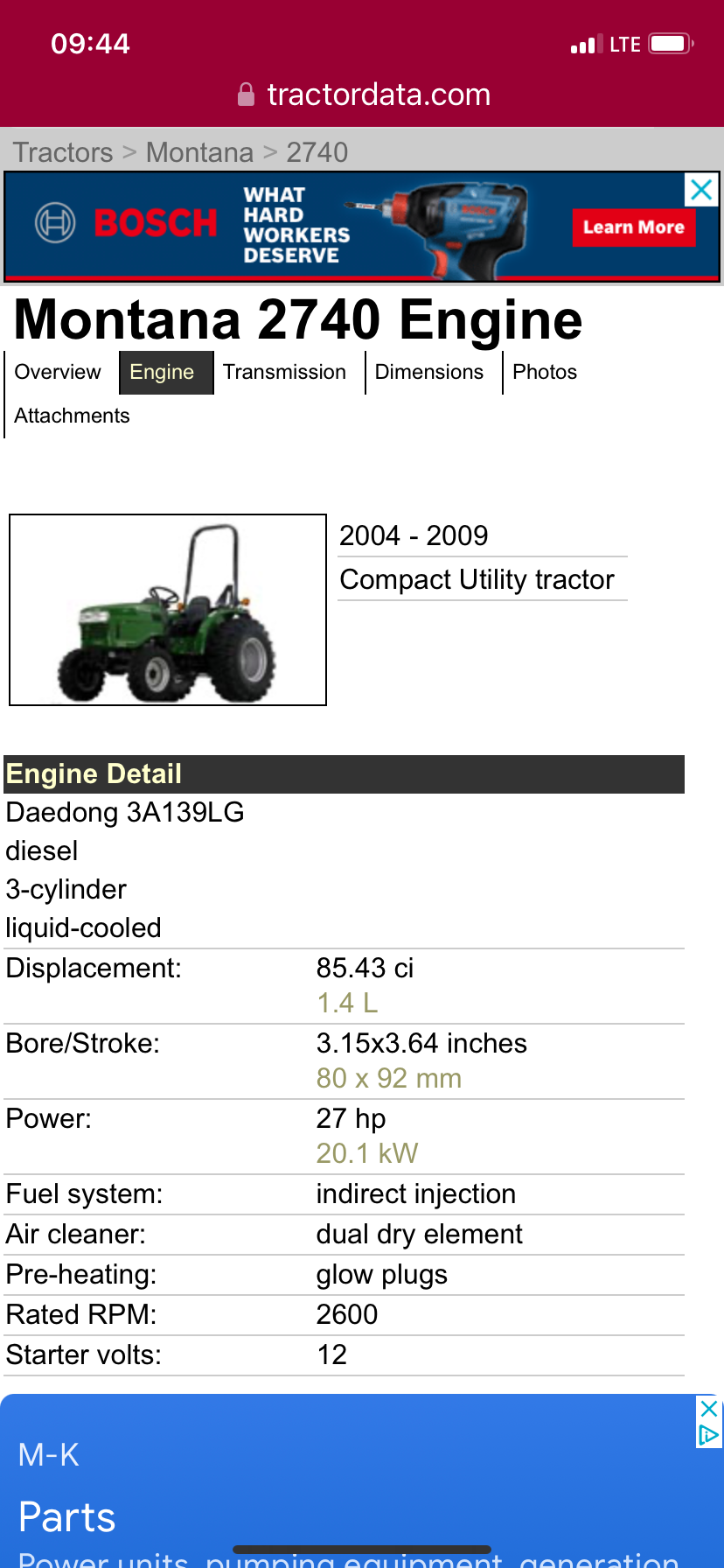

/ Owner's Manual 2740 #4
If this is the engine in your tractor….it shouldn’t require any spark plugs…😉
