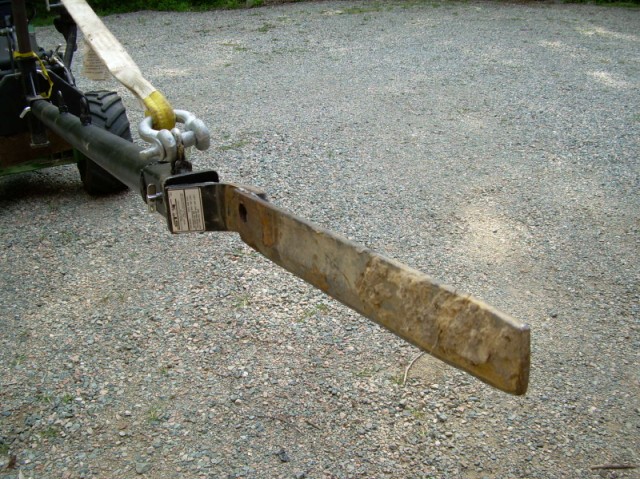

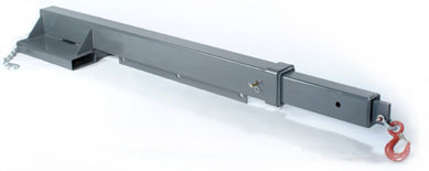

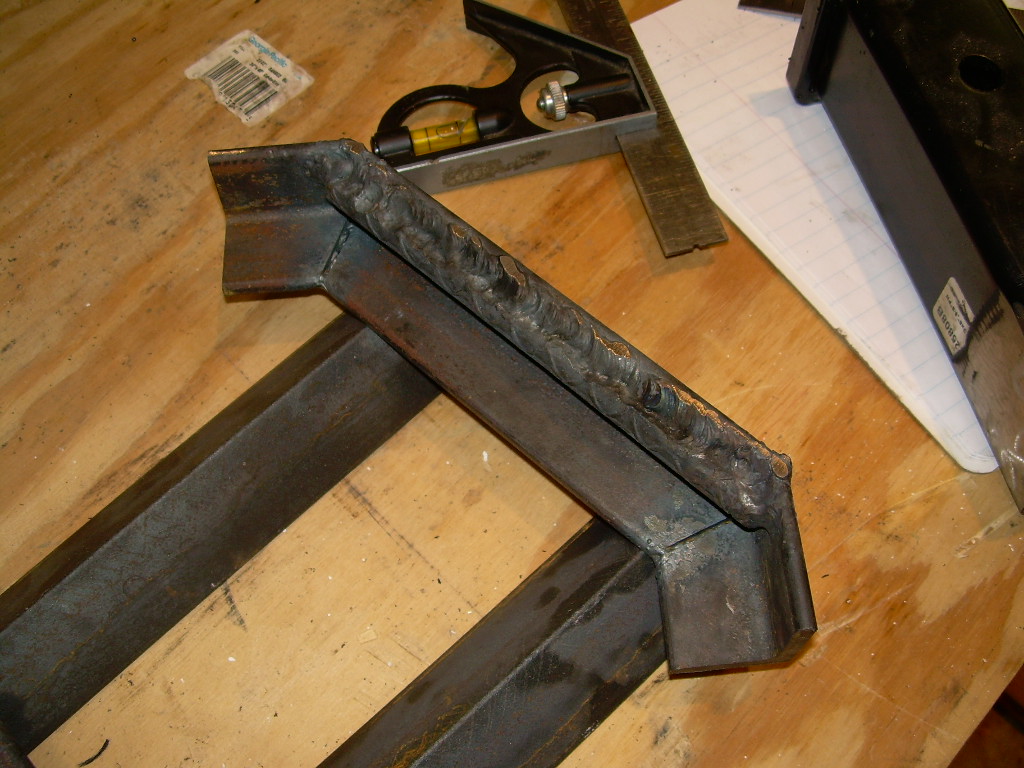

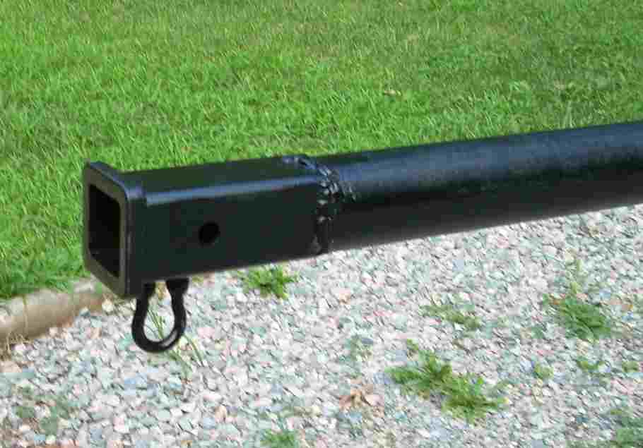

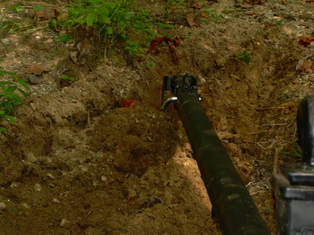

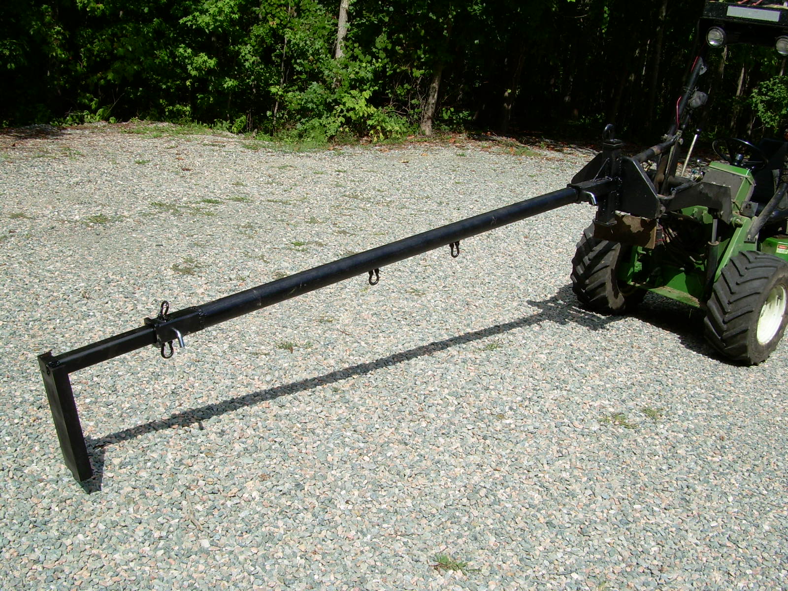

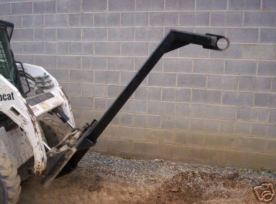

Thanks, but I was asking about the boom pole itself. ;)
Oh! It's just a 2 3/4 inch pipe, 1/4 inch wall thickness with a 2 inch receiver tube at each end (one male and one female). I welded chain links or something every so often to give it intermediate connection that I can hook a chain hook to. This way you can lift heavier items if being close is OK. The female 2 inch receiver allow me to plug other things into it. See attached pictures.
I also made a shorter boom pole about 4 feet long. I use this most. I can also put them in series, but it is very hard to control at this distance.

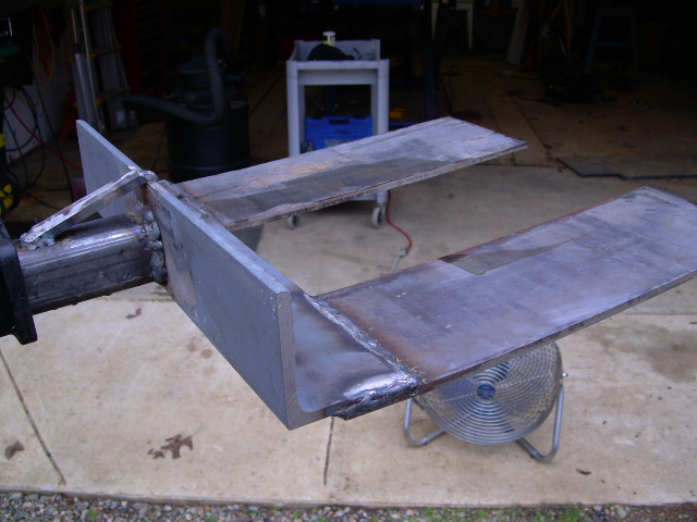

I have also made a minifork lift that I use for stiring up a burn pile. This way I don't have to get too close to the burn pile.

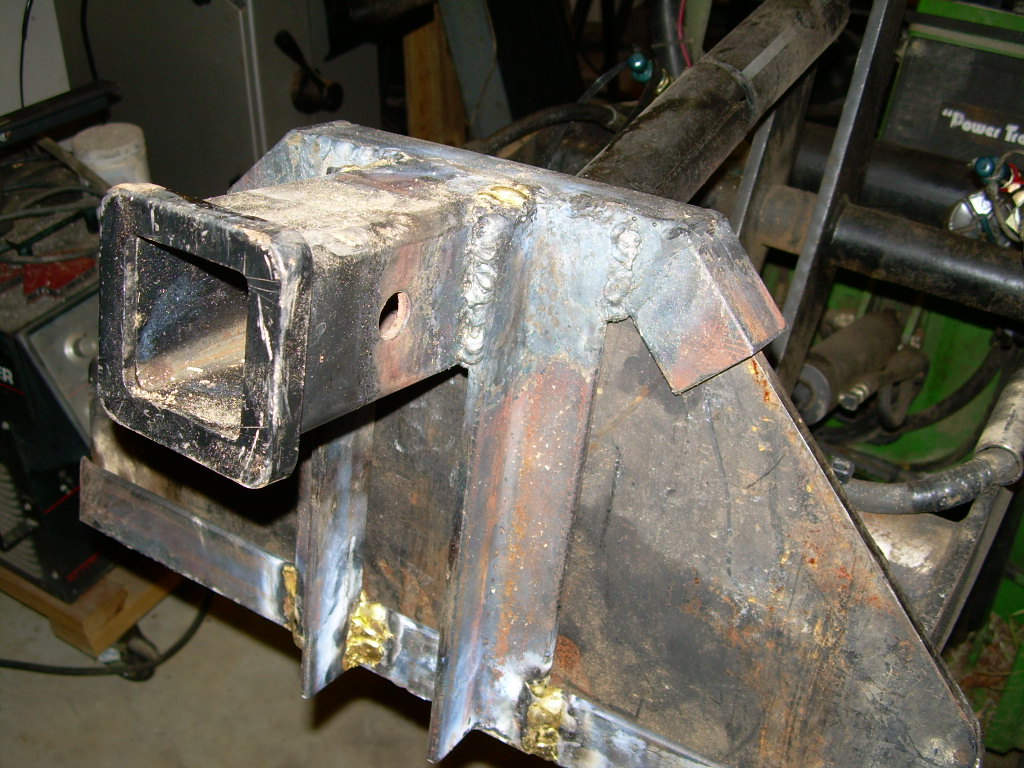

Thanks, Bob. It was the plug-in pole itself that intrigued me. I already have an adapter plate with a receiver. The receiver is welded to the plate longitudinally, instead of butt on, so it should be strong enough without any gusseting.

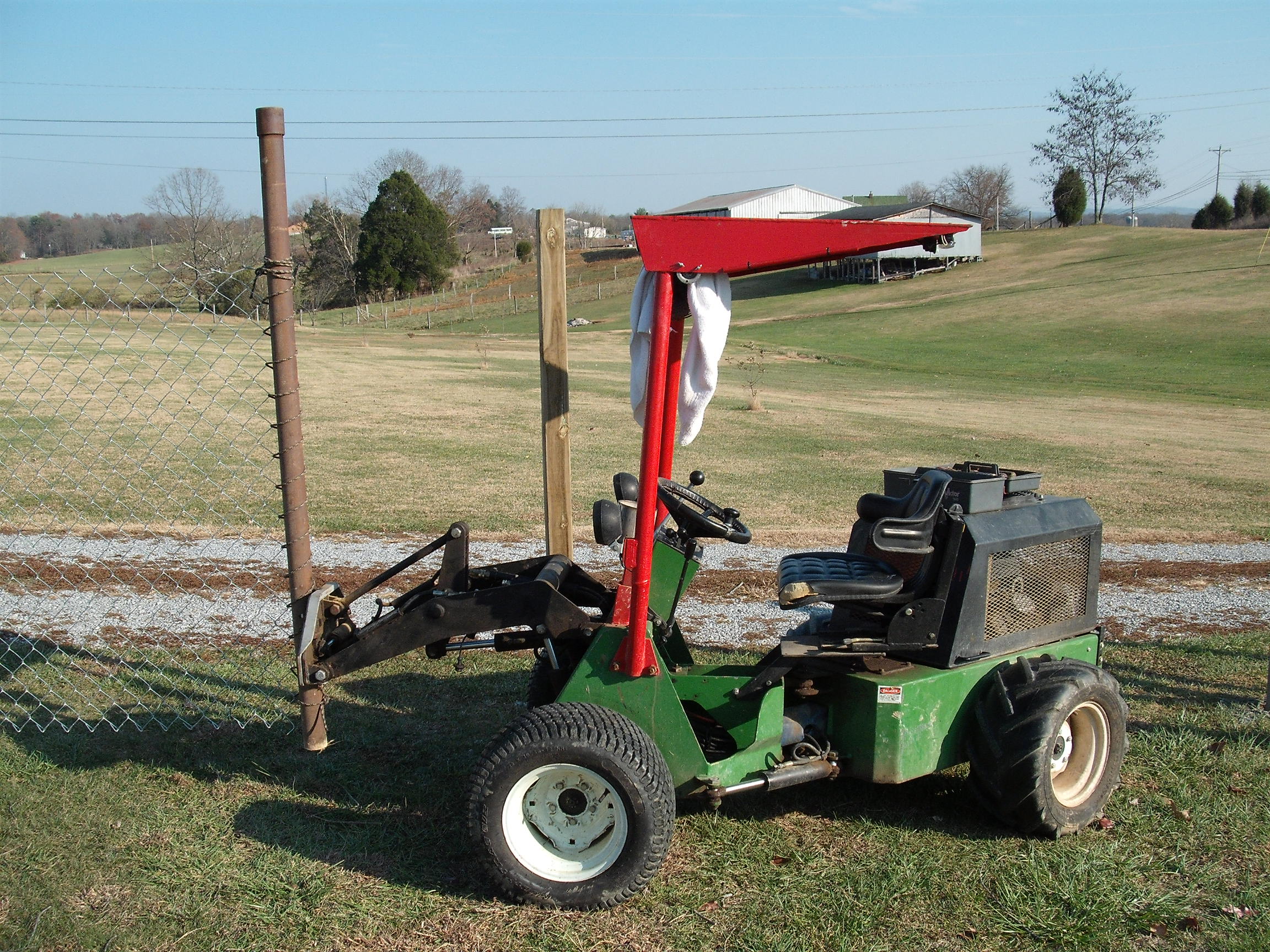

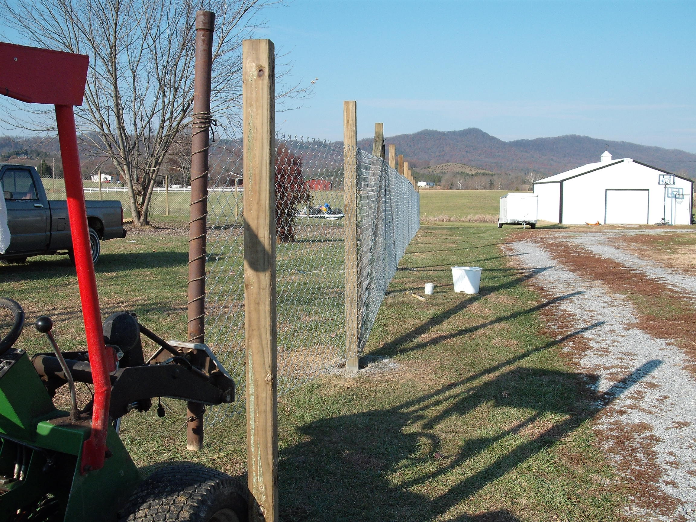

Here is a pic of fence stretcher I built for a job I am now in the process of doing. It works pretty well. You are able to tilt or lift the fence as to stretch and place it just right.

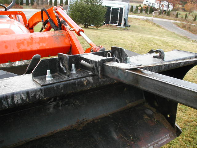

Here is another 2 inch receiver with my light duty homemade quick attach plate. I also added this quick attach plate to my gas welder tank rack. So I now have a welder as an attachment.
