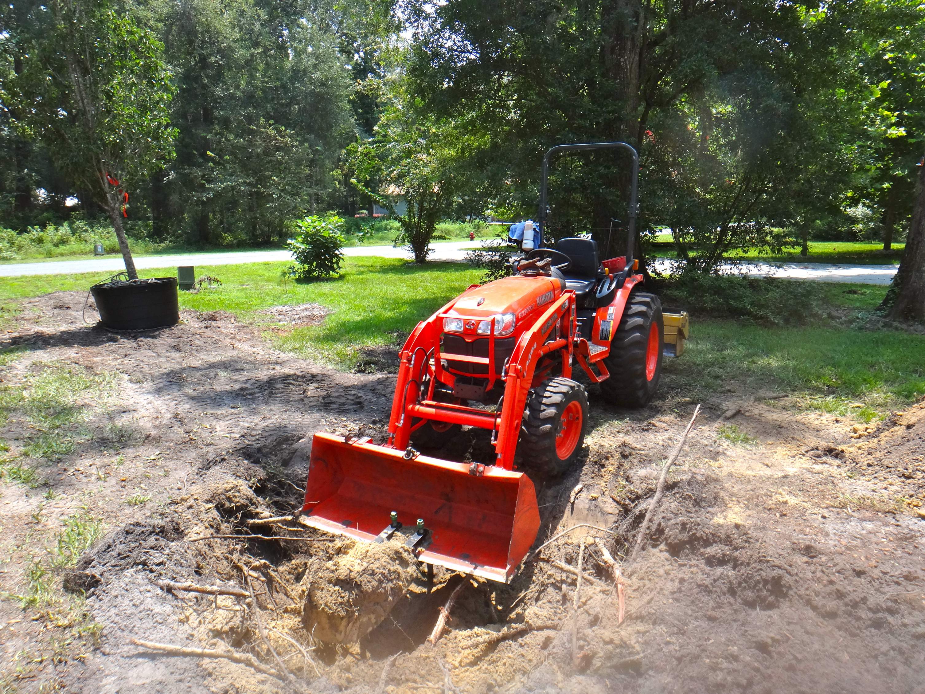

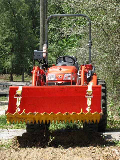

40-hp minimum (50-hp better) and minimum 4,000 lbs. tractor weight before FEL. 4-WD for certain.
With 4,000 lbs. tractor you will be able to pull seven foot implements.
You will need a Disc Harrow with at least 24" diameter pans in order to chop stubble and till in one pass.
It is rare to see a Flail Mower on a farm. Rotary Cutters (Bush Hogs) do the same work and are much less complex.
You can transport firewood in the FEL bucket.
I recommend budgeting for a Utility Vehicle and all terrain trailer to partner with your tractor.
Consider if a <$400 Bucket Spade will meet your initial needs, rather than a $8,000 Backhoe.
A $400 Ratchet Rake is useful for trail creation and light grading.
Keep an open mind on HST transmissions. Max torque when starting with an implement is a great thing.
There is a lot of used equipment out there. Good luck.

Inure yourself to forever picking rocks larger than 4". Bucket attachment called a Ratchet Rake is good at leveraging out semi-buried rocks.
