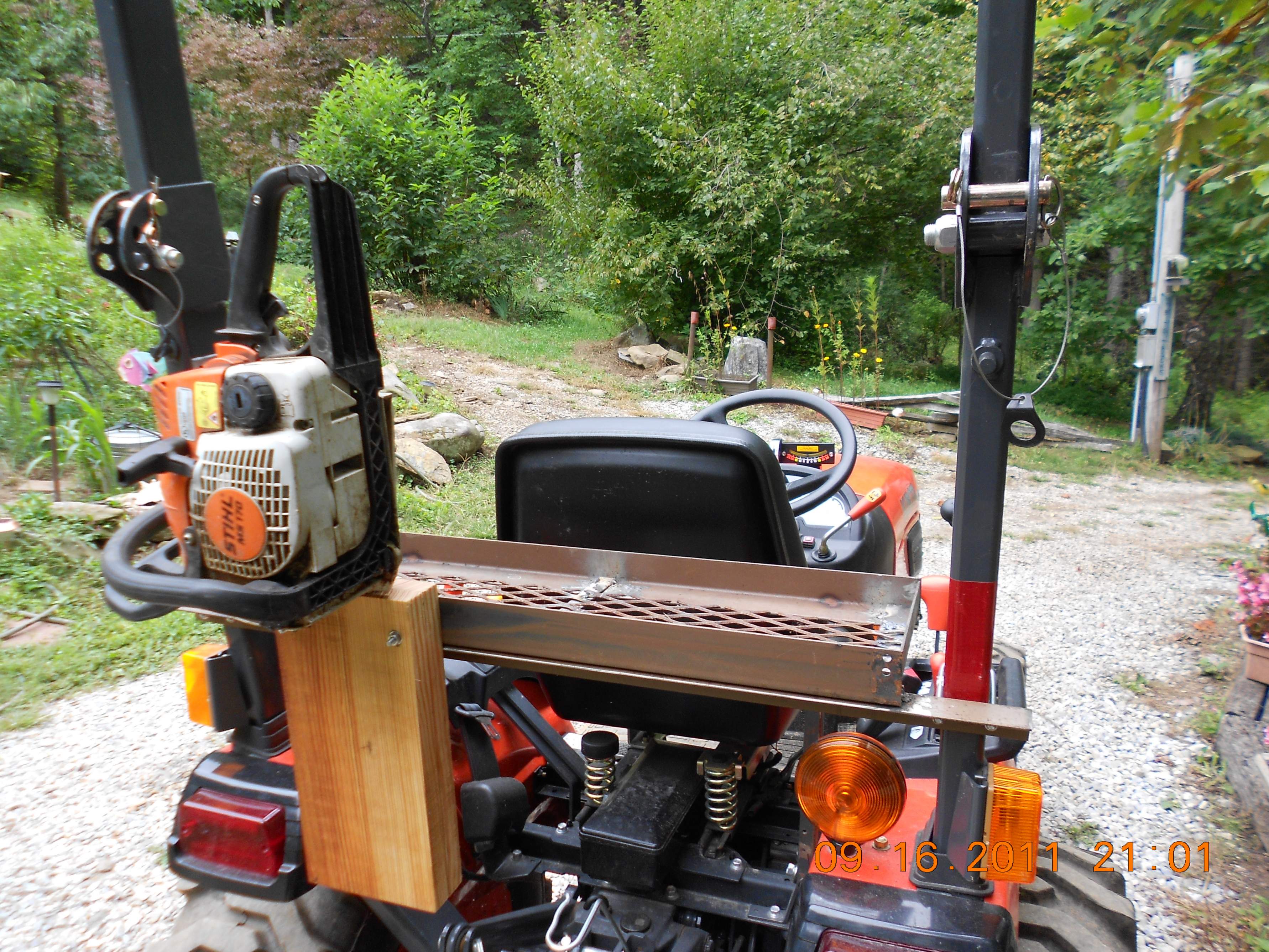

Well here is mine--just finished---well kinda----still needs paint soon as I see if the welds hold ( I'm no welder :D ). I just kinda threw it together with whatever I had around here.
Thanks for you idea (post) Dave :thumbsup:

Hi Dave,
Could you post more pics of your mount showing how you attached to your ROPS?
I'm not wanting to hole myine, but would like a bigger and better tool box onto it.
Thanks in advance,
Thomas
   / Overkill Industries toolbox and chainsaw holder #13
Hey PhysAssist ------Don't know how your puta works but on mine if I click on the attachment ( photo)----The image will appear--If ya mouse over it a mag glass with a '+' in it shows-- Left click with mouse and the photo should enlarge ------now move the slide bar ( at bottom ) all the way to the right-----just above the side light you should see a 'U' bolt/clamp on the rops. Like you I did not want to drill/weld the rops.
If ya look behind the round light you can see a a angle iron uprite that holds the rear of the tool box holder up ( holes in the fender were already there.
If this post does not work for you then I will take some new photos. One draw back to this carrier is when ya have a tol box in it it is hard to see what the box blade is doing
Gunner ( Skip )

Mine is clamped on. If you look in the 3rd pic under the tool box, you see a long bolt. I bolt through the toolbox tray and clamp with a piece of rectangular tubing below the crossbar of the ROPS. I basically made my own Ubolt with 2 bolts and a short piece of the rect tube. One on each end. Don't really have any better pics, but it is pretty simple.
