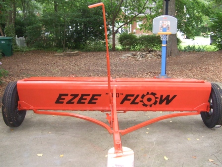

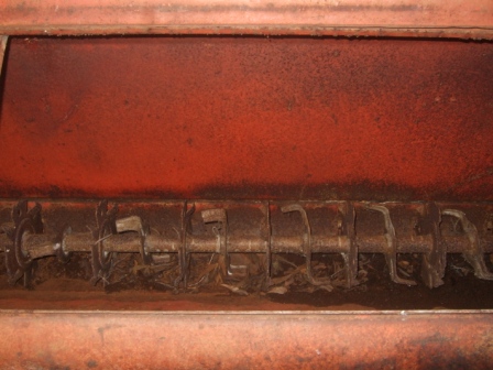

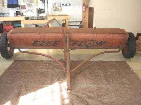

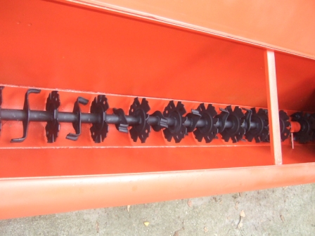

A few months ago I asked a question about an EZEE Flow spreader I was going to overhaul. For those interested, this is how it turned out. A little weld, a little sheet metal, a rookie paint job, and a couple new tires. Field Ready!

Did you repaint the lettering by hand?
It looks really clear and sharp

Does your have agitator disconnects on the hubs, and if so, are they complex?
If it is like mine the agitator shaft will have a couple collars with set screws to adjust the float for alignment inside the spreader. The drive hub is a light press fit onto the agitator shaft with a woodruff key and drive pin to engage the wheel.
Did you repalace any bearings?
No Just a couple of bushings. No roller or ball bearing present just a lot of grease.

Also, in response to another post about the lettering. I made a template out of plexiglass and sprayed the black letters after painting the body.
