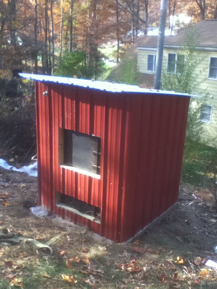

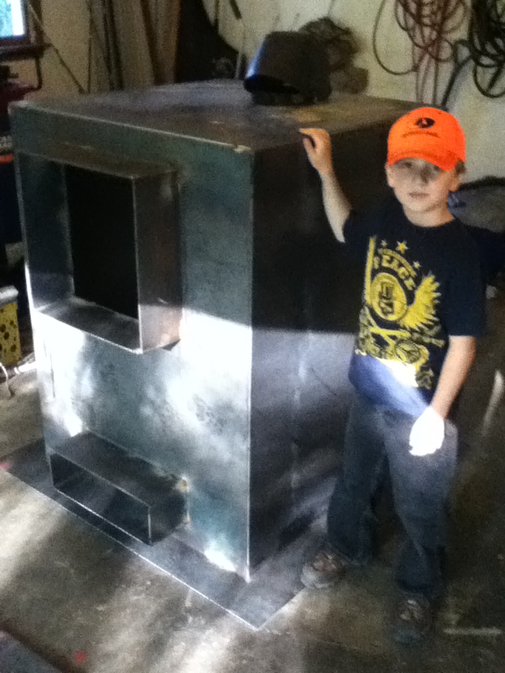

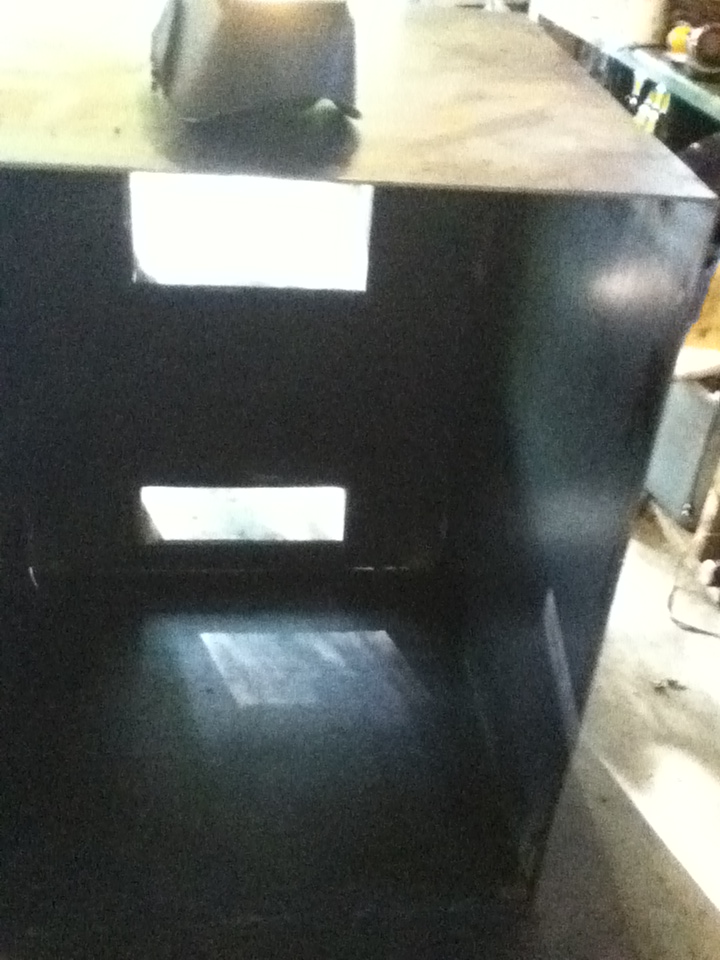

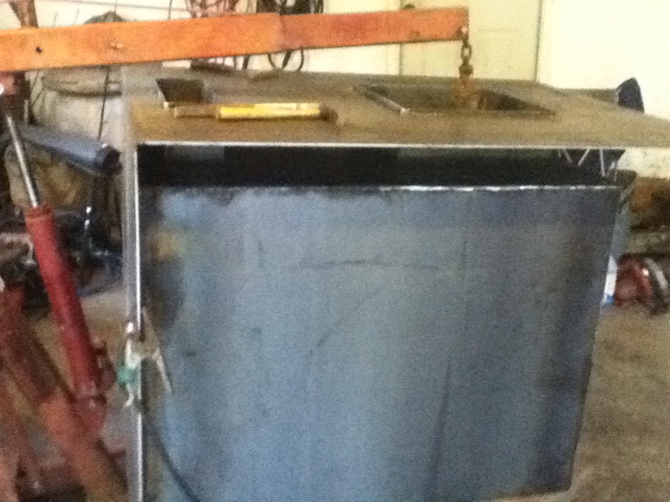

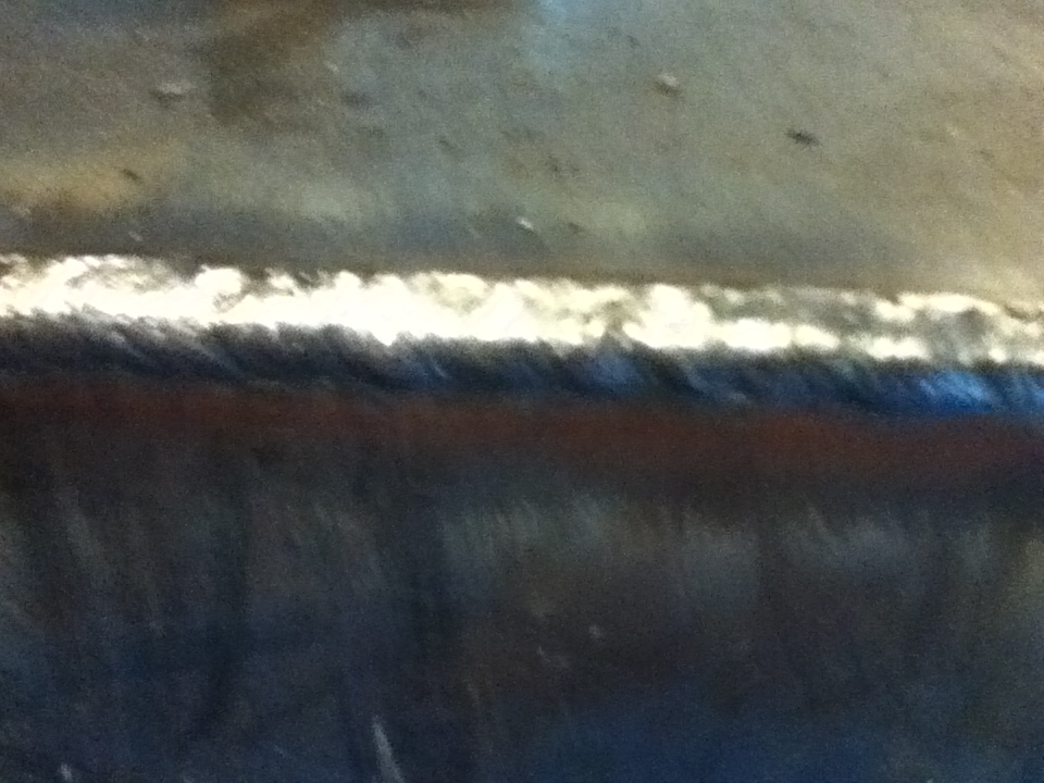

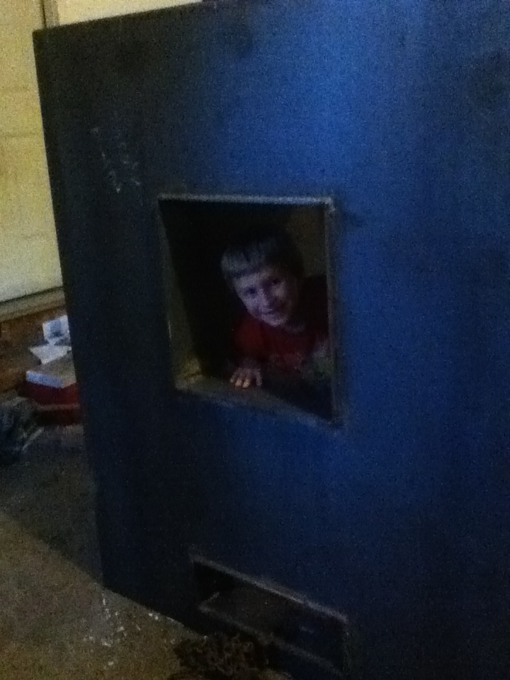

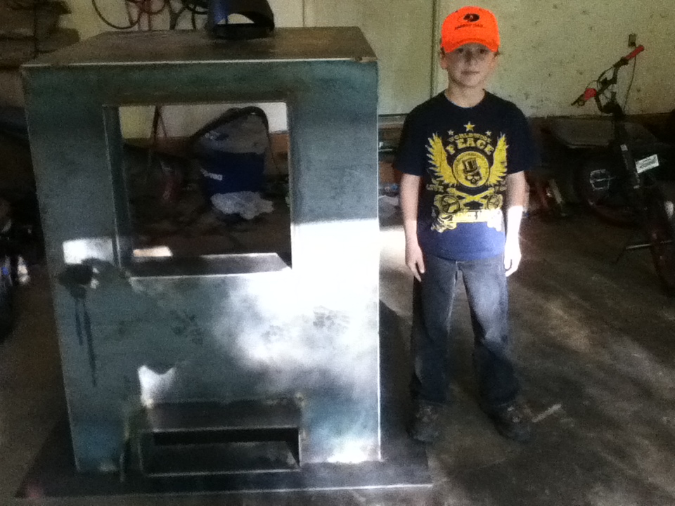

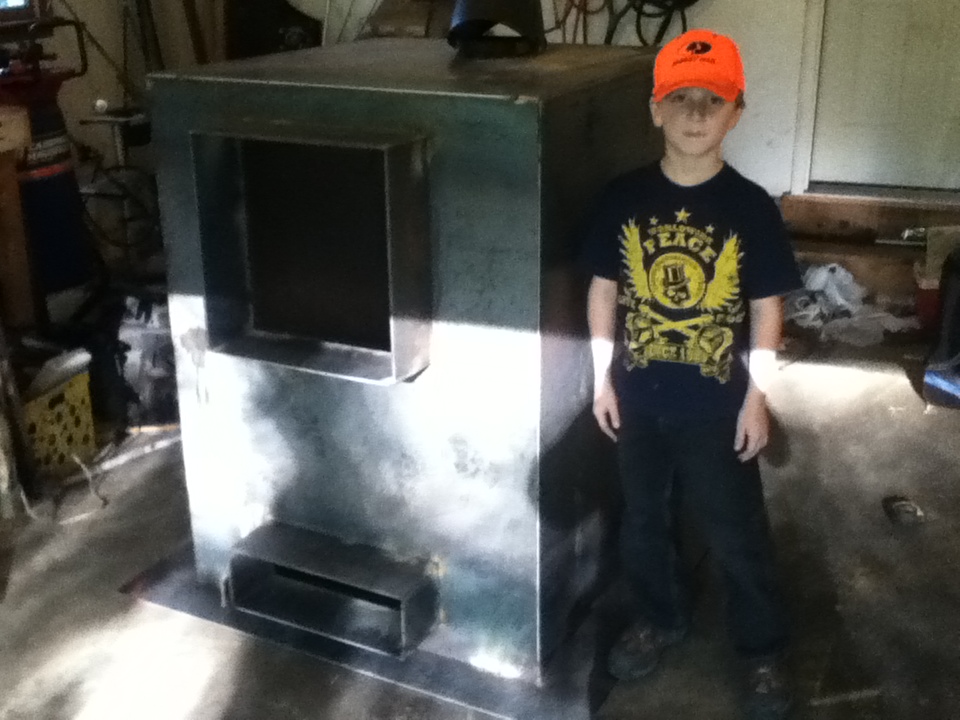

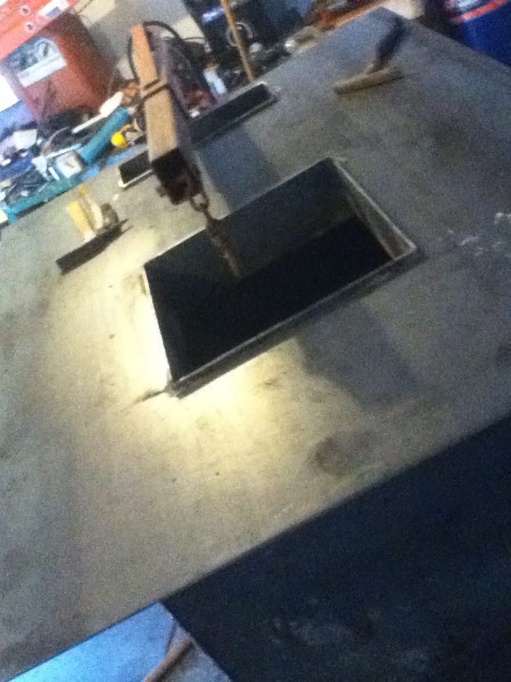

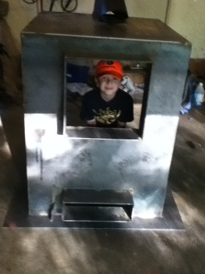

I started this project around the first of September. Im build a 3'depthx3'widthx4'tall firebox with a 4'x4'x5' water jacket here some pictures from the first day I started working on it. Im stick welding everything with 1/8th 7018 electrodes
The main door is 18x18 the ash pan door is 6"x18"
It took 6 4'x8' sheets of 1/4" a36 steel plate to build
the bottom has a 36"x26" grate made out of 3/4" hr round bar, there is fire brick on the sides of the grate on an angle.

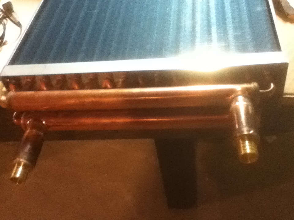

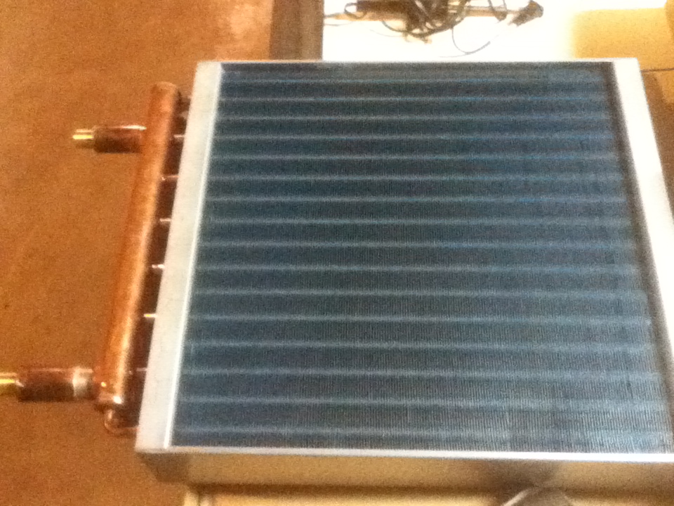

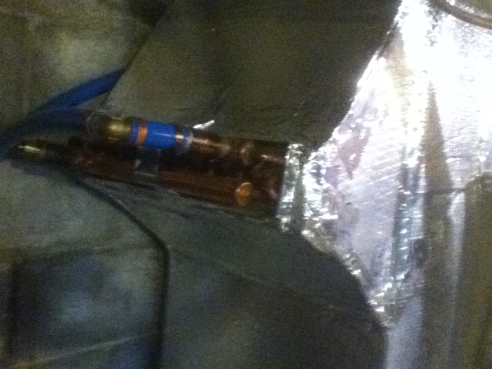

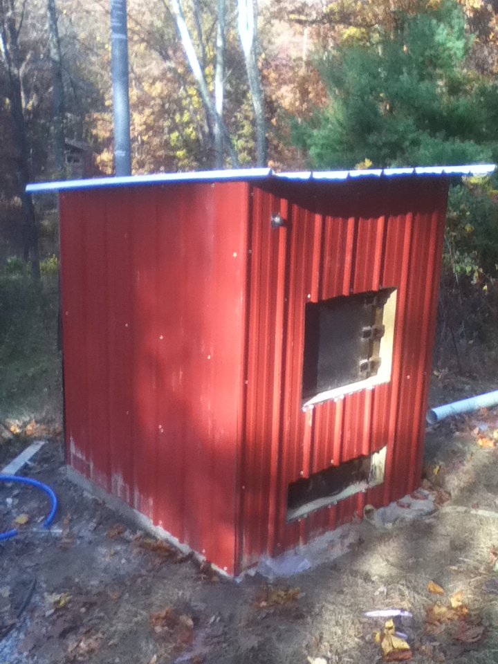

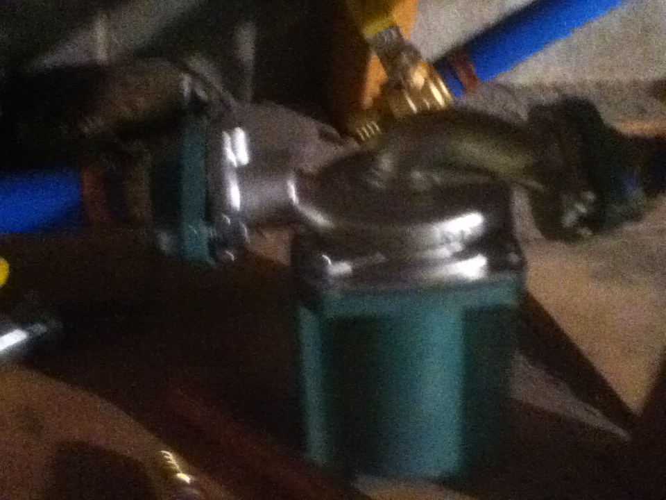

I hooked up the burner to 2 90000 btu heat exchangers one is in my attic and one in my basement. I bought a Taco 0013 stainless circulating pump which I installed in my basement, which is around 70 feet from my burner. The 1" pex then goes to my attic heat exchanger, back down to my basement through another heat exchanger then back to the wood burner. The pump is pushing water through 180 feet of 1" pex. The burner is 15 feet above the pump so it is not having to suck water.
I have been running it for a couple of days, and I'm filling I once a day, with about a wheel barrow load of wood. I am mixing green and dry wood, because I dont have enough seasoned wood this year.

looks good ! only think i would have done to make the build easier is, not worry about a ash collector. We have a Taylor outdoor burner piece of junk . that i plan on replacing with a custom built one... once i find the materials . cheap lol
I put my blower through the ash pan door. I also wanted a grate and needed the door to get the ashes out without taking the grate out. the grate weighs about 150 pounds, it has 40 feet of 3/4 round bar in it.

2 Heat exchangers $268.00

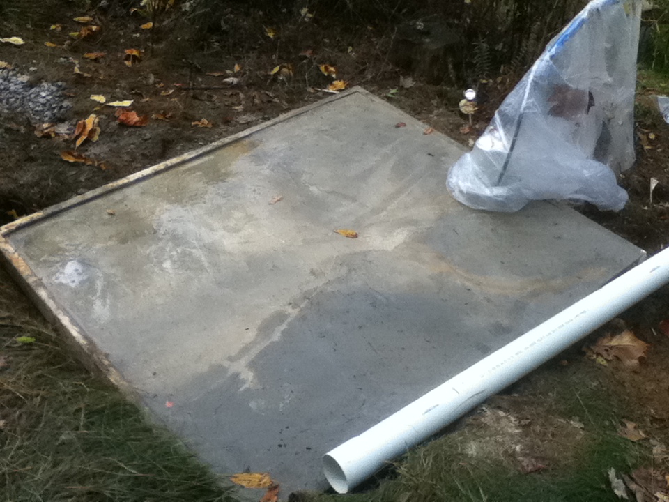

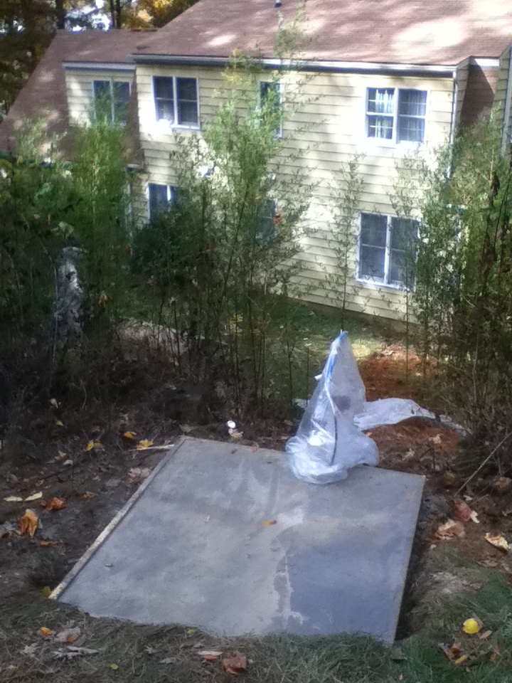

concrete $50.00

Beautiful work! Did your son help at all? You seems like you could teach him a thing or two and he obviously seems interested though still a little young.
/ Outdoor wood burner project
#15
I cut a years worth of wood in three days, hauled it and dumped it in a pile. I don't split anything I put in my OWB. I sell firewood so I have everything on hand to work with. I pretty much burn all the poplar and pine I don't sell.
My son is an automatic rod dispenser, I get twice as much work done when he helps me out

Is the foam insulation what you used to insulate the firebox?
My Father was a very good welder by profession, and believe it or not I never learned to weld very well. I also heat my home with wood and haven't had to buy oil since 1994, I use a soapstone wood stove in my house and burn about four cord a year. There's nothing like wood heat in my opinion!
#18
I insulated the water jacket with the rigid foam sheets of insulation.
