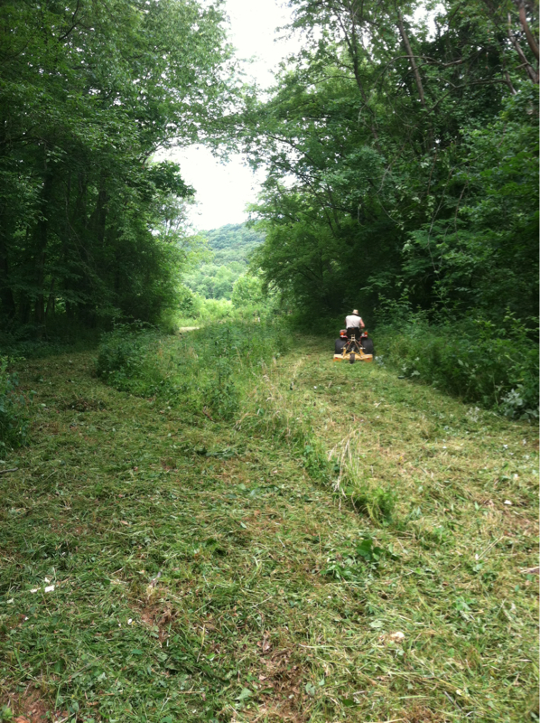

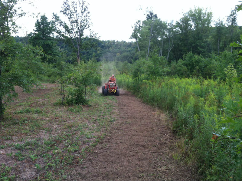

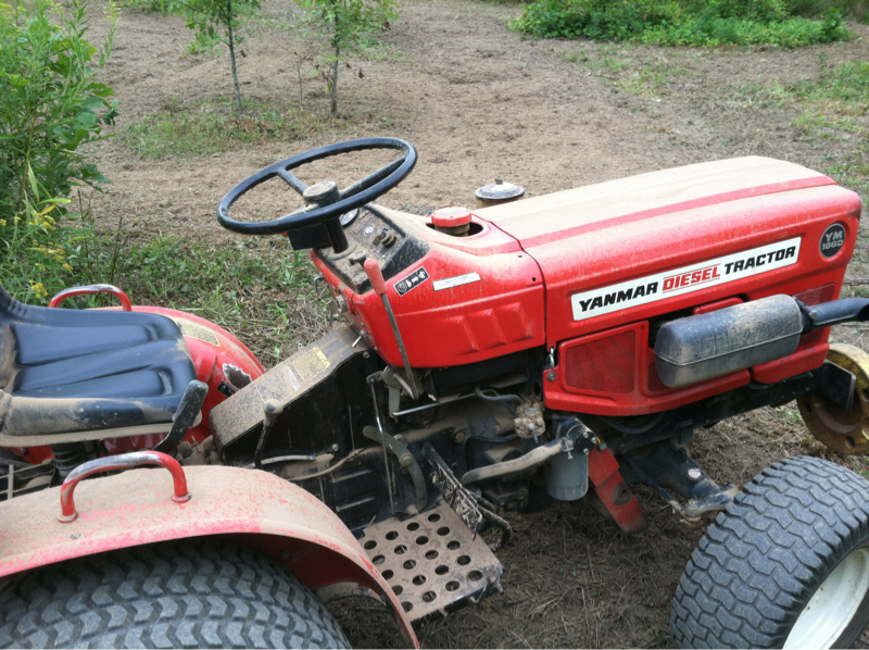

Well we finally got a day to take the tiller out and break it in. Let me say I have never ran a tractor with a tiller on it so I can't compare the yanmar to anything, but the thing did exactly what I have read and expected it to do. What a BEAST! Only issue we had was dad using it as a stump grinder which resulted in a stalled tractor. What a dust storm we had goin! I made a few shallow passes in the middle of the plot and gradually got deeper, all in all had to go over the plot twice. I am covered with poison ivy today because that's all we were filling through! Oh! Thanks again for the video and tips on cutting the shaft, we used it and took 2" of each to make it fit. Ok now here are some pics and videos...
