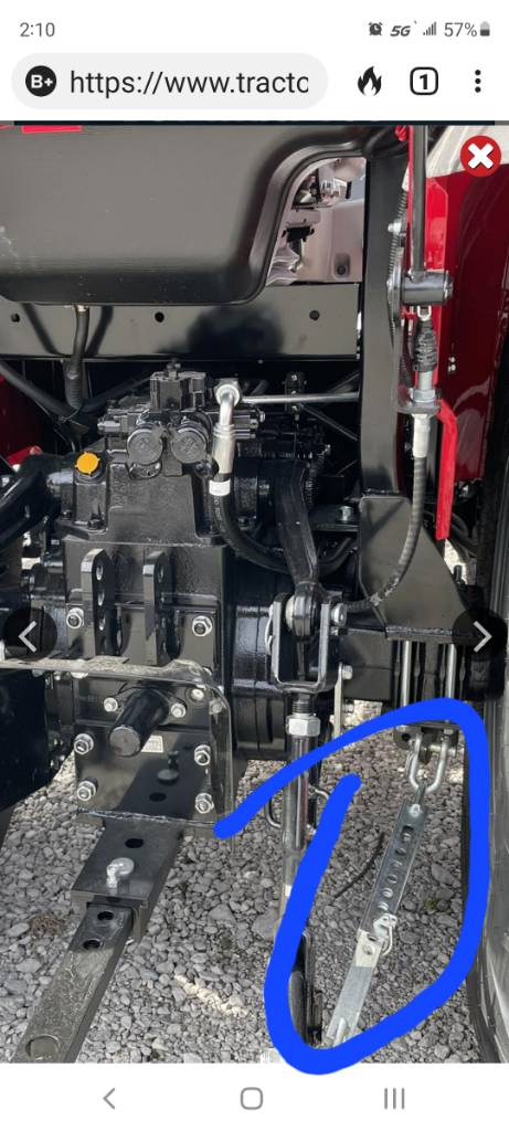

I have new 2022 TYM 474, and dealer did not include check links 3PT hitch stabilizers. Is there a suitable aftermarket pair someone could recommend like this could fit or any other ideas? Below is picture so you can see mine are not there. thank you

So, how much side to side movement do you have. Looking at what you have there, I think you have the triangulation with out the links.

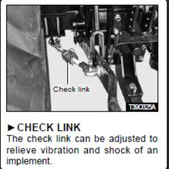

This is what is listed in my manual, and did not come on my tractor:

I would ask the dealer to supply the rest of your tractor. Somebody forgot to install them when they prepped the tractor.

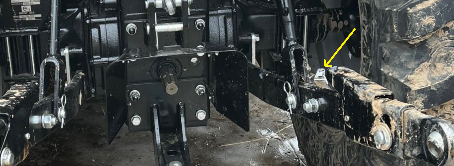

You have large rectangular piece of what appears to be metal running between your check link attachment points. What does it do? Is it an adjustable check link? To my Engineer brain, you have some other form of restraint already installed. Have you downloaded the parts manual, to see if they have made an upgrade to the system, since the owners manual was published. That is not unheard of.

Is it like this circled object. That is the new style vs old style in manual

Are you sure you don't have pin type stabilizers? See pic above. Please post a picture from the tire side of your 3pt arms. It looks like the silver part in the pic below might be a pin type stabilizer.

You are correct! I do have those "new style" stabilizers. When hooked up still sways. I suppose I should adjust them so tight? thank you!

With an implement on the 3-pt, you adjust the right one so you have at least an inch of clearance to the left tire. Then adjust the left so you have an inch of clearance to the right tire. The 3-pt needs a bit of wiggle room, or you will break things.

Yes, you can tighten them, BUT, as Jigs said above, there has to be SOME play side to side on the implements. I usually try for about an inch of side play.

How much play you need depends on the implement. Plowing a rocky soil, lots of play so things can deflect around big rocks. A landscape rake doesn’t need much play, unless you’re raking rocks.

If it still sways with the pin installed, you may have the pin in the slotted position. Try putting the pin in one of the other holes.
