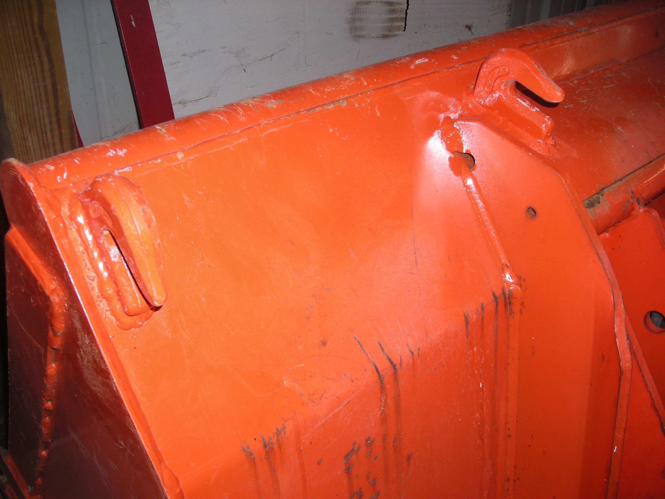

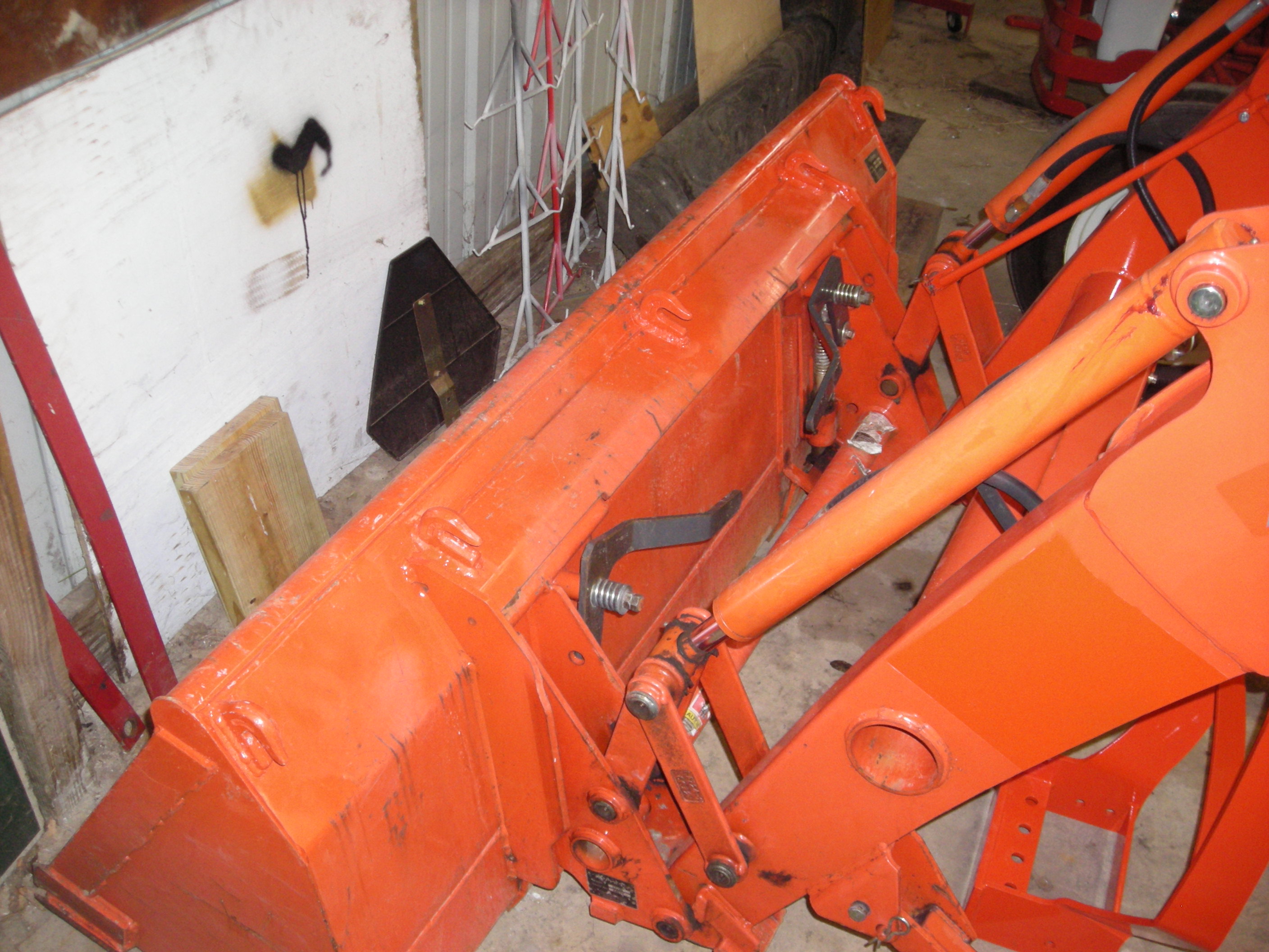

/ Orange Crush #59
I desperately need hooks. Don't have em on my bucket now and I wish for them every time I move something big.
You should talk to the dealer about putting them on before delivery, but be sure to specify how many and where to locate them as our dealer did not put them on our 8540 the way we wanted and my sons will have to move them or add a couple more as two are close the outside rather than in line with the lift arm and they didn't reinforce them so one is already bent.
I got some from Truck and Tow for my sons to put on our 5030 as soon as one of them can get caught up.
/ Orange Crush #60
I got my weld on grab hooks from Truck and Tow. 5/16" hooks fits 1/4, 5/16, and 3/8 chain. I put 5 on. With heavy duty round back bucket, no need to reinforce the welds. Philip.
