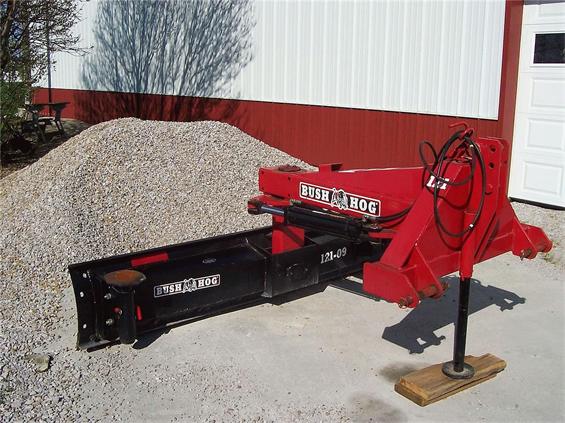

I liked the Bush hog, Landpride, Rhino and Woods. All rated for my 85hp or better. My target width was 8' but I found a 9' Bush Hog 121-09 used for a good price.
How much tilt can you get each way w/tilt lift link? The 121=09 only has an angle cylinder, but offset and tilt can be added.

Depends on your 3pt geometry, but some where between 10 & 15 degrees. Doesn't sound like much, but it is usually more than your tractor can pull in one cut anyway. Get that Bush hog if you can, that is a VERY good blade and the offset hydraulic is easily added.
