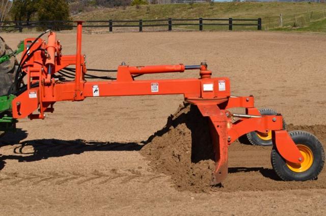

IMO - It's mandatory for a blade to be fitted with hydraulic angle, tilt & offset with rear wheels for serious work- though @ 3m/9'10" & CatII/III linkage a 70hp or better tractor is required :-

I have the RBT3584. I was stretching my budget and only have 2 remotes, so I got hyd on angle and tilt, but manual on offset. For anyone who is considering options on a rear blade, I have to say my choice was a mistake based on my requirements which include snow and dirt -- if only getting two, I would get angle and offset, and do the tilt manually.
