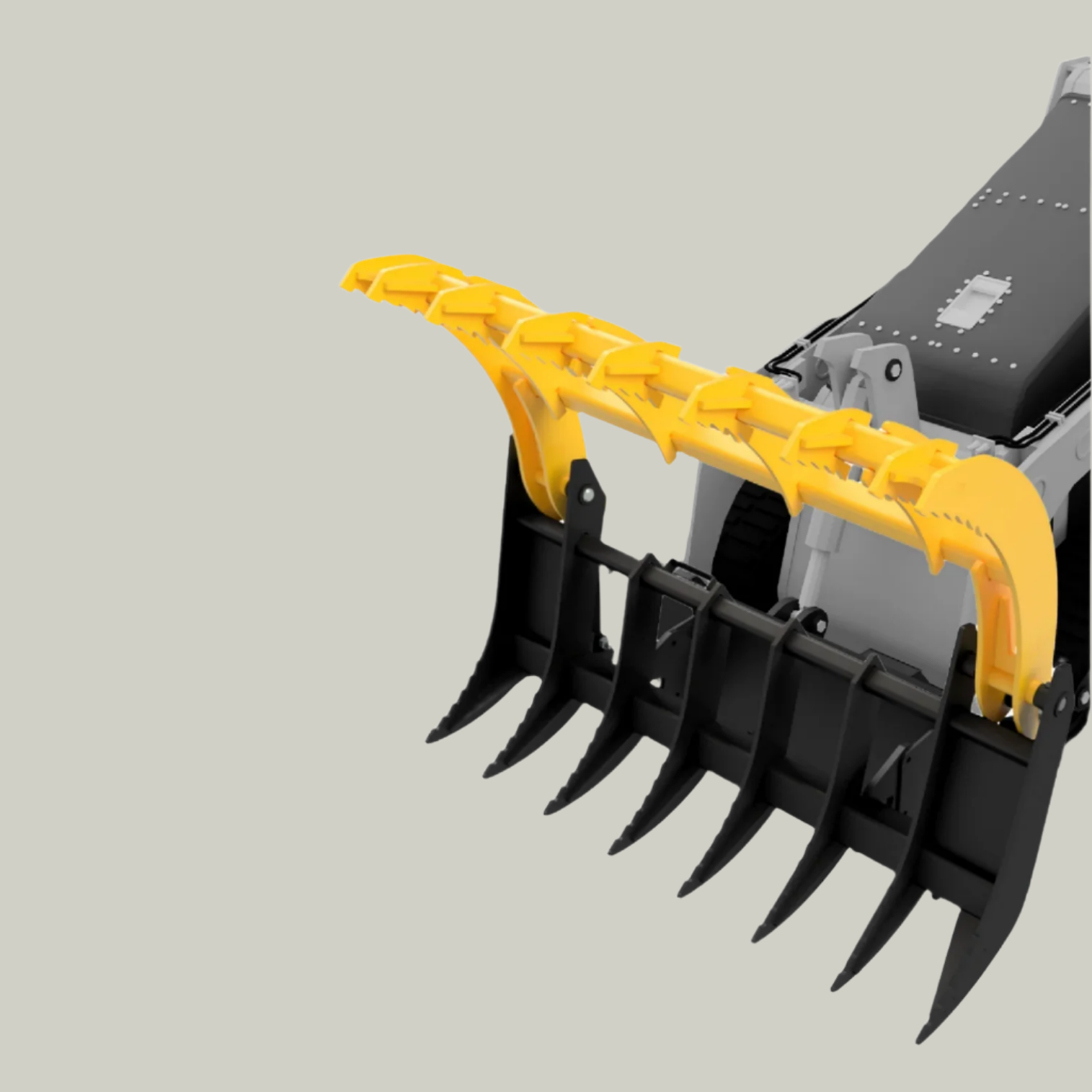

smokin joe
Nov 14, 2020
19
L3901 TLB
Opinions on Quick Attach
For a Kubota L3901 tractor.
It's made from Grade 50 steel. 375 lbs. 1 3"-cylinder. 3400 shipped.
I was looking at the Landpride scg0660 at 250ish pounds made out of AR400 steel. Can't find many of those...and where I did told me to figure out freight shipping from their location. 2900+ shipping.

Definately some good advice here...but I think I am inexperienced enough that I'm jot sure I understand somenof the nuances of what you are saying.
Quick Attach is the company's name. They have 4 different attachment configurationsand make one for th L3901. I did ask the canyon after the above post and they sent the following dimensions (see pic).
There are some comments about whether the grapple is the right tool for the job...Great points...but I do jot understand what you are saying. Please have patience and clarify. Is this grapple to heavy for an L3901? If so...what would you suggest? I am confused with the working capacity and max capacity of a mini Skid Steer. Im Sure they are different from my tractor...but why is that important. Maybe intuitive to some...but have not used one in a long time.
Really trying to see if this company is a quality cpany and if this implement is worthwhile. Too heavy? Too light? The mounting plate was a good comment that I could ask about.
Tha KS for your patience. Trying to learn.
/ Opinions on Quick Attach mini industrial grapple #9
Well if they will put a full size ssqa plate on it for you then great. I wasnt sure if thats what they meant by ‘universal plate’ because that kinda sounded like a blank plate they just expect you to weld to. None of the other options are formats a tractor would have on it unless you added it. The Bobcat MT-whatever format is closest as its basically a narrower version of the regular full size ssqa plate.
Not all mini skid grapples are suitable for anything other than a mini skid because a lot of times the grapple cylinder’s placement would interfere with the larger attachment plate. In this case it looks like they just pushed the entire attachment far enough out in front of the attachment plate that the cylinder tucks entirely in between them. lot of dual cylinder mini skid grapples have the cylinders less than 45” apart which means you couldnt fot a full size ssqa plate between them without ‘standing it off’ a good 6” and while yeah that’s possible, i would guess most people shopping mini skid implements are concerned about losing capacity from an already limited number, otherwise theyd be shopping 55”+ full size ssqa implements.
But regardless the plate they showed you is the ‘normal’ ssqa plate and if you have ssqa on your loader, it will work for you. 👍

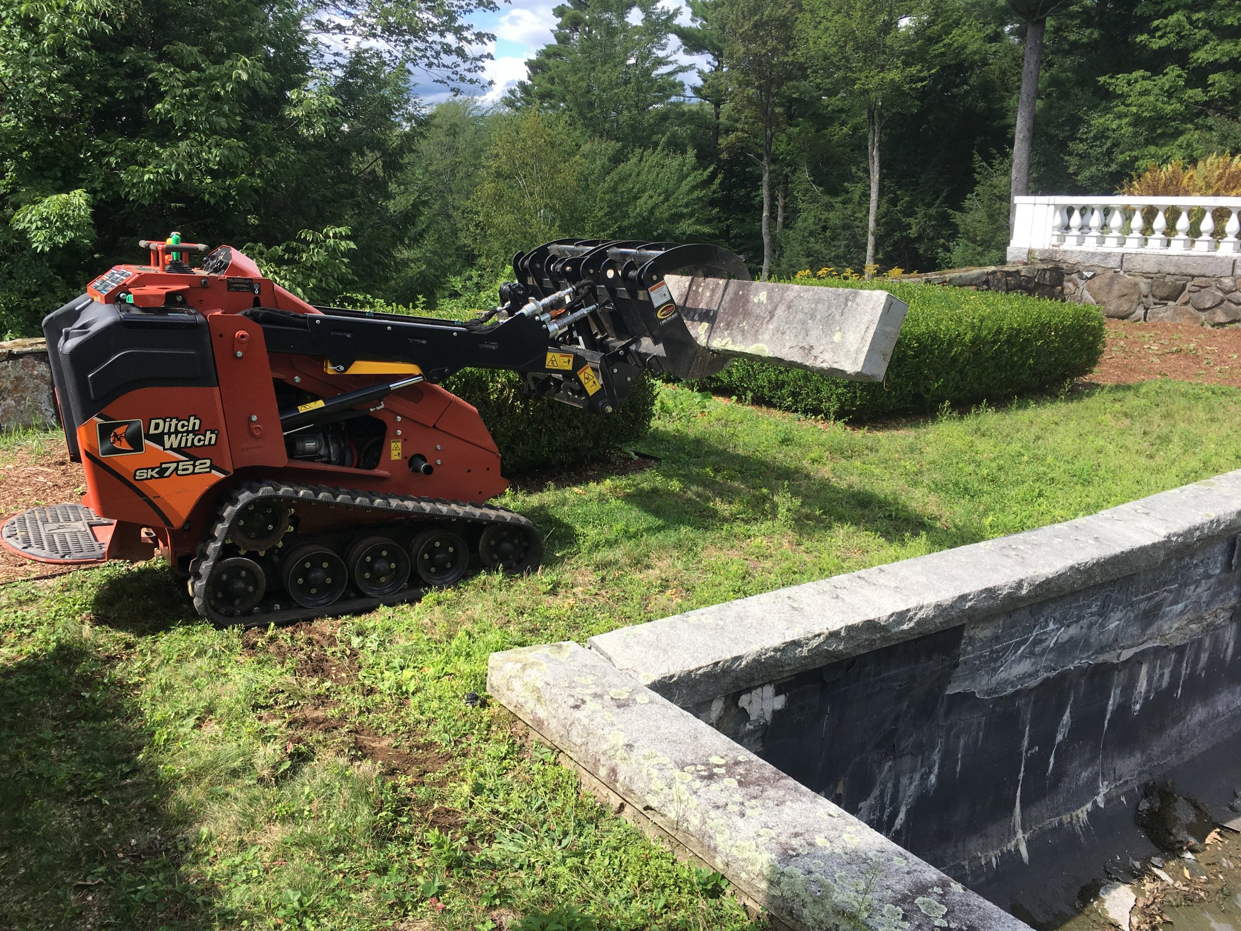

A mini skid steer is actually pretty strong. Something along the lines of a Ditch-witch sk-800 would easily out lift an L3901. But the point remains that the hitch plates are different.
/ Opinions on Quick Attach mini industrial grapple #12
I have a 'small' 3000lb skid steer from the 70s, which is essentially the same weight, size, and operating capacity as the SK800. The sk800 is a 'mini' skid but mine is just 'small'. :ROFLMAO:
