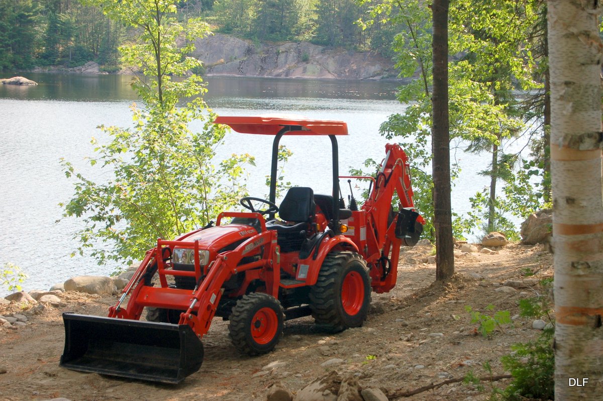

Hello and congratulations on your new purchase.
I have a KB2465 attached to my CK20s, a very nice and powerful implement.

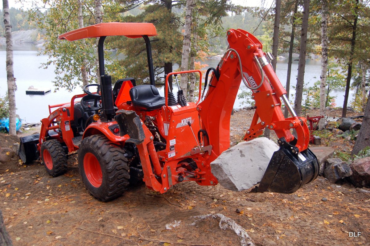

The boom lock is a latch type and can easily be set or released from the seat. The swing lock is a pin type and can also be set from the seat. Both should be set when backhoe is not being used or when transporting the tractor according to the manual. I have travelled without setting them and have not had any movement, however I do try to remember to set them as good practice,

Note the boom latch in the photo holding the Rock. Don't know what I would do without the backhoe.
