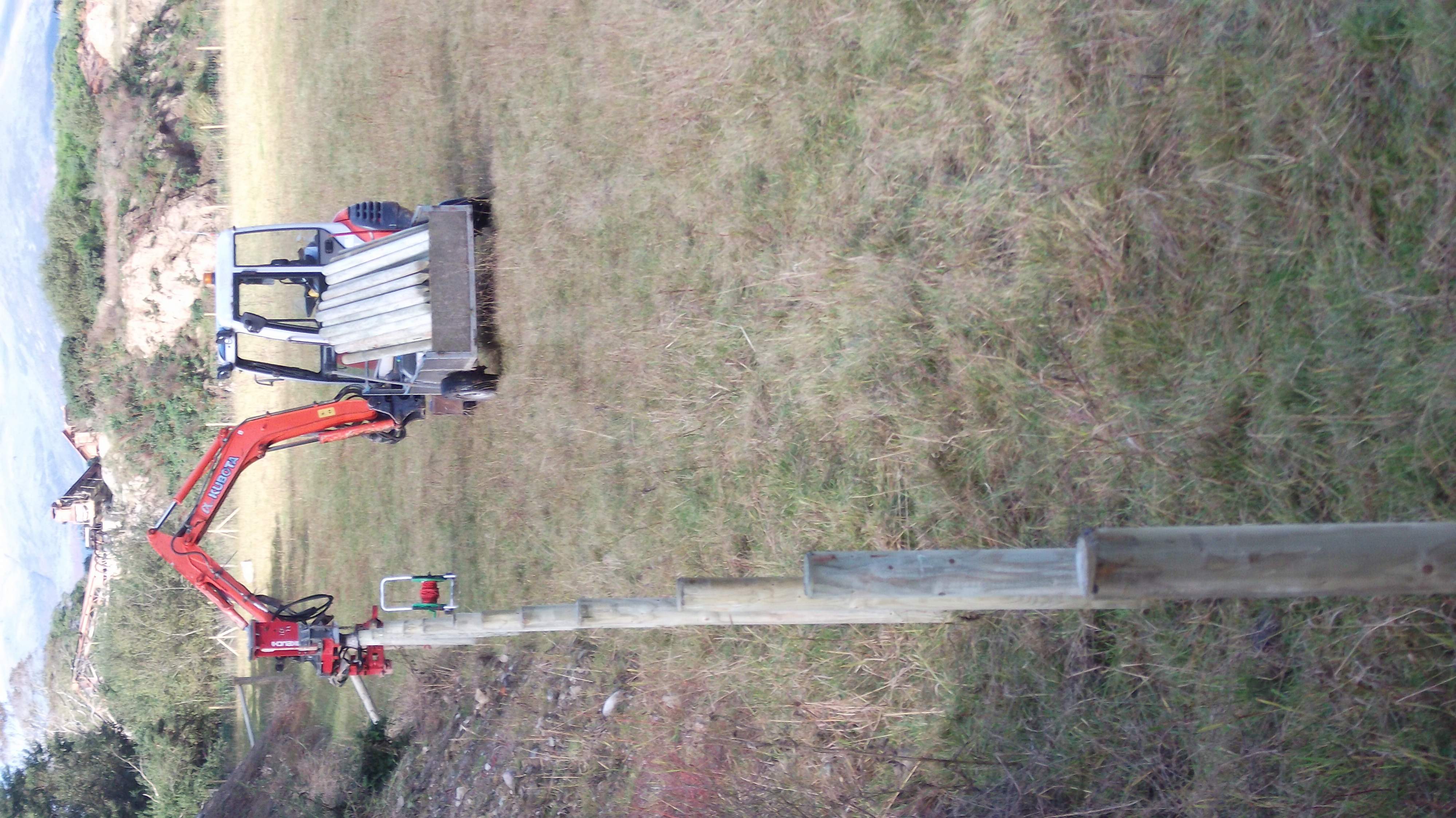

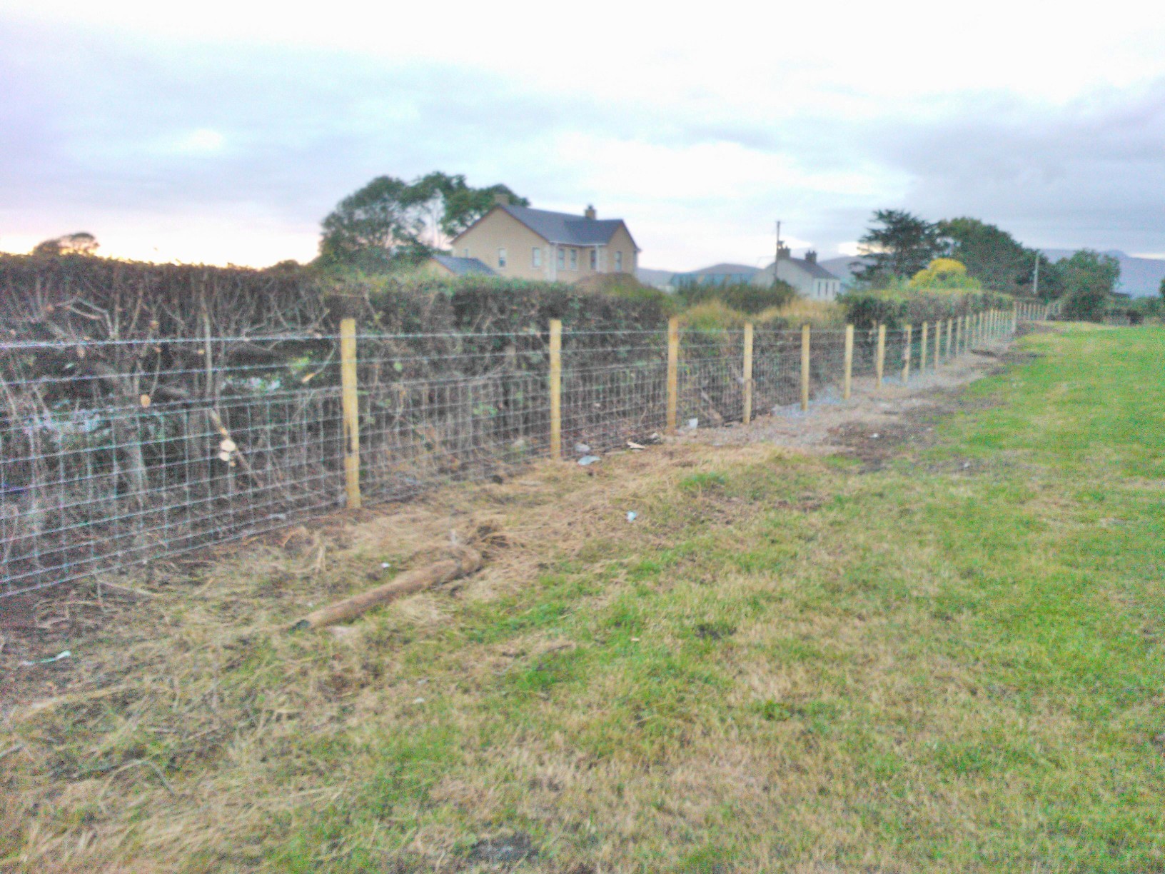

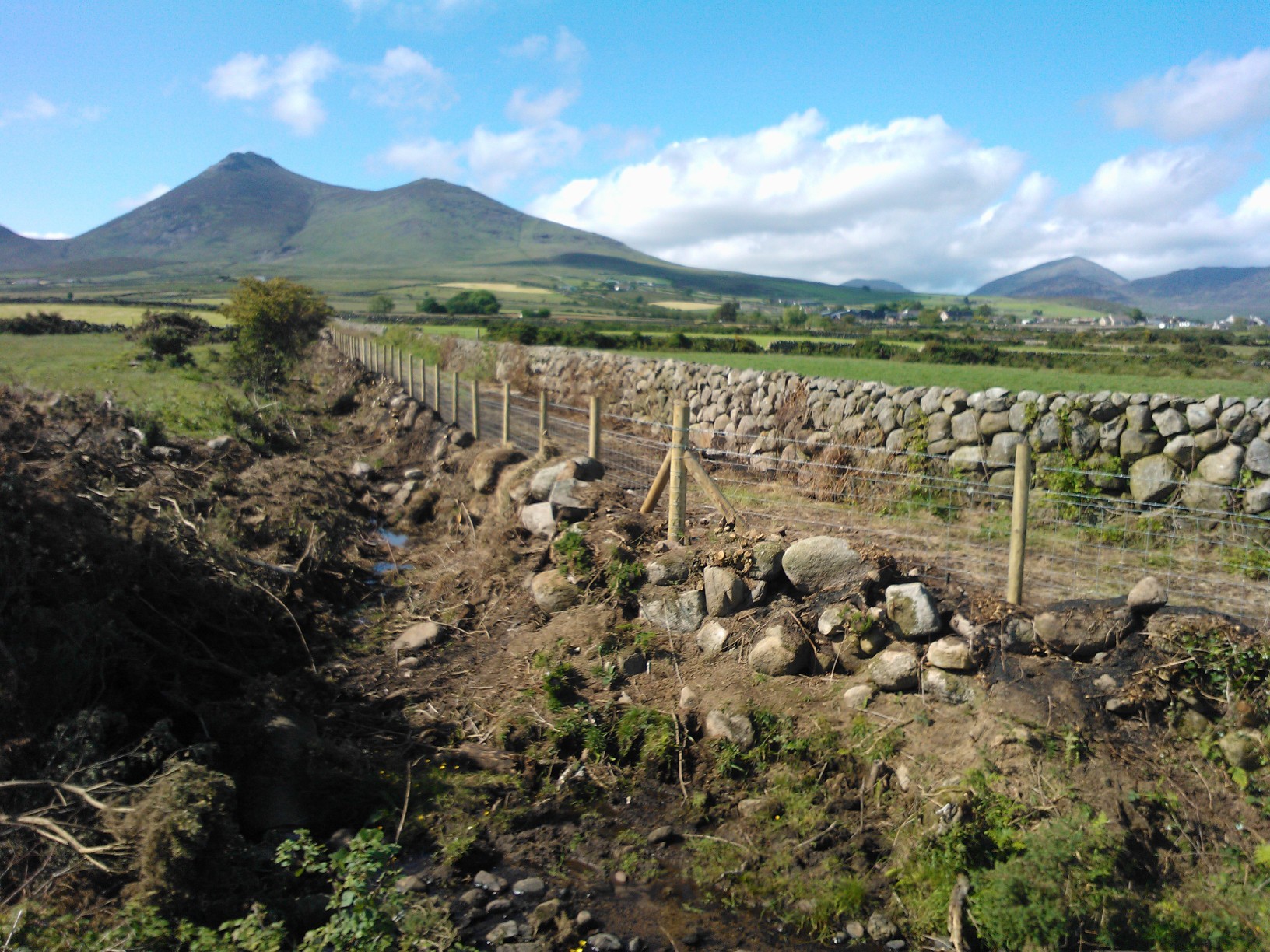

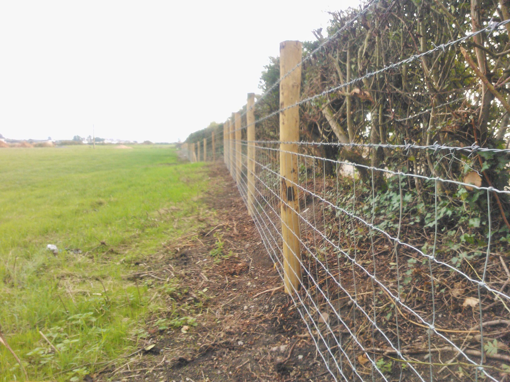

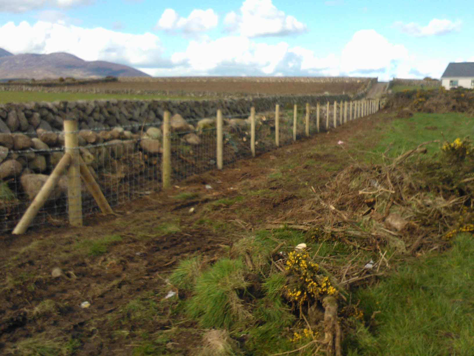

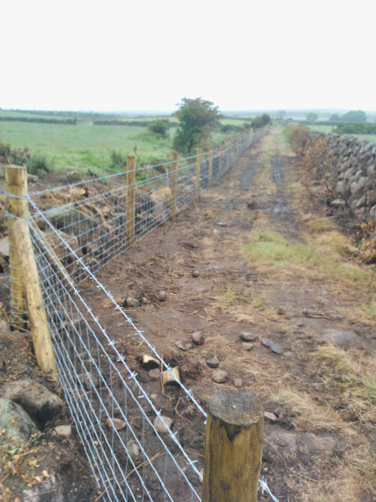

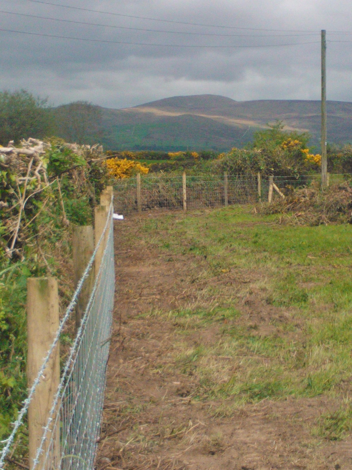

hope the photos explain themselves

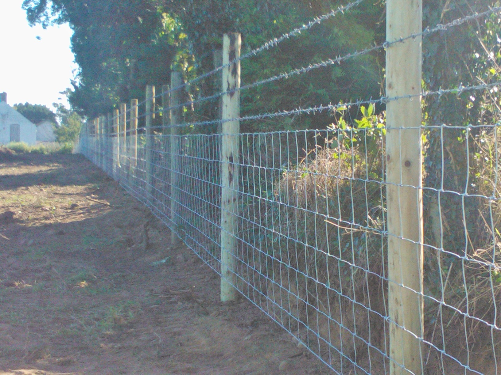

/ one man fencing #4
I am so envious. That is beautiful fencing.
The handling of the wire is wonderful. That is the part I found to be the most difficult.
Well done!

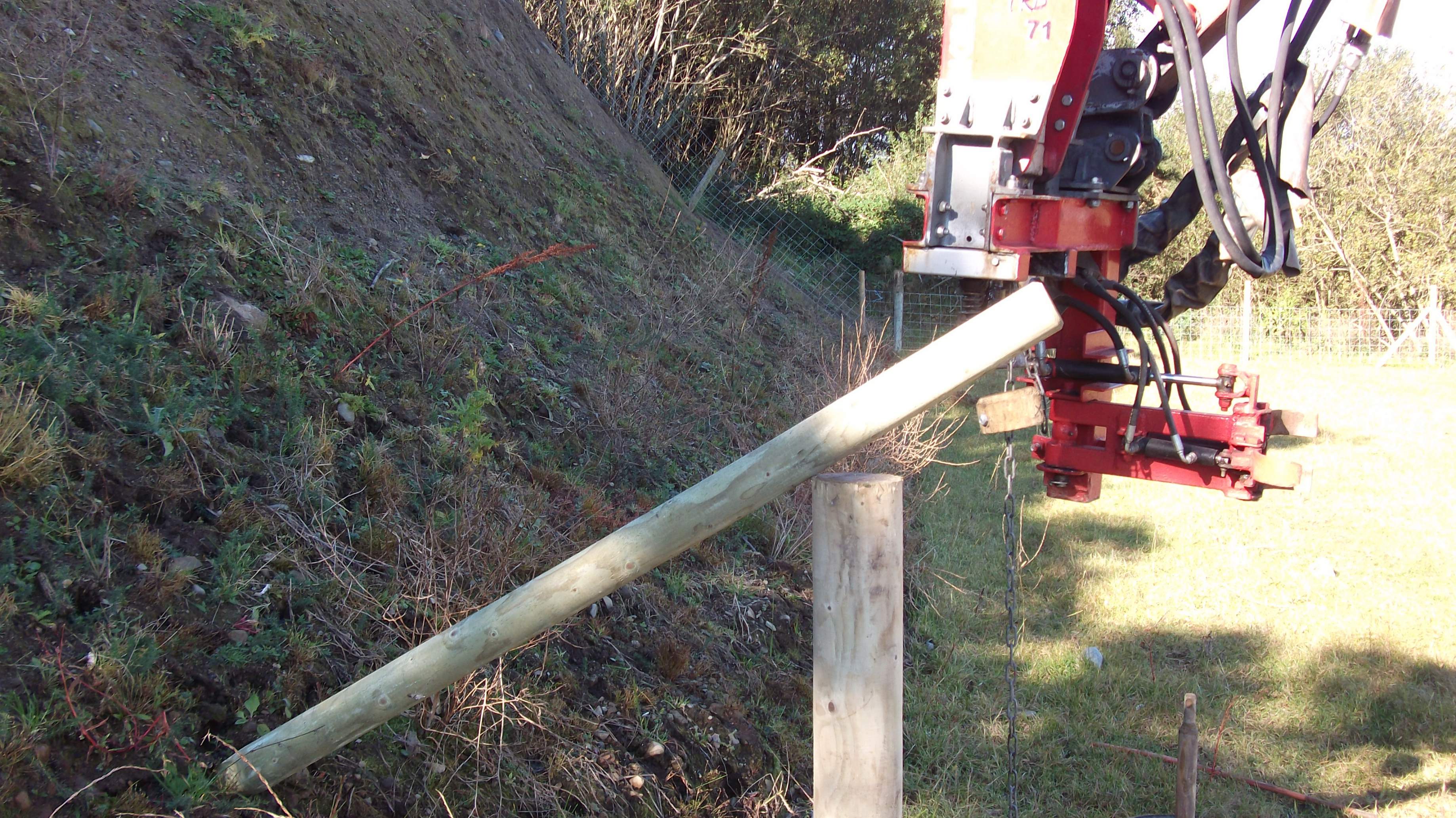

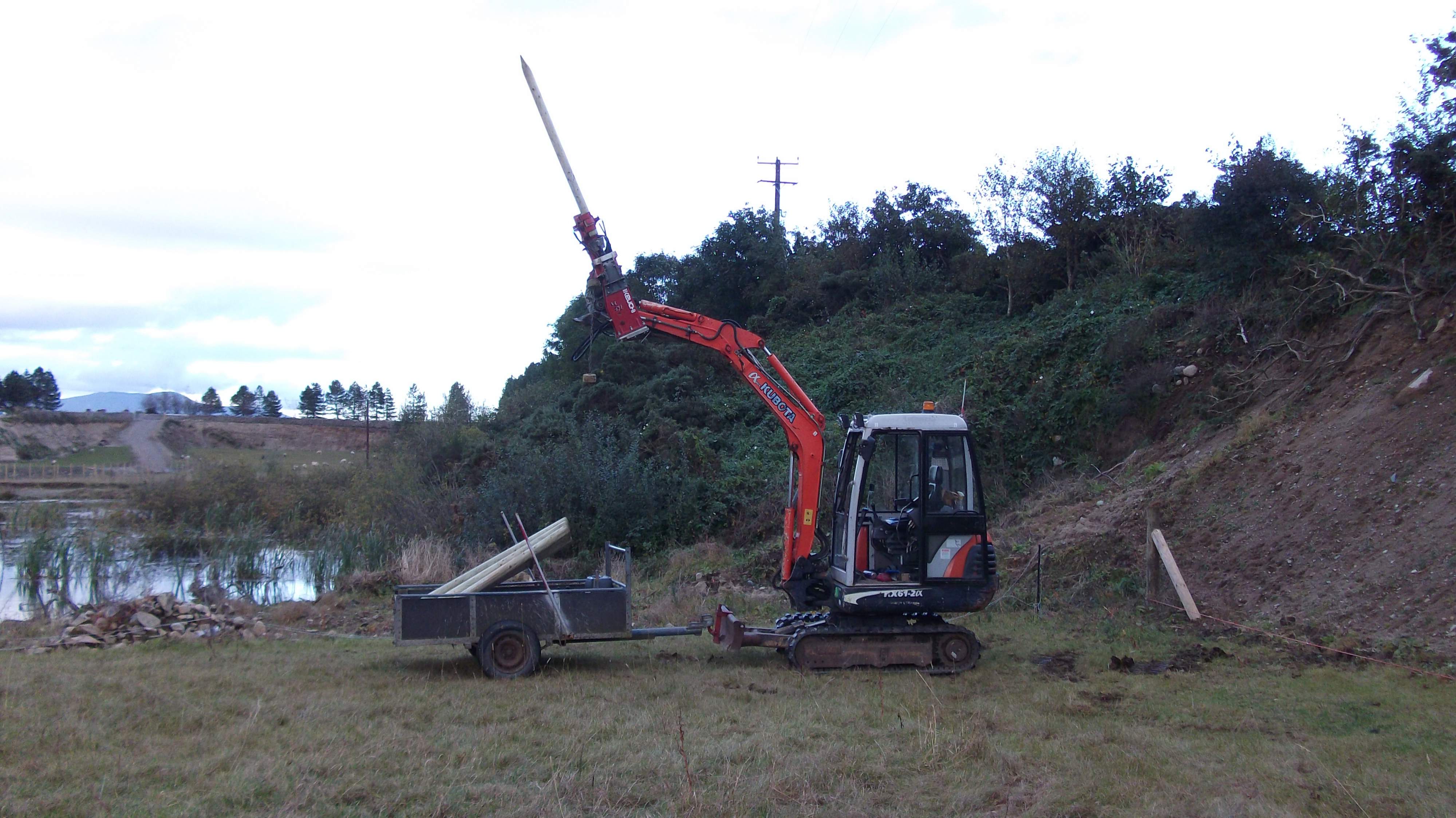

/ one man fencing #6
Very nice fencing job! Nice setup with the trailer, grapple and pounder too.

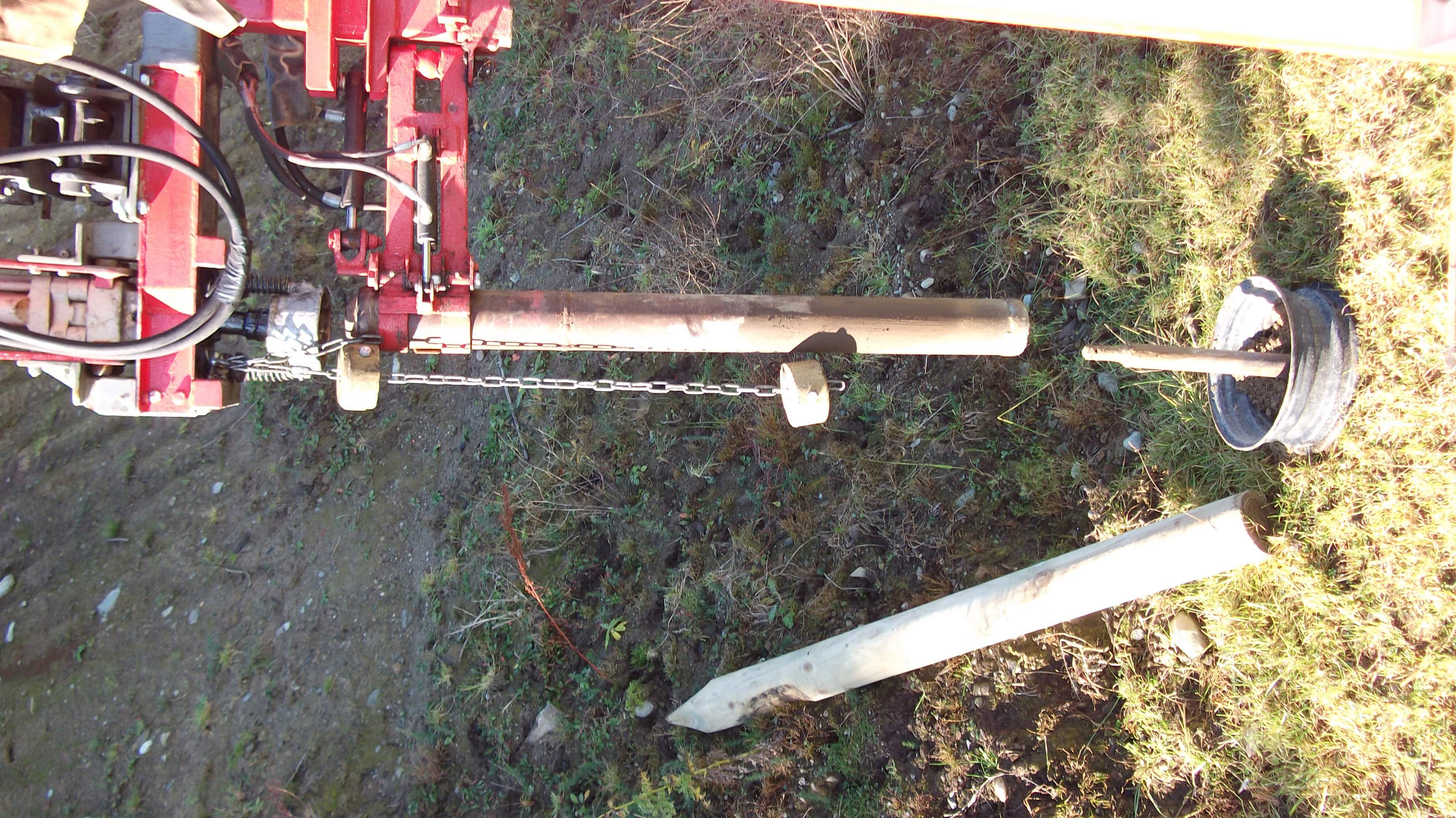

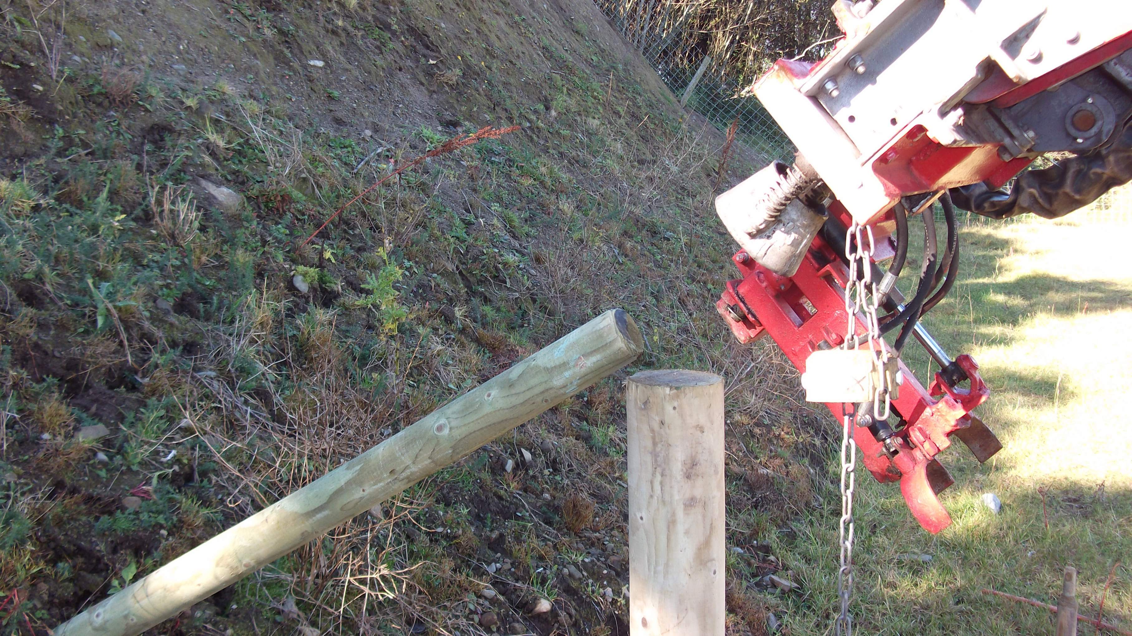

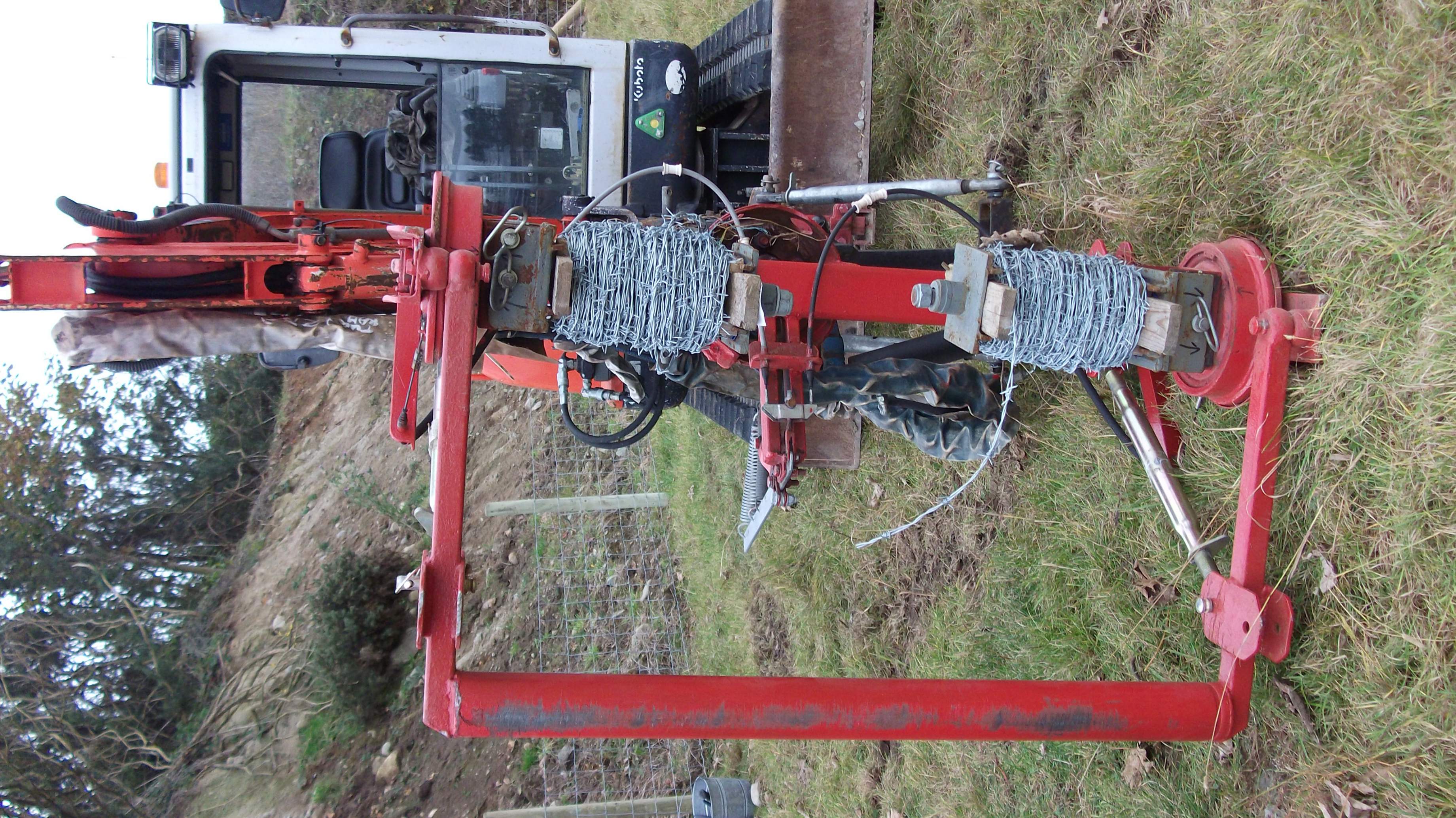

Did you build this setup or buy/rent it?
How do you keep the posts straight when pounding and do they come pre-pointed?

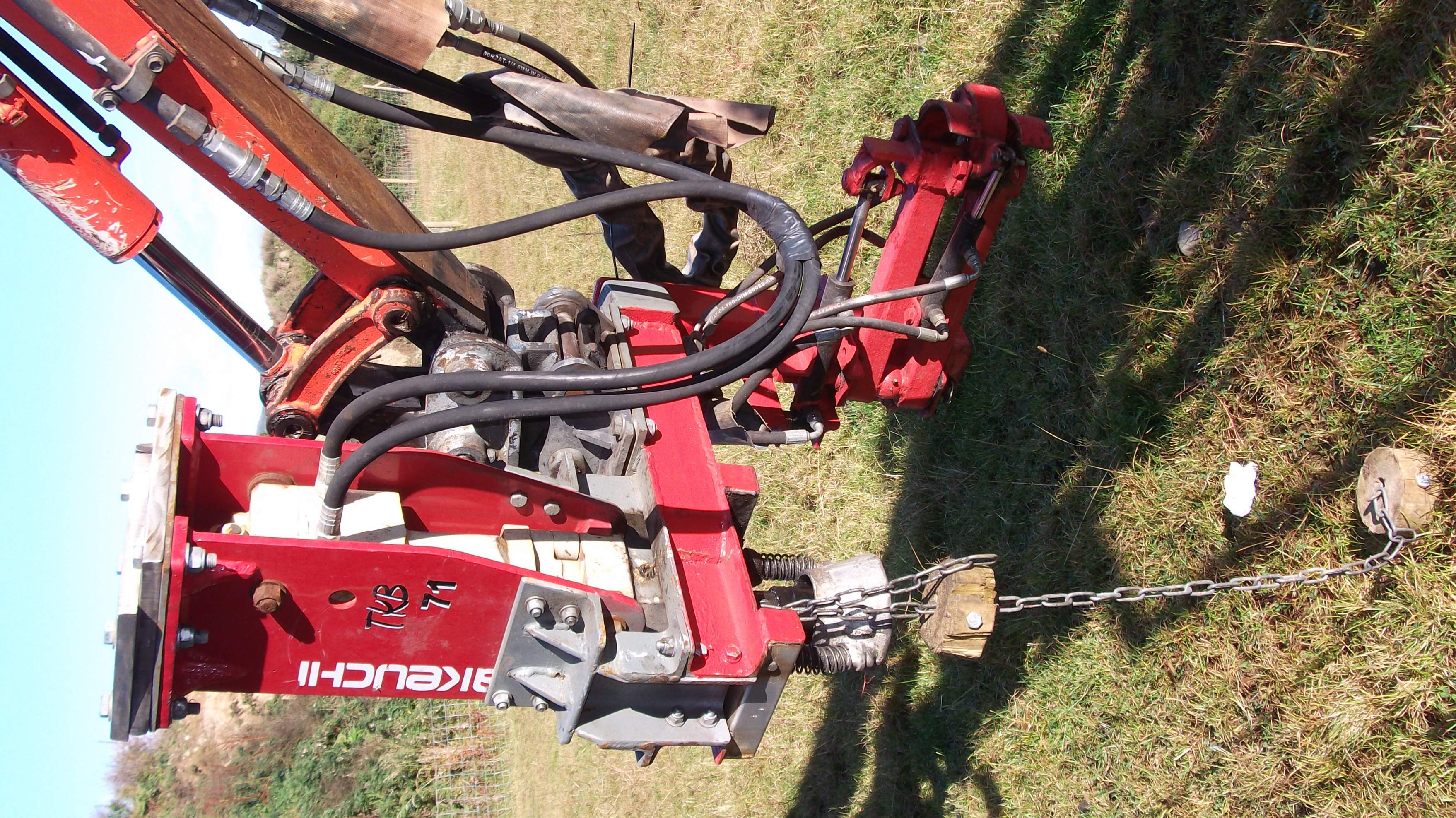

/ one man fencing
its a small rock hammer, driving in the strainers was a problem but i can do that now even in fairly hard ground by making a slightly smaller hole cored out with a piece of tubing

/ one man fencing
#11
its all home made, keep posts straight using length of chain as plumb line

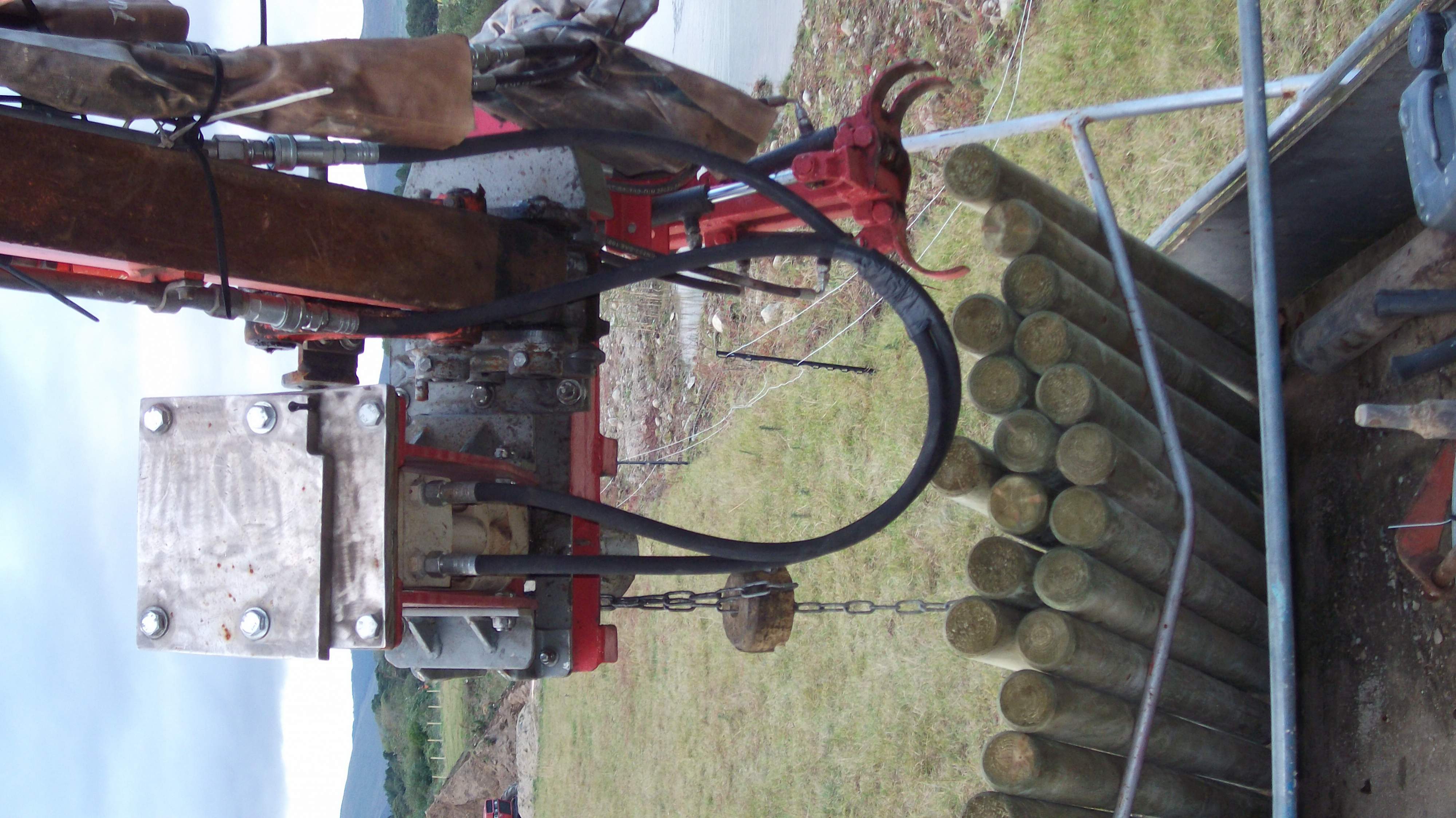

#13
the posts come pre-pointed

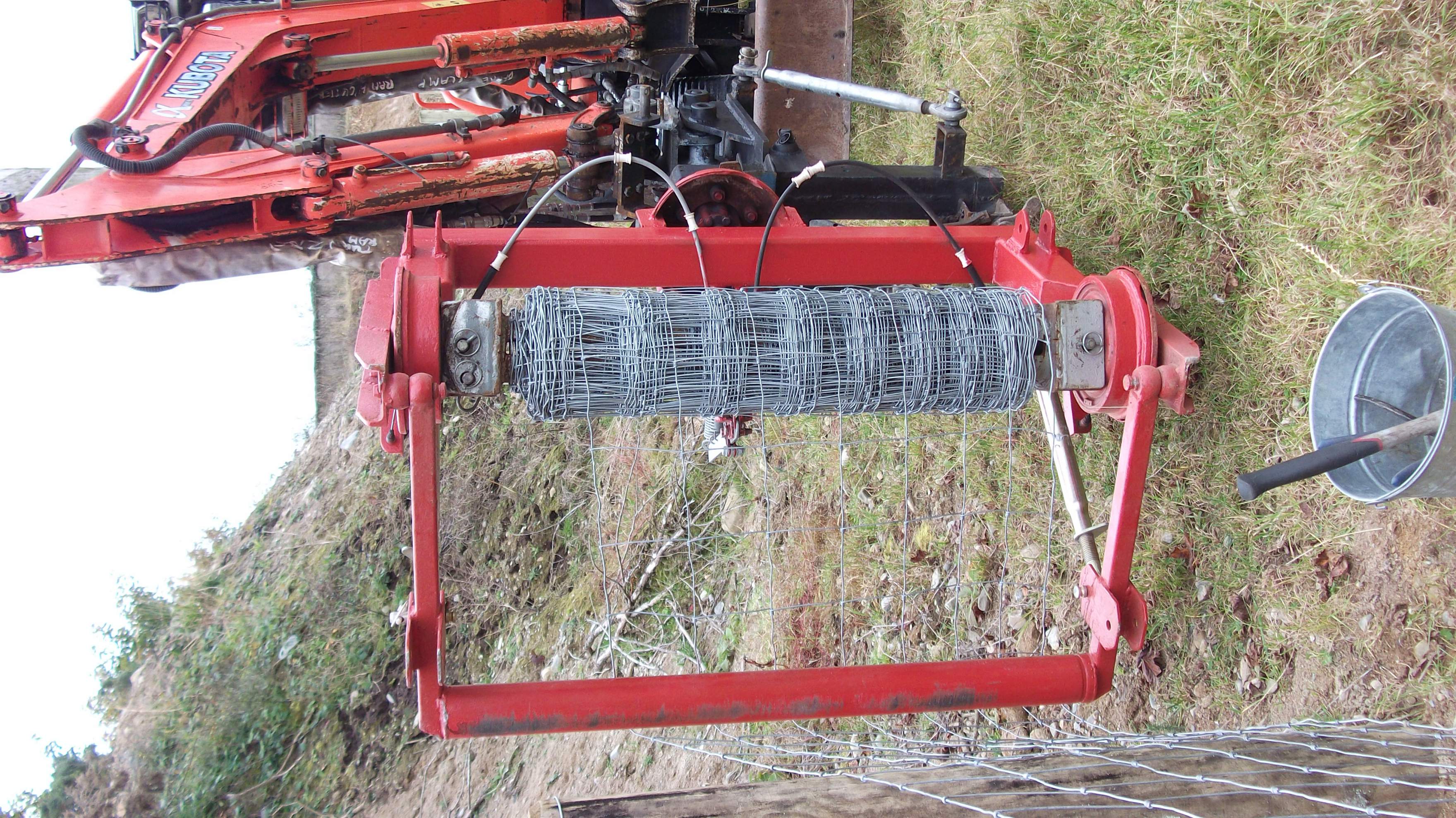

/ one man fencing
#14
the fencing attachment lets the wire to roll out then strains it without leaving the cab the main part of it is 2 old car rear hubs rolls out and strains both sheep wire and then barbed wire
