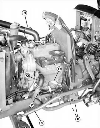

On the left side of the engine at the starter is a fusible link. There is a plastic connector on each end (usually white) that can be disconnected on one end or even better remove it and put it in your pocket. This link is nothing more than a special piece of wire that is designed to melt if there is a major short circuit to protect the electrical system. It is labeled "O" in the attached picture. Just don't lose the wire if you remove it.

That's what I was looking for.
Thanks for the tip.
