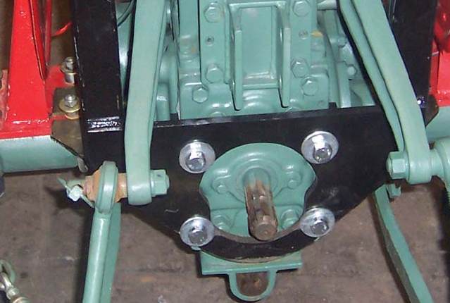

/ Once in a lifetime........ #28
It looks like from the OP sig that he has a YM2210D. Fredricks has some good ROPs info on their site and I think they are the source for most of the Yanmar ROPs. http://fredricksequipment.com/storage/rops-manuals/Family 4.pdf
I just recently purchased one from them for my YM2210BD. The installation manual for their ROPs has a good picture of the rear of the trans and the PTO cover plate. From the description it sounds like it just pulled the threads out of the bolt holes and if so it would be a matter of "only" replacing the rear trans/PTO cover plate and whatever was damaged of the axle mount fasteners. A quality cast iron weld and remachine could be done to repair the cover but it probably cost more than a replacement cover. Attempting to weld cast iron to mild steel....not a good idea IMO.
Steve
/ Once in a lifetime........ #29
Ok,
In that diagram, it should have been connected, 4 bolts to the back of the PTO housing, and half of one u-bolt around the axle.
It looks like it should be easy enough to replace that one cover, if that is it, and one can actually find the part. Although, are these bolts just into the cover, or into something deeper?

Here is the mounting pic from Steve's link.
The ROPS appears to be mounted on the rear cover of the PTO, along with half a U-Bolt around the axle holding on the fenders. The bolts appear to only be in the cover, but you would have to verify that they don't extend into the transmission.
I assume that is the part number provided by Winston, Part number 194310-24350, although I don't see it online.
Anyway, talk to Yanmar about that piece. Is it available?

Yes, it's the same ROPS. Looks like the cover will fix the tractor.......plus a little PTO disassembly and reassembly !
Today is the first time I have been able to look at the tractor with a clear head. I'll get her in the garage tomorrow and start the work.
Now to find the cover. Thanks to Winston1 for the link, I'll call Steve Monday, and Hoye as well if Spalding doesn't have it.

I installed the same ROPS as Stormpetrel (Group 4) in 2006. Photos. I think the u-bolts are simply the same ones (or maybe longer replacements) that originally held the fenders in place. The ROPS' tab over the axle looks competent to resist downward force. But those u-bolts would snap, given a lot of upward force. Photo showing u-bolts.
