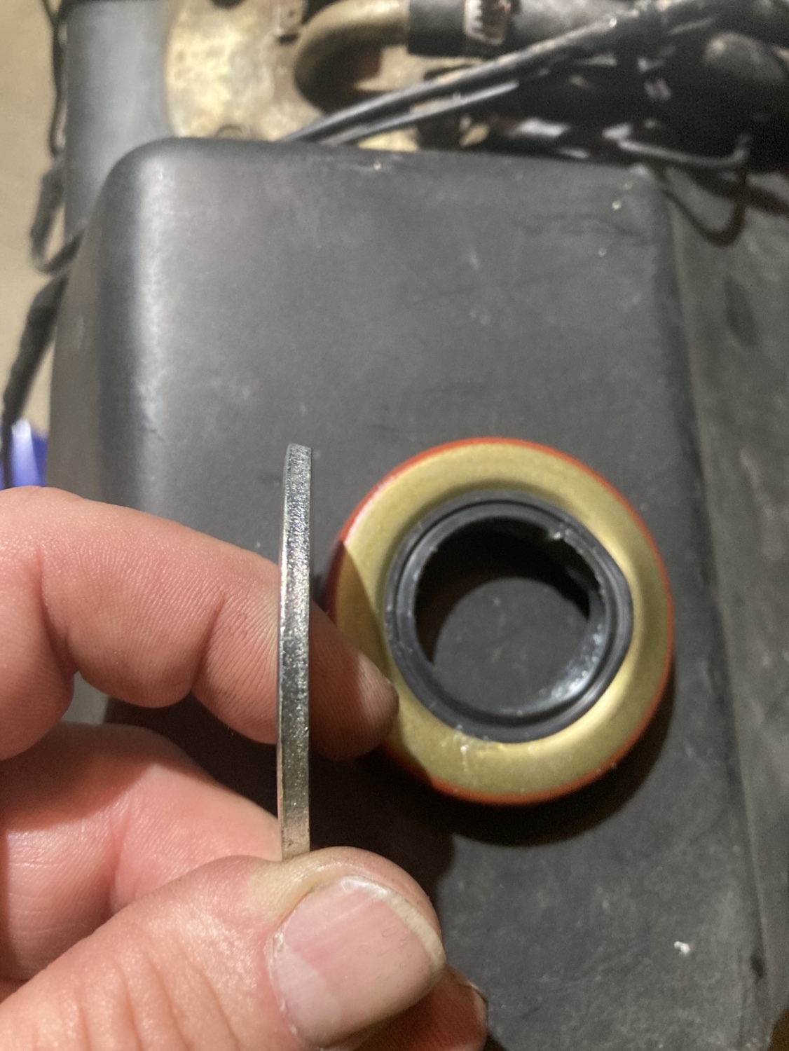

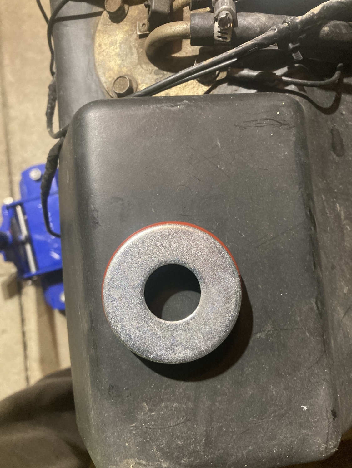

You mean seal, not bearing. I am in process of doing both again, as one was leaking and figured might as well do both while it’s apart( took transmission out to replace gasket between differential and pump) and seal/o-ring in charge pump. Upon inspection, when I installed the seals a couple years ago, they were slightly crooked. The manual calls for them to be recessed 3mm in. First one I think was close and put the housing back on, tightened middle bolt evenly both sides. But when I installed the other side( I set seal into hole, then used a 2x4 to get it flush) I then was setting with seal driver , and it went too far, $28 down toilet as no way to not damage trying to bring it out… so was thinking of how to set it so it doesn’t go too far in, looked through some washers. I had a 7/8” hole washer, with outer diameter of 2”, and it looks like 3mm thick. So I will set seal flush, dab some grease on washer so it stays on face of seal, then use a 2x4 across it to set it flush, which then should be correct depth with spacer

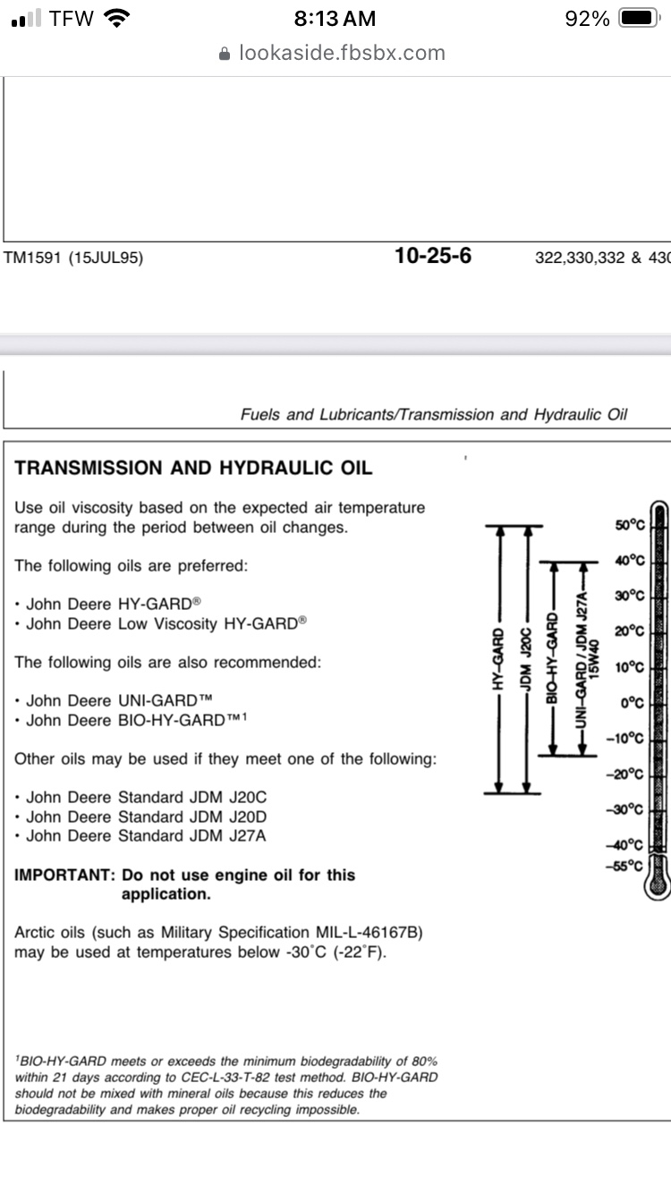

Maybe the rear axle bearings would last longer if the hydrostatic transmission oil & filter (Type F AT oil) were changed regularly...
I believe mine has had type F, but being service manual says I can use a fluid that meets J[emoji[emoji6][emoji6]]C, I’m giving the Traveller Premium Universal Hydraulic fluid a chance on this fill- cheaper and easier to get if you need it in a pinch…
