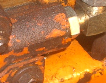

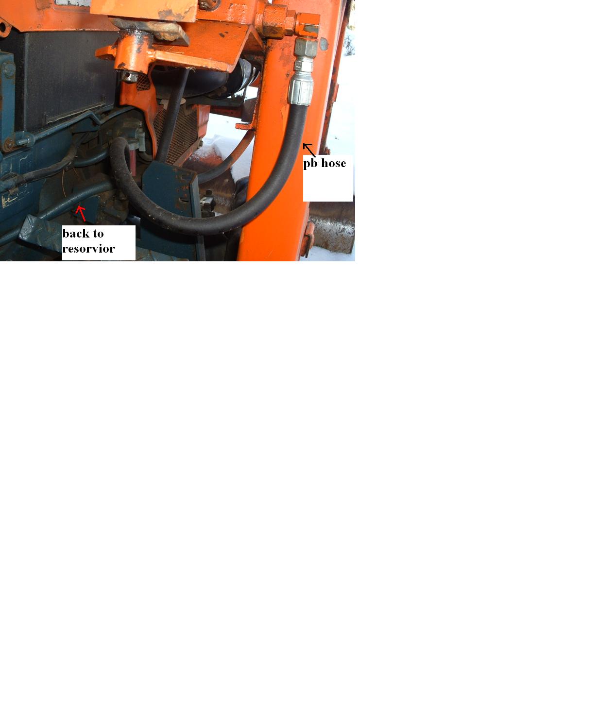

Okay, more pictures of my bad plumbing for your entertainment :)
Here's a shot of the pressure line entering my loader control valve (selector valve barely visible below):
And here's the return to the gearbox side (obvious from the heater hose and clamp, I think):
Note that it says "OUT" on this side. That's why I hooked it up this way. Seemed reasonable at the time...
That thing on the right, closest to "OUT" is what I've been assuming is a pressure relief valve.
Here it is with the cap removed:
I'm hoping for some opinions:
Did I hook up the valve backwards?
Is that thing a pressure relief valve?
I didn't take it apart any further than shown because I didn't want to risk screwing anything up. That cap/locknut/screw setup looks very adjust-y.
Thanks for all of the feedback so far!
/chris

I think you have it hooked up backwards. On everything I've seen, the relief valve in on the input block, and when activated diverts to the output. The puzzling thing is the "out" on the block. I can't explain that.
If at all possible, I'd put a gauge on the system after the pump and before anything else. Then very gingerly activate your hydraulics to test it. Your relief valve may just need adjusting too. It sounds like until now the backhoe relief valve has been doing all the work. If you note the position of the relief valve screw, then back it off counting the number of turns or half turns, you will be able to get back where you started.

The thing with the screw must be either a relief valve or flow control. I'd bet it is the relief. You could take it off and see how it is ported. That should tell you.
In any case, when it is fixed, I'd switch to all UDT. There must be a reasson kubota changed it. Maybe cold WX. As John Bud mentioned, viscosity can cause extreme pressures.
First though, you have to figure out if it is backwards. Expert opinions?

Good pictures are always helpful. It looks like both sides of that unit can be removed and swapped. So you could remove the relief valve and put it on the other side where I think it should be. Maybe not all valves are built the same but mine flows from left to right with the inlet on the left and the outlet on the right. Yours looks like it's made to allow the stacking of more spools. I think someone hit the nail on the head when they said the hoe relief valve was doing all the work. I have pics of the setup on my b6100 on this thread: http://www.tractorbynet.com/forums/kubota-owning-operating/70830-b6100-picture-3.html
/ Onboard Hydraulic Grenade
#31
Can't do that. The side I'm currently using as "IN" is only tapped on one end. The other end is a closed casting:
Almost certainly that's the case, but I'm not clear on the reason. I'd been assuming that it was because the hoe's relief was set a few PSI lower than the loader's.
But I'm still not positive that:
  1. I have a relief valve at all (What is that thing?)
  2. If it is a relief valve, that it's functioning correctly
Hopefully somebody will chime in to tell me that it is a relief valve, and that I'm just a knucklehead for hooking it up backwards. :)

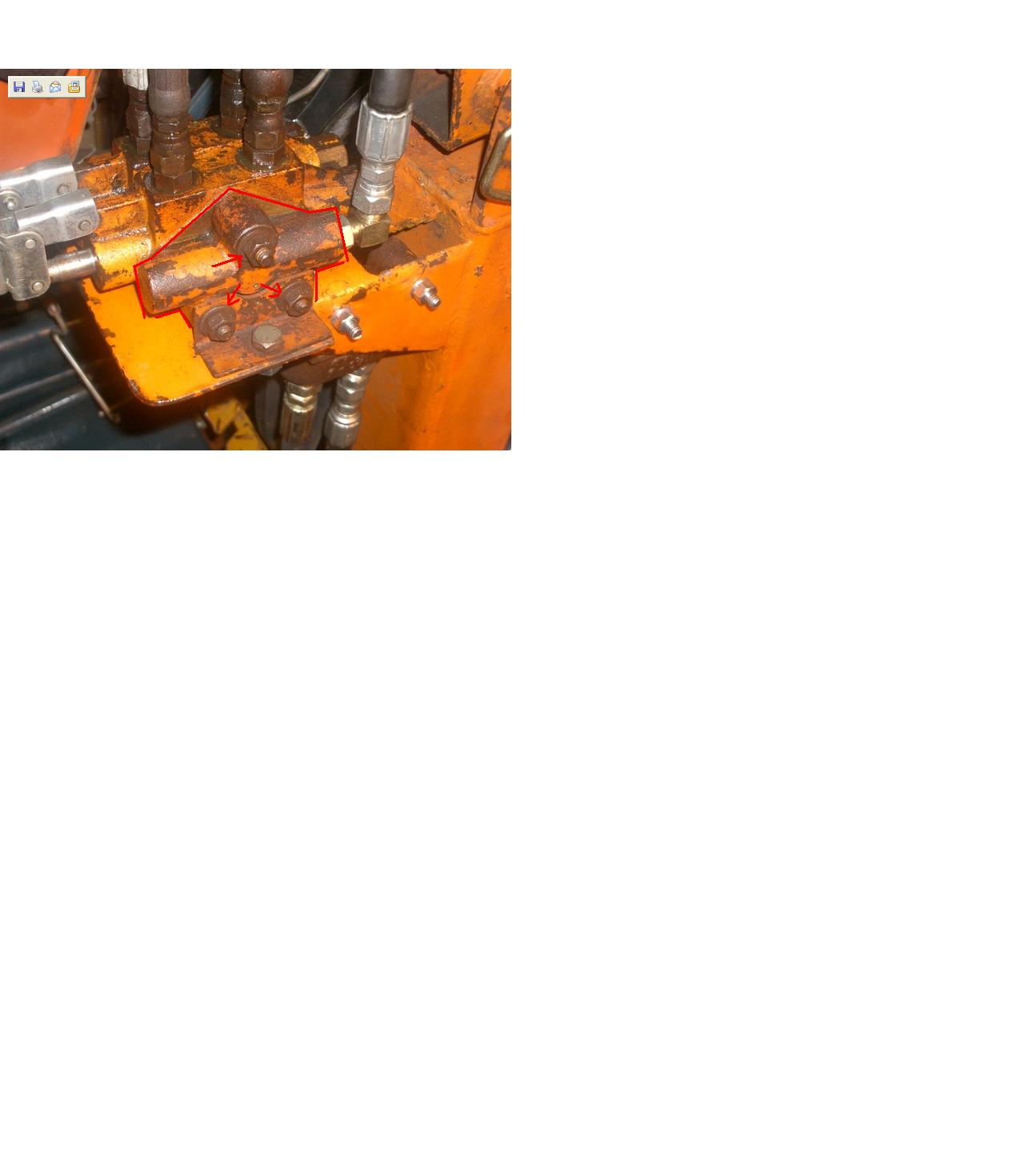

I don't think you get my meaning when I say they look like they can be swapped. The first picture shows your valve setup. The part I outlined in red looks like it could unbolt by removing the 3 nuts and swap with the same piece on the other side. Maybe it's the picture but it looks like there is a gasket there.
Now in looking at mine I see a big difference. I have 1 in hose and 2 out hoses. One comes out of the power beyond and heads back to the block to feed the 3ph. The other dumps right back into the resorvior. You only have one dumping out, maybe it doesn't matter but I figured I'd mention it. Pics below, sorry they don't look quite as nice as yours. I can e-mail you the higher res ones if you like.
Lastly, if you look at the picture I posted in another thread you see that I too have a large bolt thing on the left side. When I took it apart a couple years ago I realized it was not a relief valve, I don't think yours is either: http://www.tractorbynet.com/forums/...d1136338821-b6100-picture-800629-dscf0068.jpg

I finally took apart the adjust-y looking hex thing on my loader valve. Here's what I found inside:
Here's where that came from:
The needle/cone shaped thing on the left seats in the end of this bore:
Straight through that bore, we're connected to what should have been the pump.
When the needle is seated (by spring pressure), it stops fluid from flowing into the hole on the right side of the bore:
That hole leads to what should have been the return-to-sump line.
So, it's pretty clear that
  1. I do have a pressure relief valve
  2. I had it hooked up wrong
Finally, I've followed john_bud's excellent advice, and tested my selector valve to be sure that it doesn't have a closed center behavior midway through its travel, possibly costing me another pump.
I ran some compressed air through it while slowly changing positions. Luckily, it does not behave that way. There's a point midway through its travel where both output selections receive flow.
I was a little worried about getting the pressure relief set correctly, so I counted threads, etc...
But I don't know if it was ever right to begin with. So I plan to set it fairly loose, and tighten until the loader can lift 13 bags of wood pellets.
/chris
