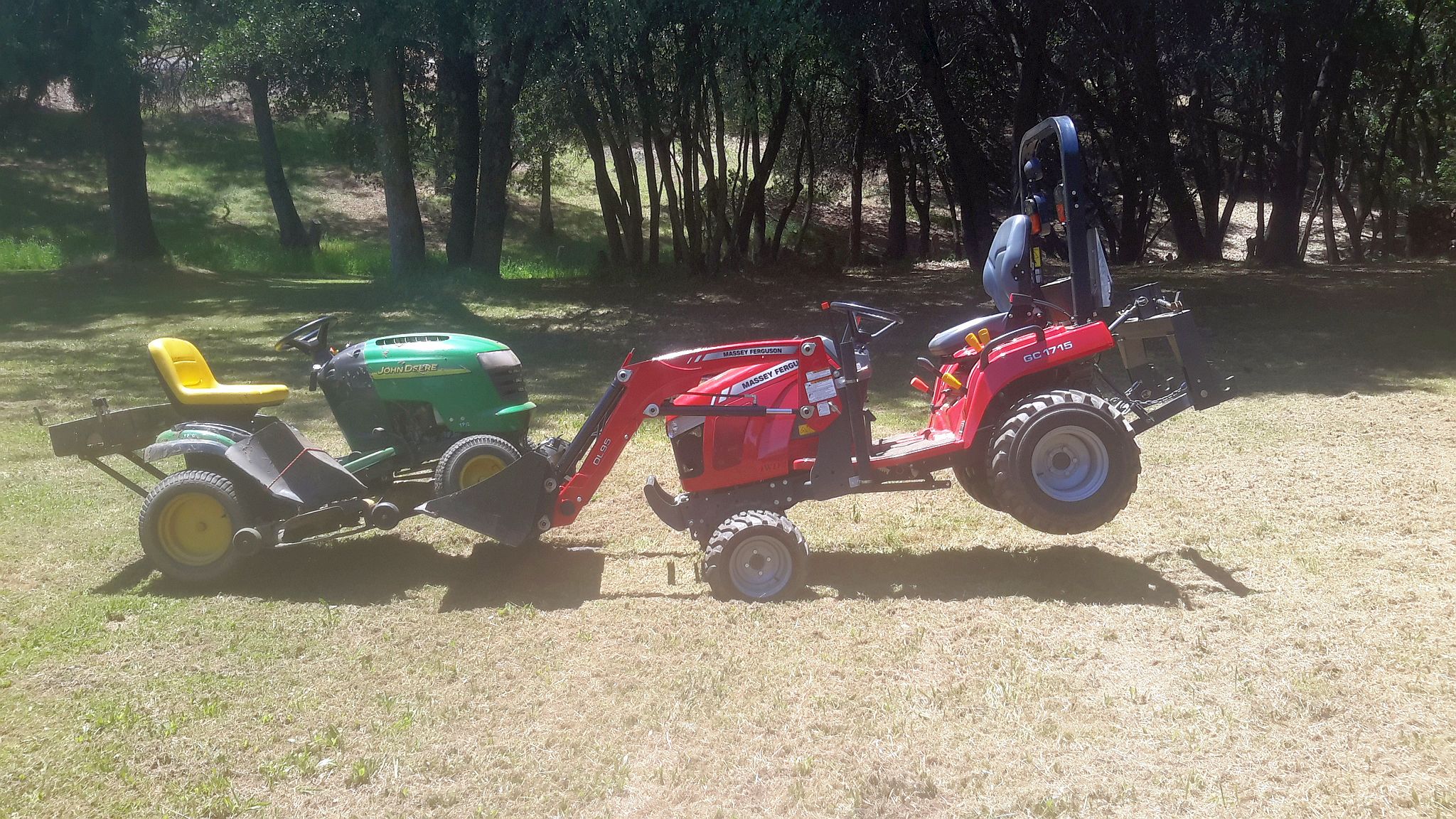

My wife has told me I'm not a great listener, what if I don't hear the tractor until she screams? :laughing:
You proved her right in post #13. :D

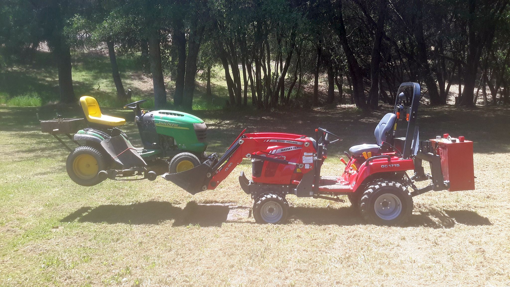

Ballast is 2' x 2' x 1' (4cu ft) and weighs in between 500-600 pounds
Dale

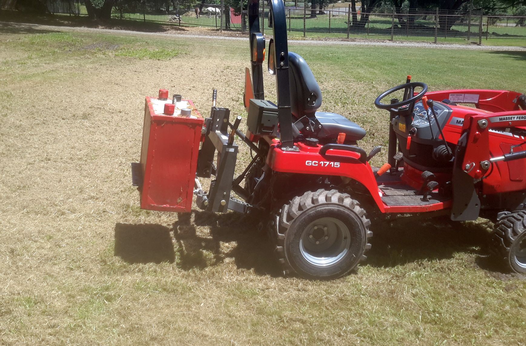

I have a JD 2025r and my opinion is JD is on the heavy side for ballast needed. I don’t remember the exact numbers but something like filled tires with 700 lbs of rear ballast. I have about 400 lbs in my ballast box and it seems fine to me. They do make ballast box extenders for some boxes that adds several inches around the top. I’ll join the club and say try what you have to start.
   / On the subject of ballast #24
This is a very cool idea. I had been thinking down the path of just buying one or two more ballast boxes, to load at different weights, but that creates a little storage headache. Your solution solves that, but is harder on the back than just backing up to a different box with a quick hitch. Both options to consider...
It's only hard on the back if you lift them manually ;) .....and what size weights/objects are being used. A core 700lb ballast box + ten 40-50lb weights/bags/etc would put you at (or above) 1100lbs.
Alternatively if you wanted to get fancy; additional weight boxes (potentially even just filled with concrete) on casters (or dollies) could be rolled up next to the core ballast box & attached (by whatever means) with no/minimal lifting needed as the 3pt.
....and there's also the route of a carry-all like was mentioned in post #20 by Imold.
Just me, but personally I prefer not to have a whole lot of weight (beyond what is needed) because it's all additional weight that the brakes/engine has to stop ..... which on my flat terrain means there's times I'll move light materials (e.g. mulch, aged manure/compost) without having anything on the back other that the wheel weights. ...again just me, as I tend to keep my hand by/on the loader controls to drop the whole load if/when needed.

All good suggestions, just double or triple the sub-compact size numbers of the last few posts. Remember loader has a lift capacity of 2125 lb with a reach of 59 inches, easily double or triple some of the machines used as examples in the last several posts. But it’s mounted on a machine with a base weight of only 2900 lb. and wheelbase of only 68 inches, making it darn near a seesaw... a 6000 lb. seesaw with a full load, before adding ballast. This is my third Deere loader tractor (previously 750 and 855), and it is by far the most tippy of the three, more than 230% that of the 855, when looking at lift x reach vs. weight x wheelbase.
The total ballast Deere spec’s for this loader on this machine is right around 2000 lb. If taking the proposed 700 lb. box and adding 40 lb. suitcase weights, I’d be looking to add 32 of them for the heaviest jobs. Superbly flexible, but that’s an awful lot of weights to purchase, move, and store. I think I’d be better off just having two or even three different ballast boxes of different weights, definitely more convenient and easier to change weight, when considering the number of weights I’d really need on this machine.
At this point, I’m down to two options, both of which would have me keep my 700 lb. ballast box for a lot of the lighter work, and buying bigger boxes for heavy work:
1. Put 400 - 500 lb. on the rear wheels, either liquid or iron but not both, and buy a second ballast box to load around 1500 lb. This won’t be a Deere ballast box, they don’t make one that big in cat.1, but I believe some others do.
2. Skip the wheel weight, buy that same 1500 lb. ballast box, plus 15 x 40 lb. suitcase weights. This would allow me to drop all weight for lawn jobs (I do a lot of yard work with loader removed), and load up with 700, 1500, or 2000 lb. on the 3-point as needed. Unfortunately, it does very little for my side-hill stability when loaded. It also means I’ll have to continue removing the loader to pull small trailers in 2wd, I presently can’t even get up the hill that is my back yard without either going into 4wd or removing the loader, my rear is just that light.
My gut is telling me to go with option 1, but I’m receiving advice from other channels to go option 2, from some who know my usage patterns, and have substantial experience (Deere dealer, Deere mechanic, and golf course equipment manager). I do have a lot of hilly terrain right around the house (we’re up on a small bluff), which means a lot of side-hill work when mulching gardens and moving my wood trailer around from the wood lot to the house.
Think we may have had a miscommunication as I wasn't intending to suggest taking the ballast box to 2000lbs - just to the manufacturer's recommended 1100lbs (or slightly beyond).
I'd always recommend adding at least some weight to the wheels (either liquid, iron, or both) in order to keep the unladen tractor (with loader attached) safely balanced without the use of a rear implement. This also keeps some of the ballast weight off the rear axle as weight on the wheels is usually carried on the wheel itself.
So the recommendation of making the current ballast box selectively heavier was intended primarily to avoid having multiple ballast boxes (and having to shuffle tools between them). In other words, basically option #1 but using add-on weights to take the current ballast box to 1100lbs -- or up to 1500lbs (if possible/wanted/etc).
Personally I would avoid the option of not having any weight on/in the tires. Experience has taught me the rear end can get light when the tractor isn't actively carrying the attached 3pt implement (i.e. the 3pt implement is down and being used rather than carried). Wheel weights can be removed if the loader is removed, liquid can't (or not as easily). However, both iron and liquid are good options.
However, ultimately it's your money, time and choice to make and all the rest of can do is offer options/suggestions.
