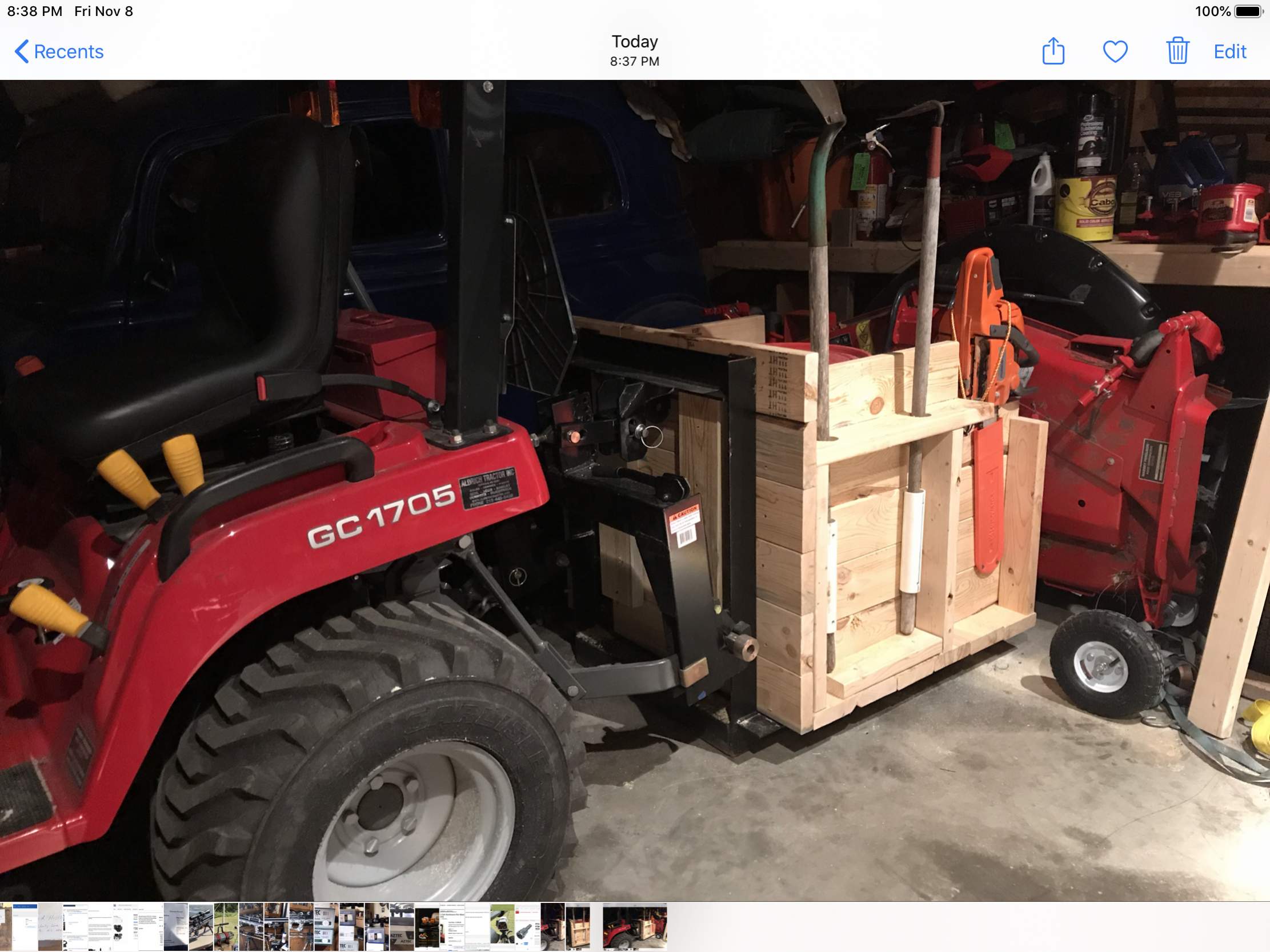

I only have a scut but realized I needed some weight in the back when moving class 5 gravel so I built this box with a removable 30 gal plastic barrel that I can add water to or sand for weight plus I can haul tools and without the barrel in there is a lot of room for other things even different types of weight(s) to customize it.
