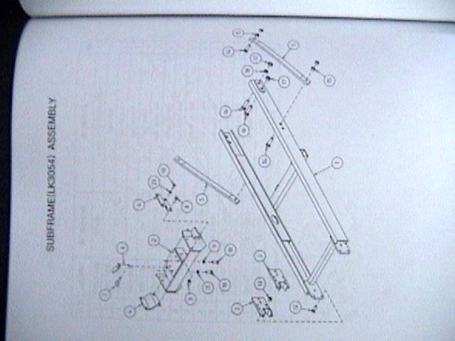

I have an LK3054 that I'm looking to buy a backhoe for. My question is can anyone tell me or post a picture on how the sub frame that Kioti has connects to the back half of the tractor. And has anyone used or own a Koyker backhoe (made by Kelley) if so how was it.

Hi,
I have tried to attach a pic of the LK3054 sub-frame out of my kb2385 Backhoe manual. Looks like there is a little difference in the sub-frame depending on the tractor model. Look at my other posts for an attachment that shows the hoe I have for the DK-45. The pic shows the hoe setting on the ground after removal from the tractor. Sorry about the quality of the pic attached, I couldn't scan the book, had to snap a shot with the camera.
Nelson

Thank you Nelson for the picture it came out good and does show me what I was looking for. Is that sub frame and mount on your set up strong enough that you can lift the tractor off the ground ? And if your digging off to the side of the tractor do you get any sideway movement/flexing in the sub frame ? Thanks again for your help.

<font color="blue"> The sub-frame is plenty strong enough to lift the tractor. When I am digging stumps and need a bit different angle, I lift the stabilizers, use the boom to pick up the rear wheels, and use the swing cyl. to set the rear of the tractor to the side. I know it isn't recommended but it is a trick I learned a long time ago and can't seem to give it up. Also, the other day I got myself into a huge pile of limbs and stuff pushing up a pile and didn't see a low stump which promptly hung me up by the frame under the hoe. The loader bucket curl wouldn't push me off it, so I used the little swing trick there too. It worked slick. Scooted right off the stump and drove away.
When digging, you can hear and feel the sub frame shifting around a little bit within the bracket. It has to have some play in it for ease of install and removal. It isn't a problem.
By the way, watch the hoses close. I thought I was but still got a scrape on the bucket extend hose where it goes through the boom. I am going to try for a warrantee claim. It shouldn't be that tight and or the opening that sharp. Shouldn't have any wear with only a couple hours on the hoe.
I hope this info has been helpful.
