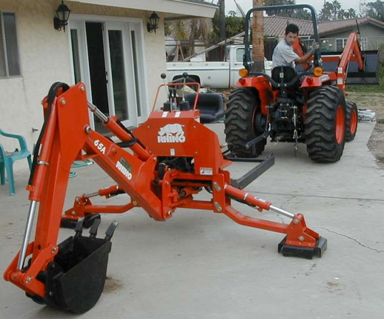

On the Kioti KB 2085 backhoe on a DK 35.
Does the subframe remain on the tractor when the hoe is removed ?
Do you loose the tow bar ?
If the subframe remains with the tractor does it stick back from the machine any farther than the tow hitch ( my brush cutter comes very close to the tow hitch) ?
I am considering a backhoe in the future and reveiwing my options.
Thanks

here's an LK2554, should be the same

   / ? on the KB 2085 backhoe
Thanks,
That helps give me more of an idea of the subframe.
The hoes look nearly identical so the subframes my be also.
Does Rhino build the backhoes for Kioti or have the same MFG ?
I went to the Rhino website and the specs on the hoes shown on their site exactly match the Kioti KB 1440 , 1550 and 2085 hoes.
   / ? on the KB 2085 backhoe #4
On my LK2554, the hitch bar and 3pt hitch arms can stay in place when mounting the backhoe. The sub frame stays on the tractor when removing the backhoe. Pull 2 pins, remove pump from pto and drive away.

   / ? on the KB 2085 backhoe #6
on the DK 35 the subframe will come completely off when you take the backhoe off. the 3-pt arms and hitch stay on the tractor.

   / ? on the KB 2085 backhoe #8
I have that BH on my DK45. The first time I took it off it only took a few minutes. As you probably know, the 2385(new number) hooks up to the tractor hydrolic system and doesn't have a PTO. Two pins, stablize the hoe, drive forward, lower the sub frame with a boom adjustment, unhook the hoses, and drive away, slick! It will be even easier next time.
