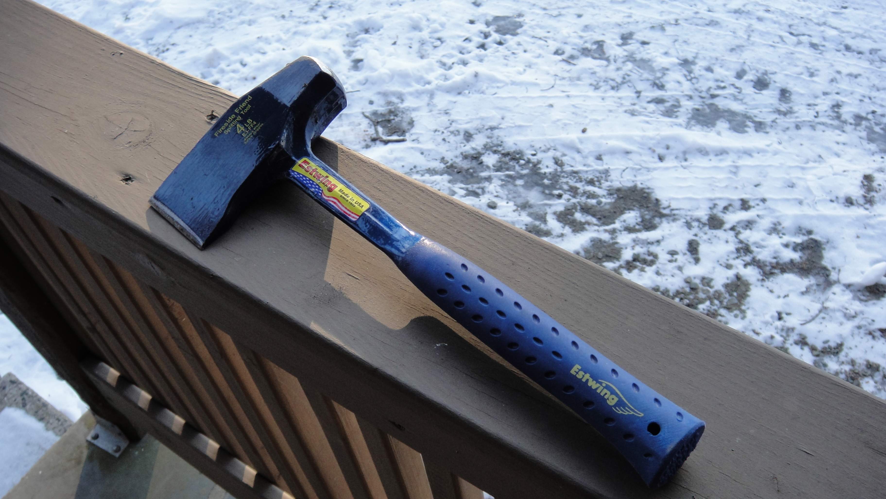

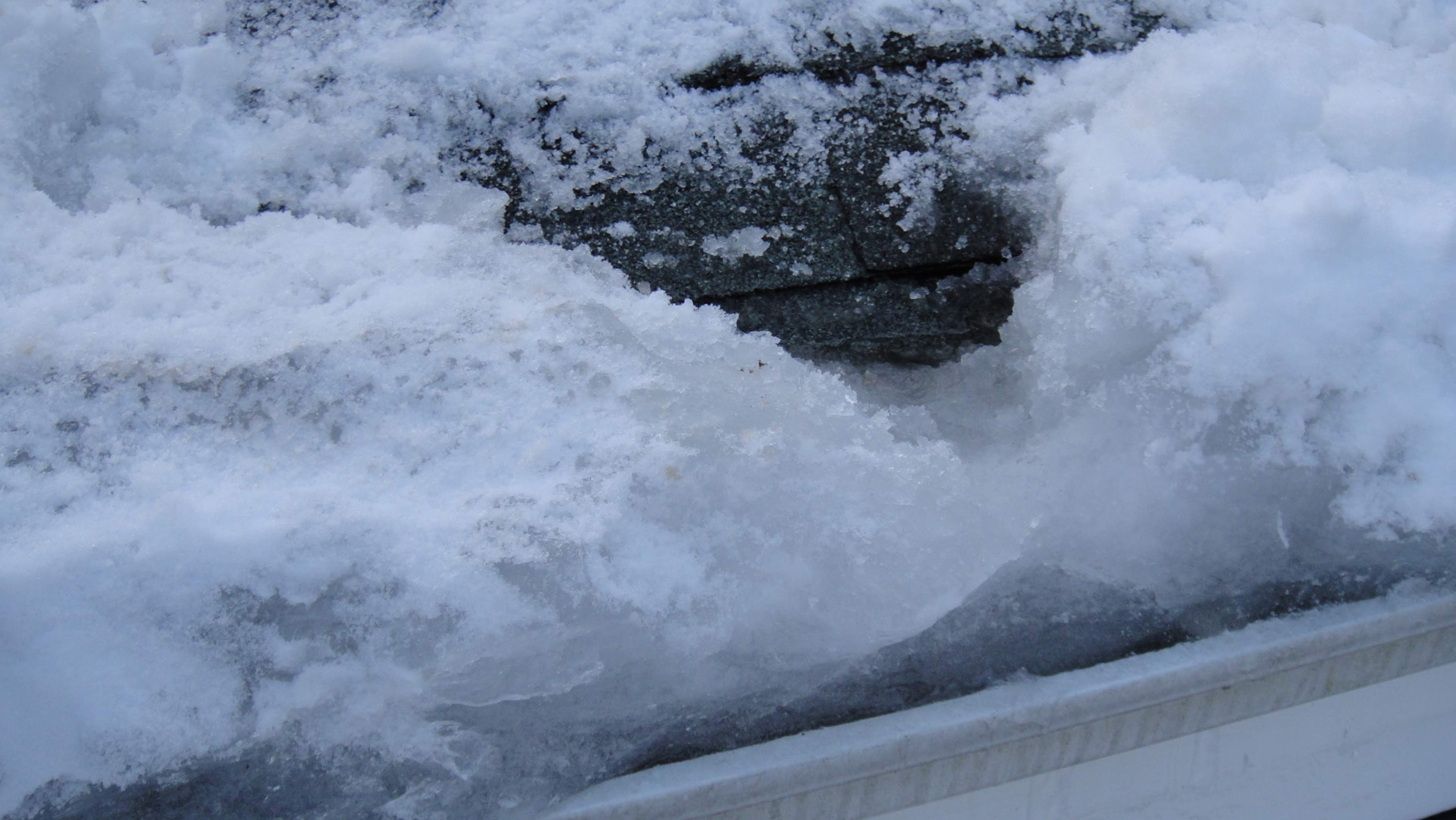

Well I'm another John in CT and my upper body has been getting a good work out. So sore I need some Ben Gay
Some pics of my ice problems. The 4 lb hammer I bought for breaking concrete basement floors, needed it for the ice.

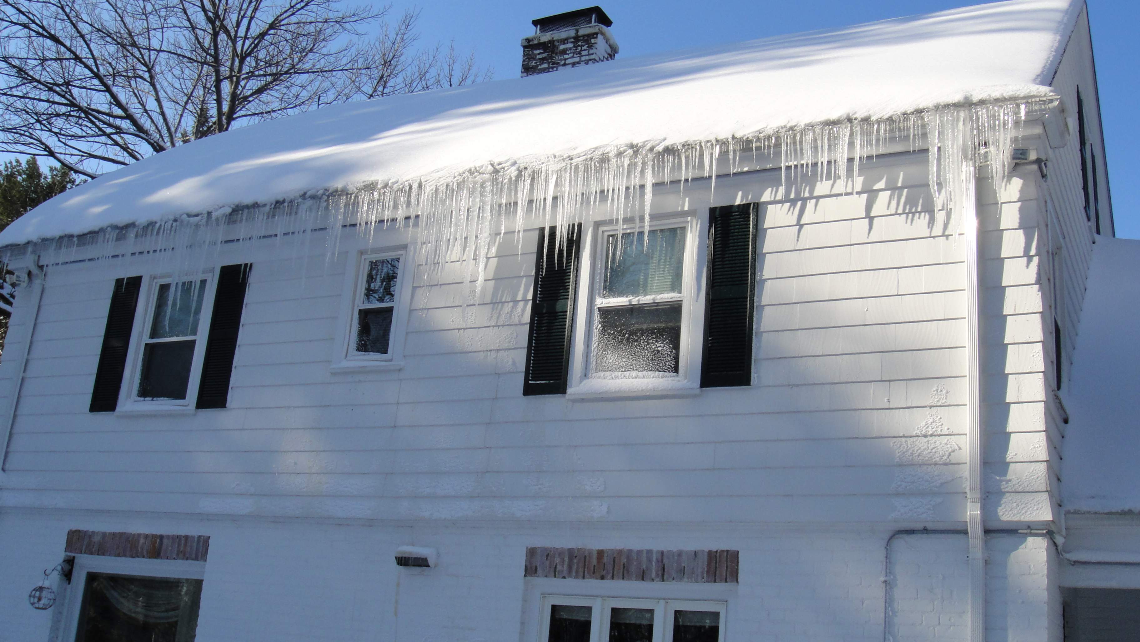

I also cleared what I could off of my house and garage roofs this weekend but I'm powerless to do anything effective for the ice dams. I did use a hammer and chisel to cut some groves for the melt water to run off but after the warm up this past weekend, then re-freeze at night, they're all back to solid ice. Even tried a propane torch to remove some of the ice damns, but it was just too slow going. Any pearls of wisdom on removing ice damns? I'm getting worried about backup under the shingles should we get rain, which is predicted for part of this next storm. Pic is before I raked the roof.
You need to stop the heat thats melting the snow on the roof, to stop them from forming. It's usually an insulation problem. Sometimes recessed lights in the ceilings cause the melting. Don't know if that's a pearl of wisdom, it's usually the case tho..

I kind of figured that having looked at my unheated garage and seeing no ice dams. Worst of it is over my family room with a cathedral ceiling. It's suppose to have about 12" of insulation in the roof, but since there's no attic there's no way to check it. I've been thinking I need to remove the shingles at the lower edge of the roof, install that water and ice membrane, then re-shingle. Not a job I'd look forward to since the roof was re-shingled about 5 years ago. Didn't think to have that done then. Now I'm kicking myself.
You've got a good pitch on that roof, Chris, (looks like an eight on twelve by the pic) and short overhang, I doubt you'll have any trouble.
Actually after looking again, it doesn't look like you even have any ice damming, just icicles. There's no gutter, right?

Look at that hammer in my prev post, I spent all saturday on mine, solid ice as thick a a street curb. The trick is to not do damage to roof and gutter. You can get it off the roof cleanly with the proper technique, no way to get solid ice out of gutter without doing damage.
HTML:
As long as you open up some areas of the dam (every 2 ft) you shouldn't get any leaks, especially if you haven't had any so far.
My roof has the membrane along the eaves so I had no leaks inside, but the water was getting behind gutter and facia board and some brownish stains on wood shingle siding below. That's what convinced me that I had to remove the dams. Also to rake fresh snow off eaves in the future, you need that fresh snow for the dams to start. In 8 years I never needed to remove snow but now I will.
Someone here suggested putting ice melt on them. That sounded like a good idea to me. If it works on the sidewalk it should work on the roof. :)
I did use some ice melt, doesn't do much to 8 inch thick ice but it does help if you get the ice melt to run under the dam from above/behind it. makes it possible to get a clean release from the roof, but you still gotta pound the ice with extreme prejudice
