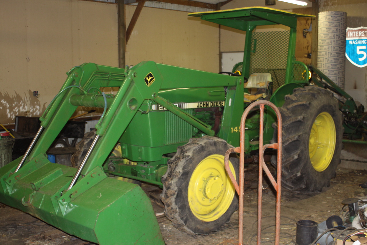

I have a Deere 2240 4x4 with loader (50HP at the PTO) and love it. It's smaller brother is the 2040. These are going to be 25-35 years old though. I paid $7500 and it came with a disk, 8' rear blade, 7' landscape rake, and mounted duels plus extra tires. It's needed a little work which I'm plugging away at, but it runs strong and has been usable from day one. The deals are out there if you're willing to look.
