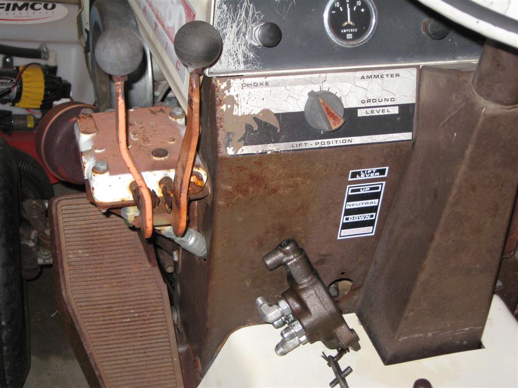

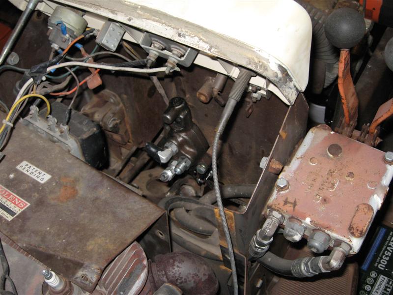

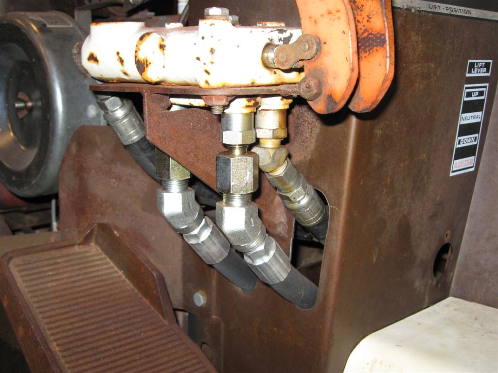

Does anyone recognize this two spool control valve? It was on the garden tractor when I got it (obviously an add-on). One port was blocked off and the other was used in place of the original "lift" control valve on the garden tractor. I found a replacement control valve for the "lift" and used the dual to add quick disconnects to the front and rear. I used the front quick disconnects for about a year as a snow-blade angle control with a dual acting cylinder. All worked well until the cylinder started acting up (or so I thought). Had the cylinder rebuilt and same thing (very slow to react). Tried a different cylinder with the same results. Would it just be the relief valve opening up too soon? Since it used to work and suddenly didn't any more, I'm guessing a broken spring or seal gone bad maybe? Haven't tried taking it apart yet, was hoping there might be a diagram out there somewhere. Oh... the garden tractor has two other control valves (singles) in series with this dual and they still work fine, so I know the pump is still good.
Thanks
-Neil

That's a Cessna control valve........the pressure relief valve spring is under that non-adjustable cap....
best to get a hyd guage to find out the pressure setting, then take apart the PRV and inspect the spring and poppet......to increase pressure a shim may be needed (installed between the spring and cap)

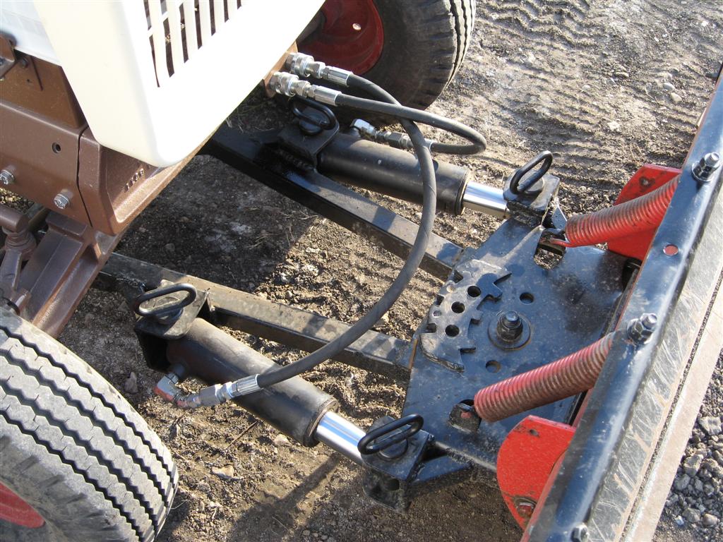

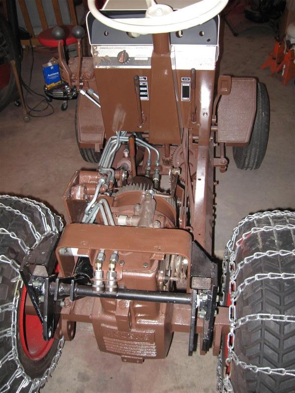

I won't be able to get readings at the pump any time soon. It's too close to snow season to start tearing into my spaghetti mess. I'm wondering if 800 psi is all I've got through the whole system (pump is part of the Eaton 12 hydro unit on the Bolens).
From the hydro it goes directly into an add-on control valve that is mounted under the seat-pan (controls the 3-pt hitch). Then on to the dash-mounted control valve (controls the deck lift), and then on to the dual control valve to the left of the dash (front and rear aux quick disconnects) before dumping back into the hydro. The two Bolens control valves are connected to standard dual-acting cylinders (2" bore x 6" stroke). I've re-tested both front and rear aux with an extra dual-acting 2" bore x 3-1/2" stroke cylinder, and with no-load it seems plenty fast both front and rear.
Maybe my snow-blade angle configuration (a pair of single acting cylinders) is just too much for it.

My guess is that the pressure relief on the dual spool isn't even activating (if there is only 800 psi to work with). Or maybe I've just got too much air in the cylinders. Or all of the above?
Either way, I'll probably just grease up the plates at the pivot point and loosen it up as much as I dare, and try bleeding the cylinders again.
