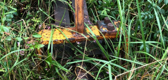

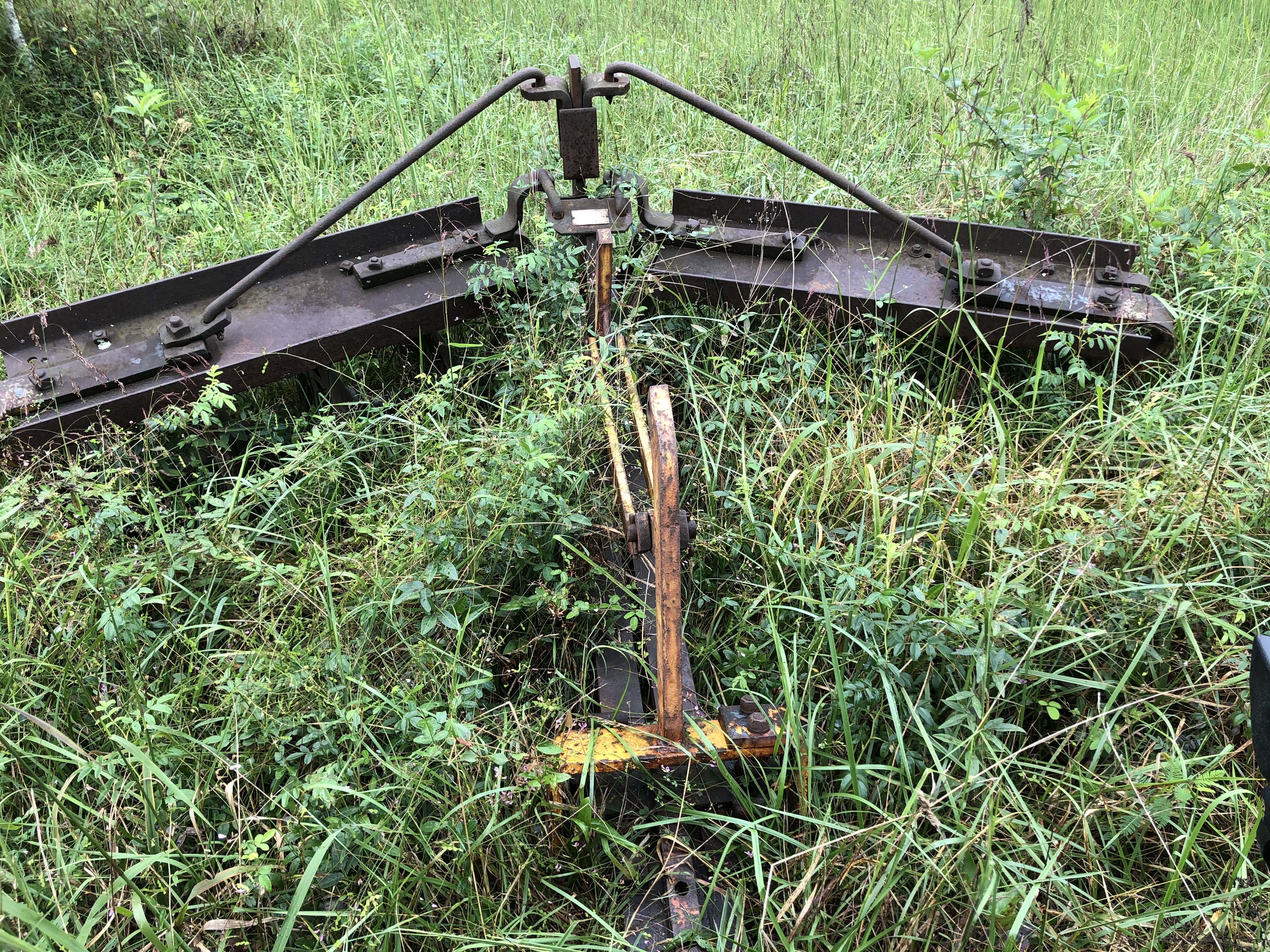

Sep 4, 2020 / Old Taylor Way Bog Harrow? #1 I inode Silver Member Joined Sep 4, 2018 Messages 107 Location Tennessee Tractor Kubota M7060HD12 I was given the implement below. How do I set the discs so that they bog (v-shape) instead of just cut (straight)?
Sep 6, 2020 / Old Taylor Way Bog Harrow? #2 kneedeep Veteran Member Joined Apr 16, 2012 Messages 1,685 Location AL Gulf Coast & MS Delta Tractor Mahindra 3510 & 8560 inode said: I was given the implement below. How do I set the discs so that they bog (v-shape) instead of just cut (straight)? View attachment 668604 View attachment 668605 Click to expand... Looks like it is fixed and cant be adjusted. Drag it out & take more pictures.
Sep 7, 2020 / Old Taylor Way Bog Harrow? #3 Tx Jim New Member Joined Jan 26, 2007 Messages 10,400 Location Coyote Flats,Tx Tractor JD 4255/Kubota M7040 HDC On those type of implements the angle or straightness of disk shafts is determined by where the bracket in photo below is positioned on center hitch. Attachments Annotation 2020-09-07 055144.png 426 KB · Views: 160
