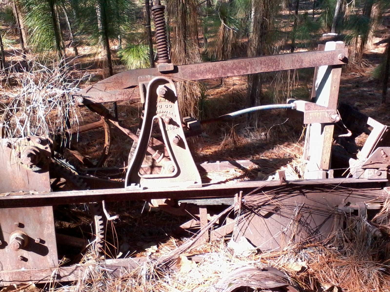

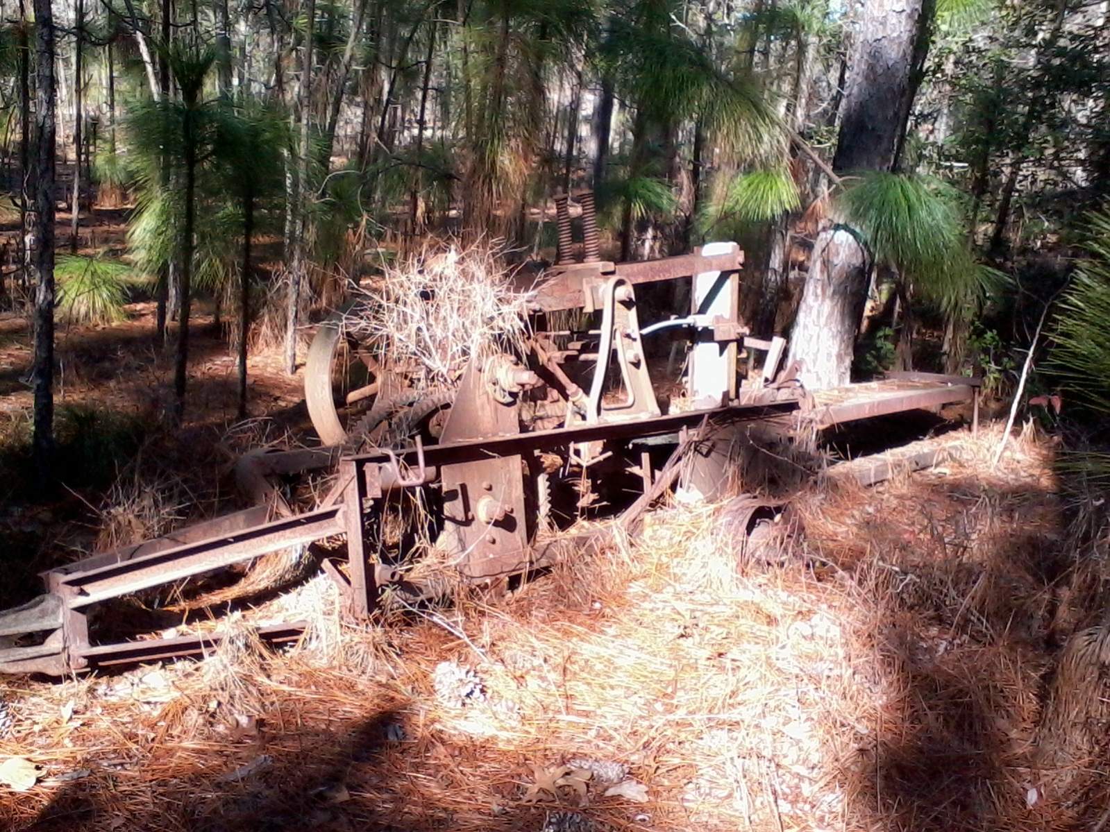

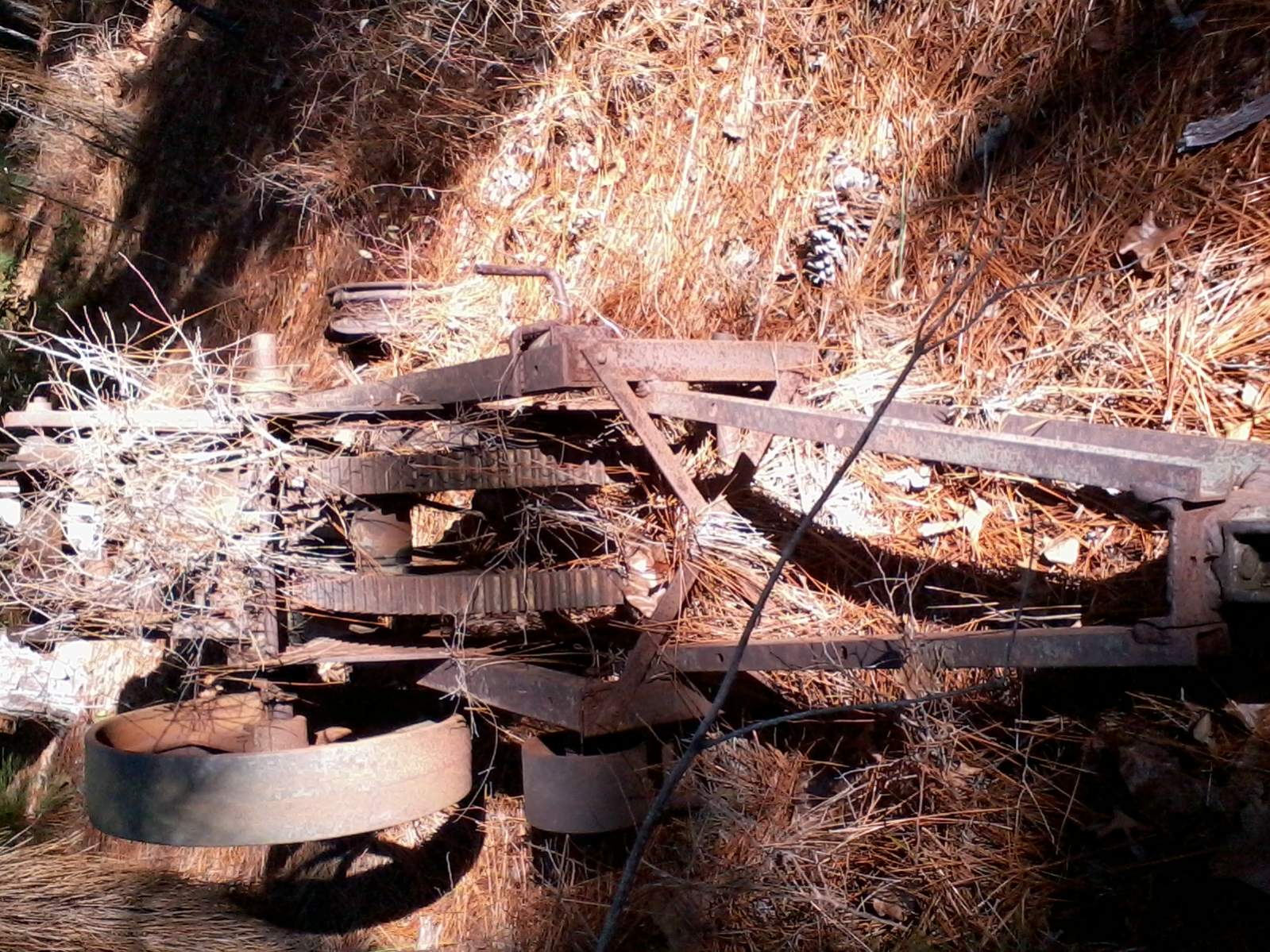

Found this in the woods in one of my timber sale areas. I'm guessing its an old square bailer. IT still has old bailing wire twited and ready to go on the side of it. This looks cool and wish i could get it out of there. Its really heavy built out of cast parts. Some pics to enjoy.

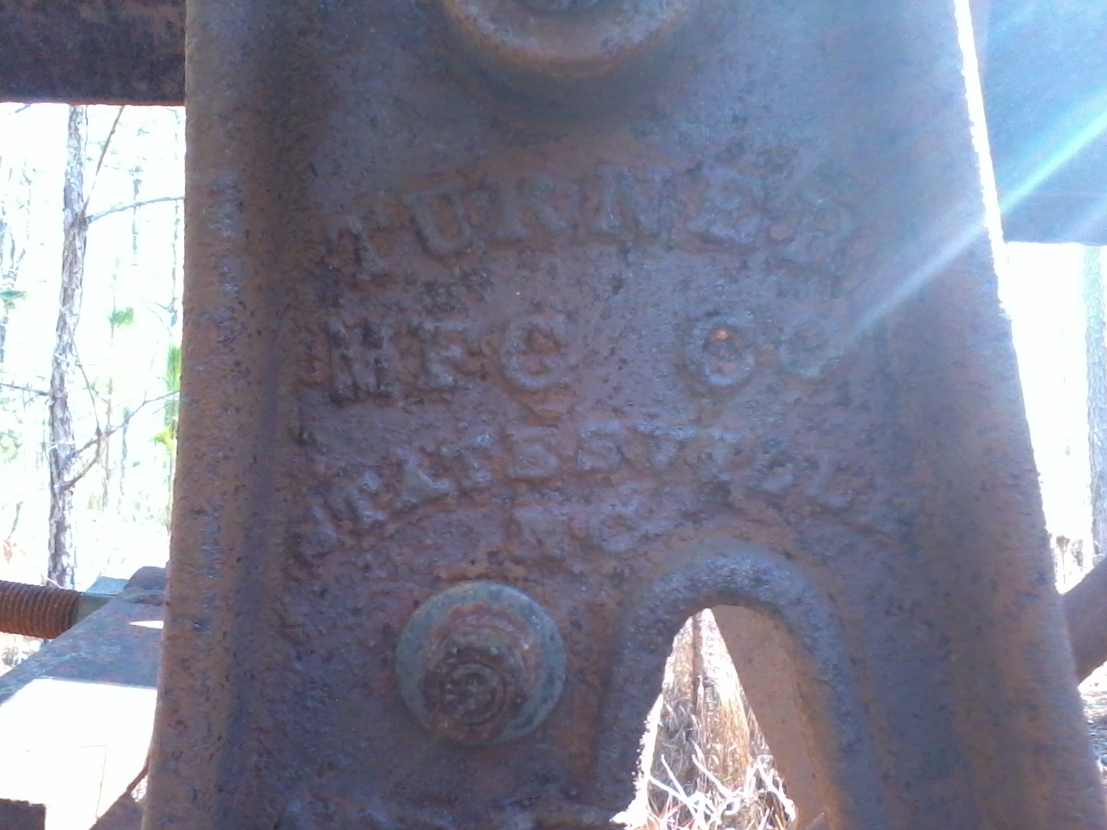

The last pic is right before my battery on my cell died. The other side had a shadow on it and you could not read it, but was better defined than this side. It reads "Turner MFG Co Statesville NC"

Agreed, it is a cool piece of history but if you got it out of there what would you do with it?? Just curious is all.

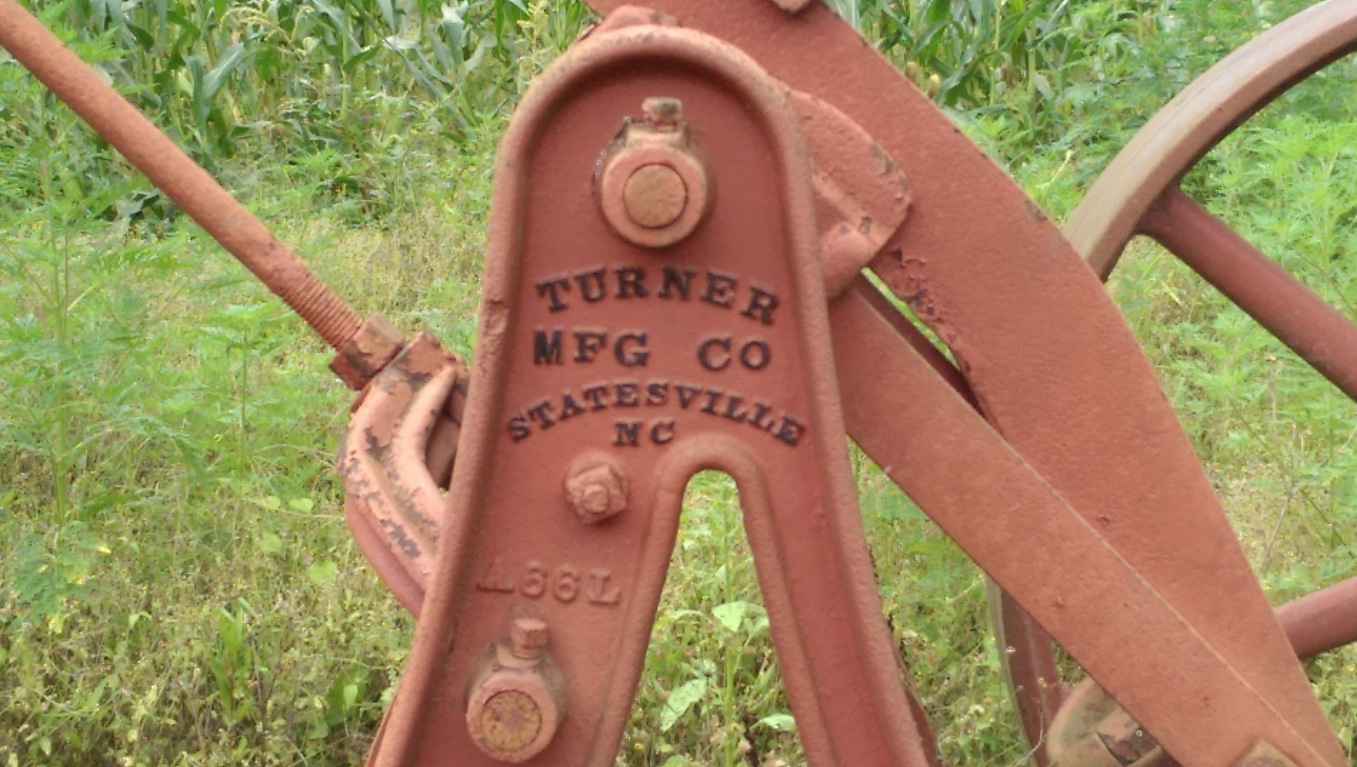

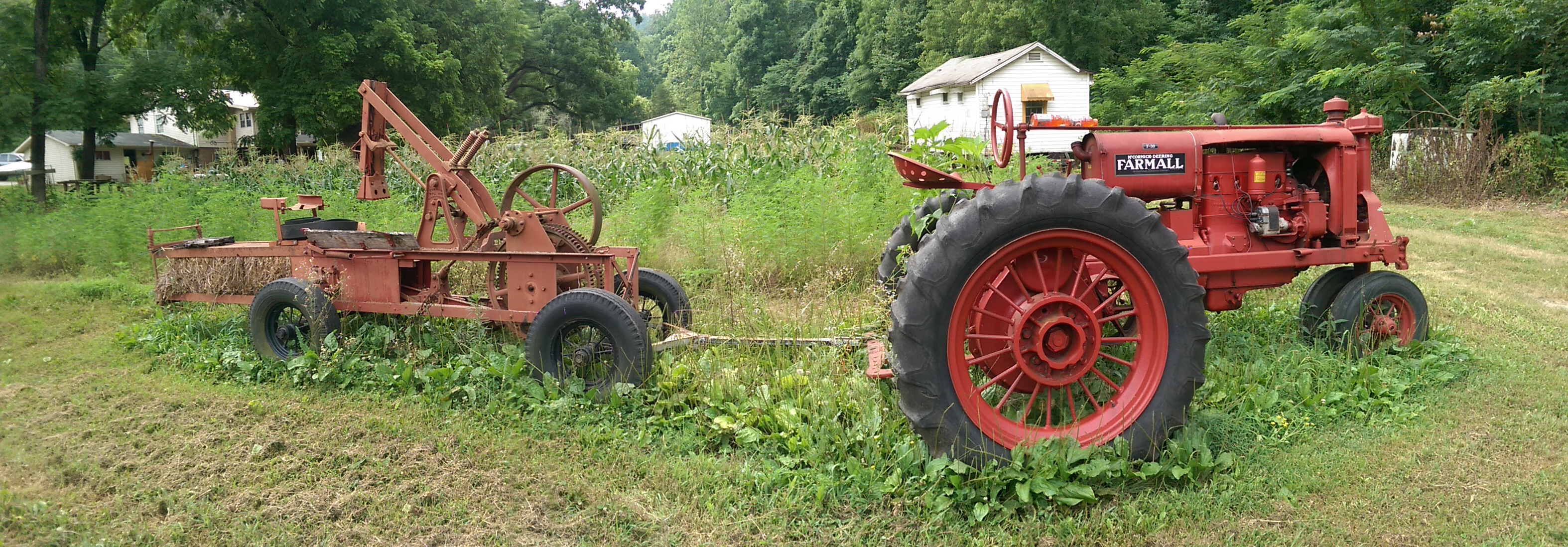

I just came across one of these, and the owner did not have much info on the history. He uses it for demonstrations in Townsend TN
