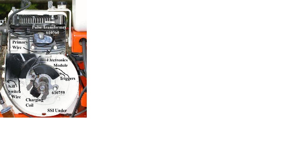

/ Old Sears Suburban SS12 #27
have a 12hp suburban tractor, but cannot find were the shorting wire goes and connects to. anyone with good pictures or good diagram would be appreciated runs fine just cant shut off thru key beacuse wirefrom ignition not connected to motor somewhere .
/ Old Sears Suburban SS12 #28
Do you happen to no what year your Suburban tractor is. also, what kind of engine is in it... does it have a PTO.

Mine is about a '72 or '73. It has the 12 HP Tecumseh. I haven't messed with it in a while, but with starting fluid I will get occasional "fires" but sounds like the timing is off. I haven't pulled the flywheel off yet to get a new woodruff key.
