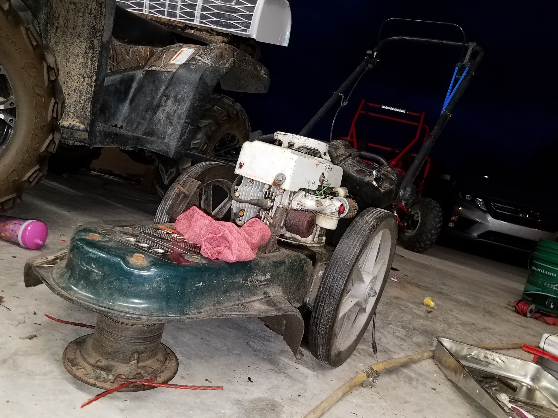

My wife's grandfather died, he was a small engine mechanic, has worked on tractors since the 60s. I was told to get whatever I wanted out his shop and wound up getting a wheeled string trimmer. This is something he was working on for a customer, either it was never picked up or he was having a hard time fixing it. I pulled the carb and cleaned it, the engine starts first pull, every single time. The engine comes up to speed and then immediately shuts off. After it comes to a complete stop I pull the starter once and it does the same thing again - Starts beautifully then stops. I can overcome the governor linkage on the carb with my hand and keep the engine running by manipulating the butterfly valve. Interestingly there is a throttle cable assembly installed on the unit but I don't believe it goes to this piece of equipment. When I got the trimmer, the throttle adjustment was present on the push-handle but the cable was just hanging. He may have been trying to run the engine without the governor, directly connected to the throttle? Or possibly I am wrong and there is something else going on entirely. Can anyone point me in a direction?
Numbers off engine shield - 143294032 SER-9032E
Numbers off trimmer unit - 536.7735100 Code: 9112062922
Any help is appreciated. Thanks!

Symptoms lead to not getting fuel after the initial prime. Sounds like a carb problem, Could be related to the bolt nut/jet. The other issues are you have a primer carb on an engine with a housing that says automatic choke. so we either have an engine that somebody has changed the blower housing which could cause issues having the incorrect model number for the engine, or somebody has put a primer carb on an engine that originally had a choke and possibly wrong carb jet size. I know the air filter isn't original to the engine. Also with the governor spring tab bent so far to stretch the spring makes me think there could be other issues as well.

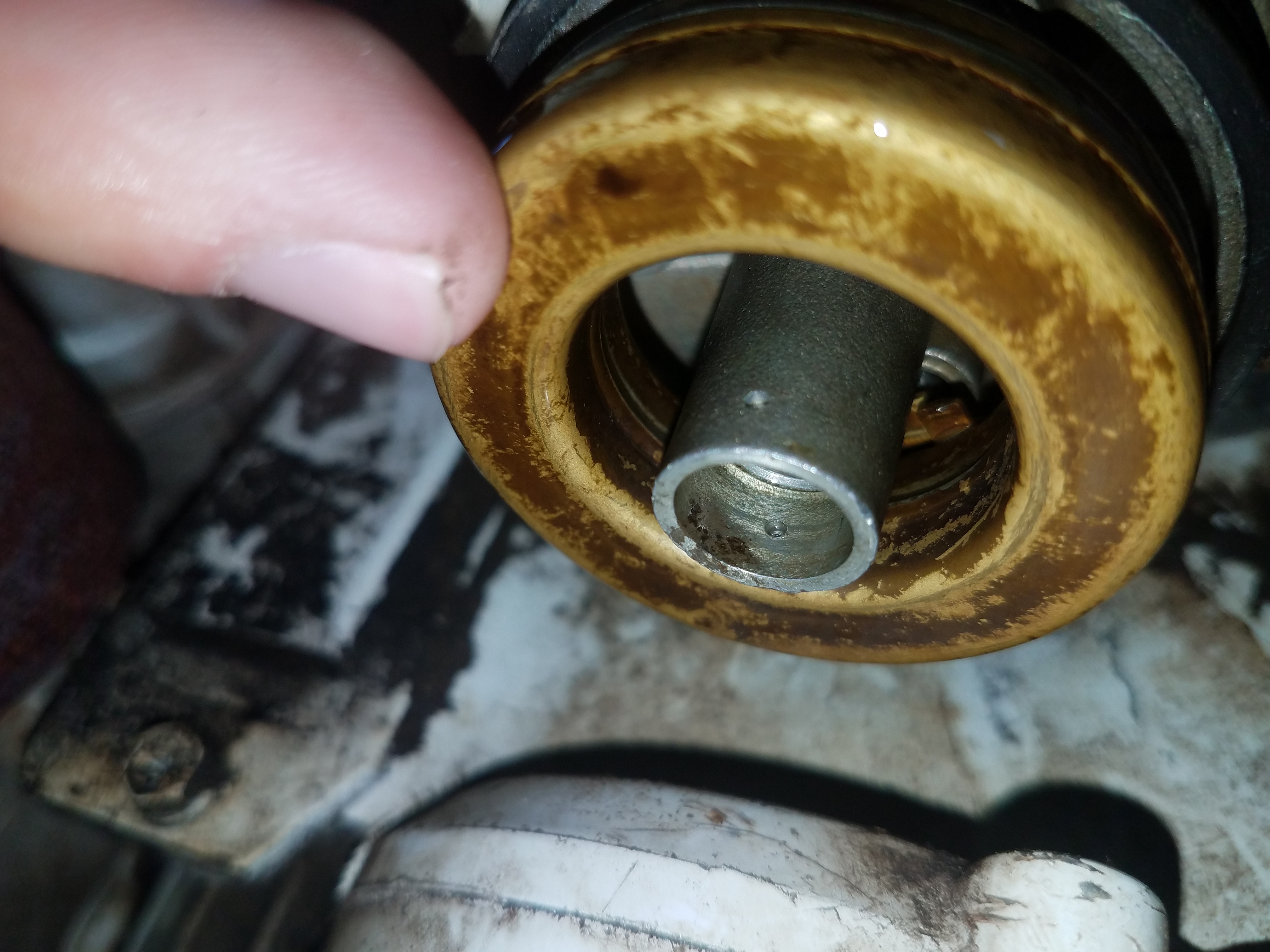

Thanks a lot for that reply. The main jet in the carb is massive compared to the other small engines I have around the garage. I used a set of welding tip cleaners in the carb ports, the main jet took the second to largest.
Any suggestions on where I should start? I'm assuming compression is good since it starts up so quickly. I can do a compression test if that would be helpful and report back. Would a video of what the governor is doing be helpful?

I don't remember the main jet in the nut being that big. I seem to remember that it is somewhat large as it enters the nut from the carb side, but tapers down considerable as it gets close to the bottom of the nut. Can you blow carb cleaner through the passages in the nut from both directions.
/ Old engine not running, Craftsman brush trimmer
My terminology may be off. I was referring to the diameter of the pickup tube or venturi being large. The orifice in the nut and the two orifices on the carb body piece it screws into are wide open.

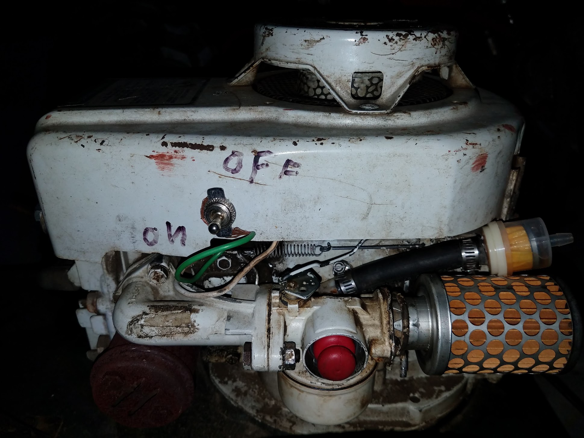

There is usually a long, not very strong spring on the throttle butterfly, that keeps the engine running at full speed. Once up to speed, the throttle `flap` under the casing then pulls the throttle butter fly closed so slowing the engine. I carn`t see this spring on your pictures. As the engine slows, the wind pressure decreases on the flap and the spring open the throttle a bit further. What then happens is the engine settles down to its normal running speed. To control this speed, another spring is attached to the linkage and the wire speed control. By increasing the tension of this second spring, putting more pressure against throttle flap, and the engine will then run faster.

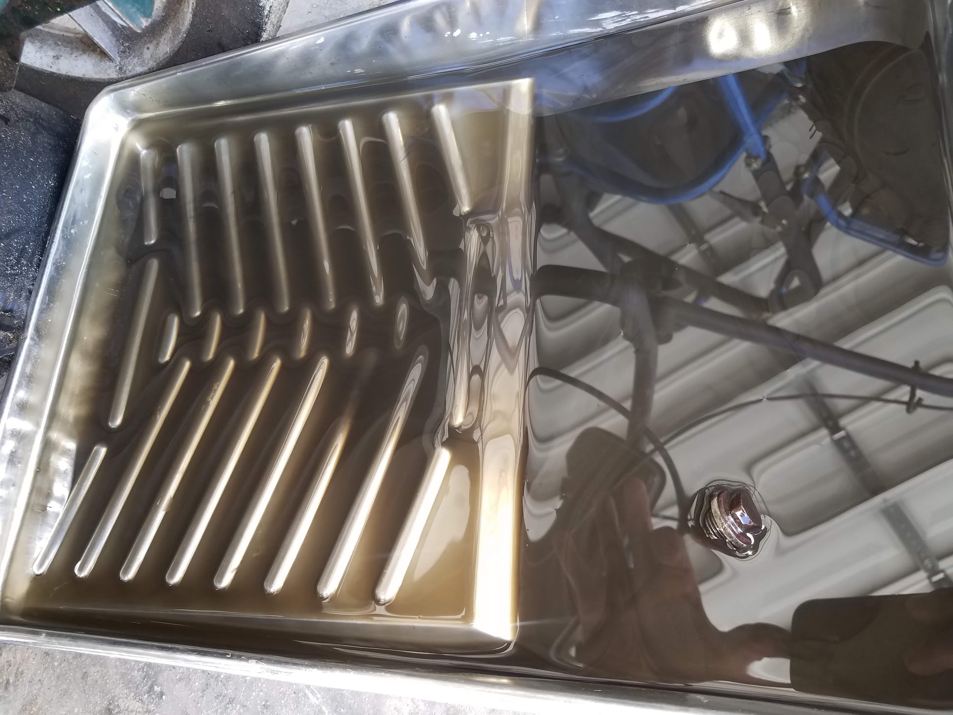

I drained the oil, it was the worst I've ever seen. I let it drain for an hour and then replaced it with new oil. I ran the machine but I couldn't engage the trimmer portion without the engine dying out. I found that if I put my finger over the hole on the primer bulb, the engine rpms increased. I put tape over the primer bulb and was able to trim some weeds. I let the engine run for around 10 minutes then drained the oil again.
Sadly the second drain is pretty bad, too. The drain plug was covered in sediment, I imagine that after a couple hours of running I'll change it one more time.

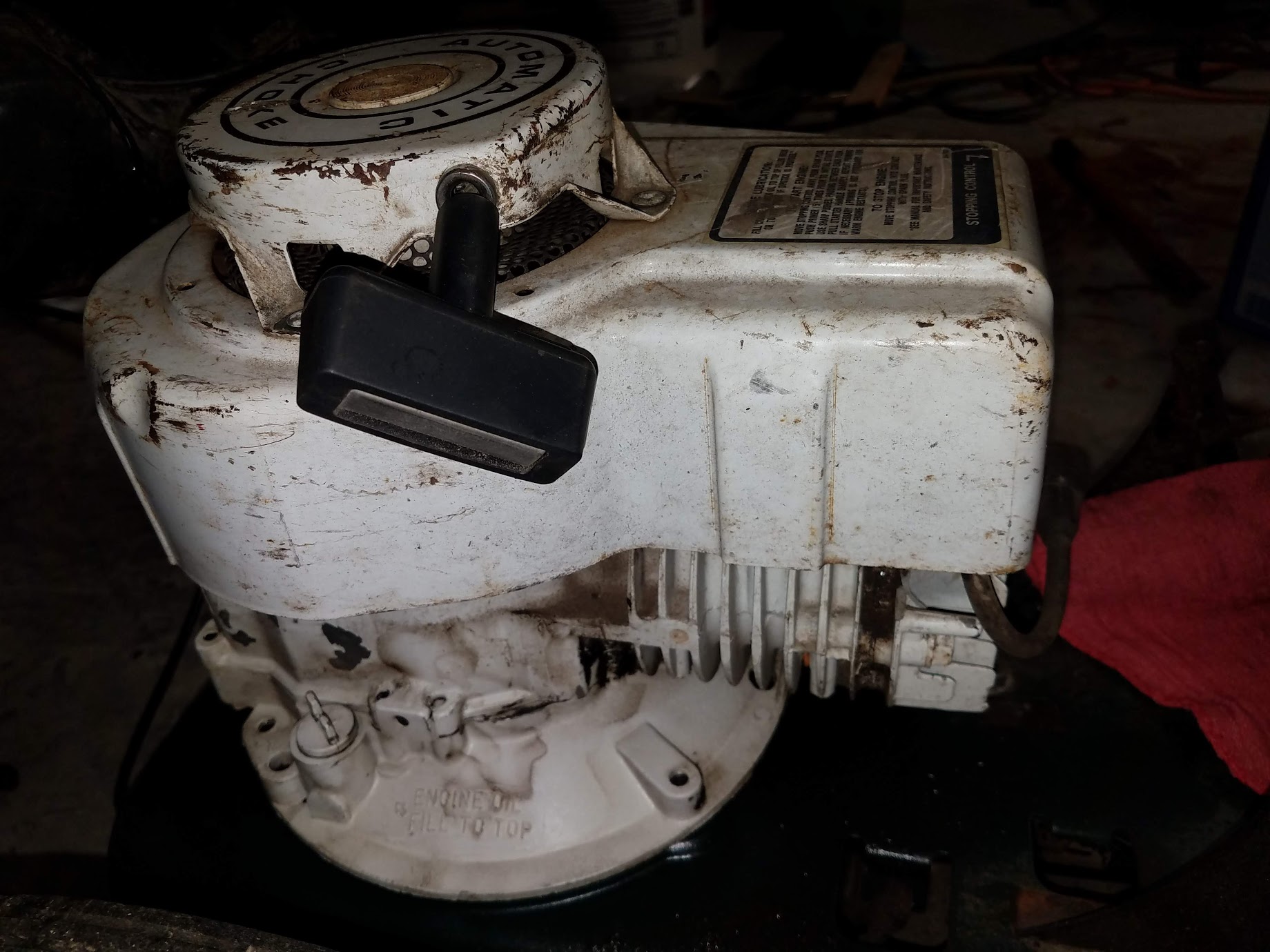

That kind of looks like a Tecumseh mill on that, I've got a folder full of Briggs manuals but nothing for that. There is a manual for it online though.

The governor spring is there above the throttle shaft in your first picture in post number 1. the spring pulls the throttle open and the governor pulls the governor shut, and the two fight until they find a balance at the correct engine speed. I still say that you have a carb problem. Something to check is to remove the air filter and look into the carb, and then pump the primer bulb and see if you can see gas shoot up through the top of the nozzle. If no fuel then either the bowl nut is still clogged, or you have an air leak around the primer, or bowl gasket.

It seems as you are slowly getting there. I`ve just noticed you have a fuel filter, and most engines do not come with one as standard. I wonder if this is restricting the flow to the carb. .If the fuel tank and fuel is clean, I find a lot of these engines run better without one.

I noticed when running the engine that it started smoking once it got hot. When I drained the oil after I had the engine running for a while it ran out like water, it was extremely hot. I am wondering now if the oil was so nasty because of blow-by. Also wondering if the smoke was due to excess fuel.
The engine is definitely not running WOT. Based on your description of the operation of the engine, if I were to weaken the spring it would cause the rpm to increase? I'm wondering why that spring tab is bent so much. I have plenty of spare springs and can try unbending that tab. Is the goal to run the engine WOT? I'd love to get it running at the desired RPM and then adjust the jetting so it isn't running so rich.

The governor spring opens the throttle, so reducing the tension will reduce the engine speed. You would need to pull the spring tighter, or in this case bend that tab even more to increase engine speed. Just make sure you know what speed the engine is actuallty running at and not just guessing. I have seen a few engines with the tab bend that far from the factory so it may be normal for that engine. Also Tecumseh should have a fuel filter built into the tank. It normally looks like a screen in the bottom corner near the fuel outlet.

Maybe I need a primer bulb without the hole?
/ Old engine not running, Craftsman brush trimmer #17
Pulled up parts diagram for the carb and it looks like primer no hole.

Can anyone point me to a manual or give me a description of this engine? I found a ton of Tecumseh manuals but I'm not sure which engine I have.
