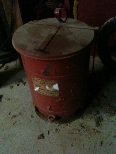

i've been thinking of getting one of those oil waste cans that you see all the auto shops use for their used rags. i read a little about it and i'm probably ok, because i toss the old rags together into a container and then reuse them until they are literally drenched in grease. what i did get from reading is that wet rags won't instantly ignite - i never really got the full understanding but it must be something to do with the chemicals reacting to air when they are dry?
anyways, i bought a bag of 100 red rags at a wholesale store a few years back, and i've still got a bunch since i keep using them for increasingly dirty tasks until the point that they deposit more oil/grease than they remove. once i have some that are all used up i drop them in the rag bucket at the shop of a mechanic in town who has a weekly service for uniforms and shop rags.

Pretty much every industrial supplier carries them. LSS, Grainger, MSC, etc...
NAPA and most auto parts dealers that cater to repair shops should have them too. I doubt you will find them at the consumer stores like Advance Auto though, but I could be wrong, I try to stay out of those places and deal with my local NAPA dealer.
