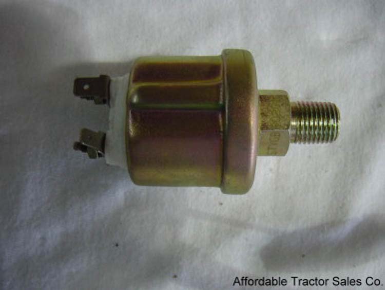

I have a problem with a brocken oil pressure sending unit that bolts on lower left side of engine on my Jima 204 .Can anyone help with a cross reference no. It is round and has two wires on it.I think the gage on dash is a New Holland part.Gage shows highest reading when key turned to on and engine not runing or when running.Thanks.Meaford man. ken.galliford@ rogers .com I am in Meaford Ontario Canada

Why does it have a NH gauge? Probably at this point the best thing you could do is go to the auto parts store and buy a $15 mechanical gauge or if you want he oem Jinma gauge contact one of the dealers on here and order both the gauge and sending unit.

Tommy, Yes that is the sending unit that I need but I'm in Ontario Canada and was hopeing for a cross reference number so I could get it at a local auto supply store.Do you know the number for that one? It fits a Jima 204 3 cylinder 380yd11 Yang dong engine, Thanks for help.

Sorry,I don't have a cross reference number,did you take yours to the auto parts to try and cross it?
