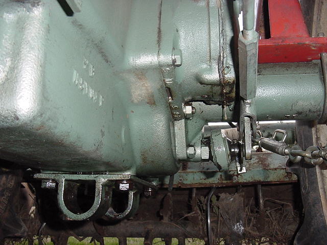

Ok guys, looks like my dealer didnt get everything fixed on my YM2000... I'll be handling it from here though.. I have a leak from what I figure(from diagrams I have seen) is the L/H brake drum. It appears to me that this leak is from an o-ring inside, again from the pictures I have seen. If anyone has been in this area and knows for sure, I would appreciate your input before I order tha parts.

I have had my brake cover/ drums off on my 3110, but I don't recall seeing a seal in that area. The 3110 may be different in that area than your 2000 . Shouldn't be a difficult repair though. good luck
/ Oil leak #3
I dont (think) the YM 2000 has wet brakes.
It could be water & rust leaking out ?

I don't see any leak that I would be concerned about.

Its definitly hydraulic oil of some sort. I've attached a link to Hoyes that shows #30 as being the o-ring I suspect. Again, not having been in there before, I'm kind of guessing.. But it looks logical to me. Could the trans fluid be leaking past the o-ring and into the brakes? I noticed that the dealer removed a pipe plug that appears to have been a water drain. This is probably why its leaking worse than when I took it in.
Norm,
It didnt really show up very good in that picture. However, it leaves a puddle on the floor overnight and coats the trans housing pretty well...

Greg, you're right about the plug being a drain hole for water.
As far as the oil leak,you also right about the seal.
Its a dirty job to replace that seal so far back in there /forums/images/graemlins/frown.gif, but it can be done in an afternoon.
If your brakes are in so-so cond. you might replace both sides while you're at it too.

Well guys, got an update for you on my leak.. Hope these pictures can help someone else too..(give you an idea whats in there)
I finally had a free day to tinker with my leaking "brake" /forums/images/graemlins/smirk.gif.. It wasnt the brake..
/ Oil leak
#14
The leak actually does come from the o-ring I was thinking it was.... The problem is that it is on the differential carrier /forums/images/graemlins/blush.gif..

In this one you can see, in the top left, the differential bearing(next to the ring gear).. The cast iron part to the left of the bearing, is the peice that needs to come out.. /forums/images/graemlins/crazy.gif The whole chunk..... Unfortunatly, what cant be seen in the picture, is that the differential drives an axle on each side through gear reduction.. The problem is that in order for the gears to mesh, this bearing housing (that I must remove) is notched out to allow the gears to mesh.. For me to get the housing out to replace the o-ring, I must remove the rear cover(where the PTO comes out) allong with the PTO shift linkage.. Then the axle gear must be removed, just so I can get this housing out and replace this $2(?) o-ring..... /forums/images/graemlins/crazy.gif
Needless to say, I'm a bit frustrated.... Doesnt appear to be all that difficlut, just time consuming.. Unfortunatly, due to my schedule I needed to cut a corner... So a little silicone later, I think thats ok... Now I need to het the gaskets and seals to put the rest of it back together so I can use it when I get back in town.... /forums/images/graemlins/crazy.gif
Oh, well... Just thought I'd post the pics so the guys that didnt know what was in there could see, and maybe the guys that know something about it can correct me and give me an easy fix /forums/images/graemlins/grin.gif..
