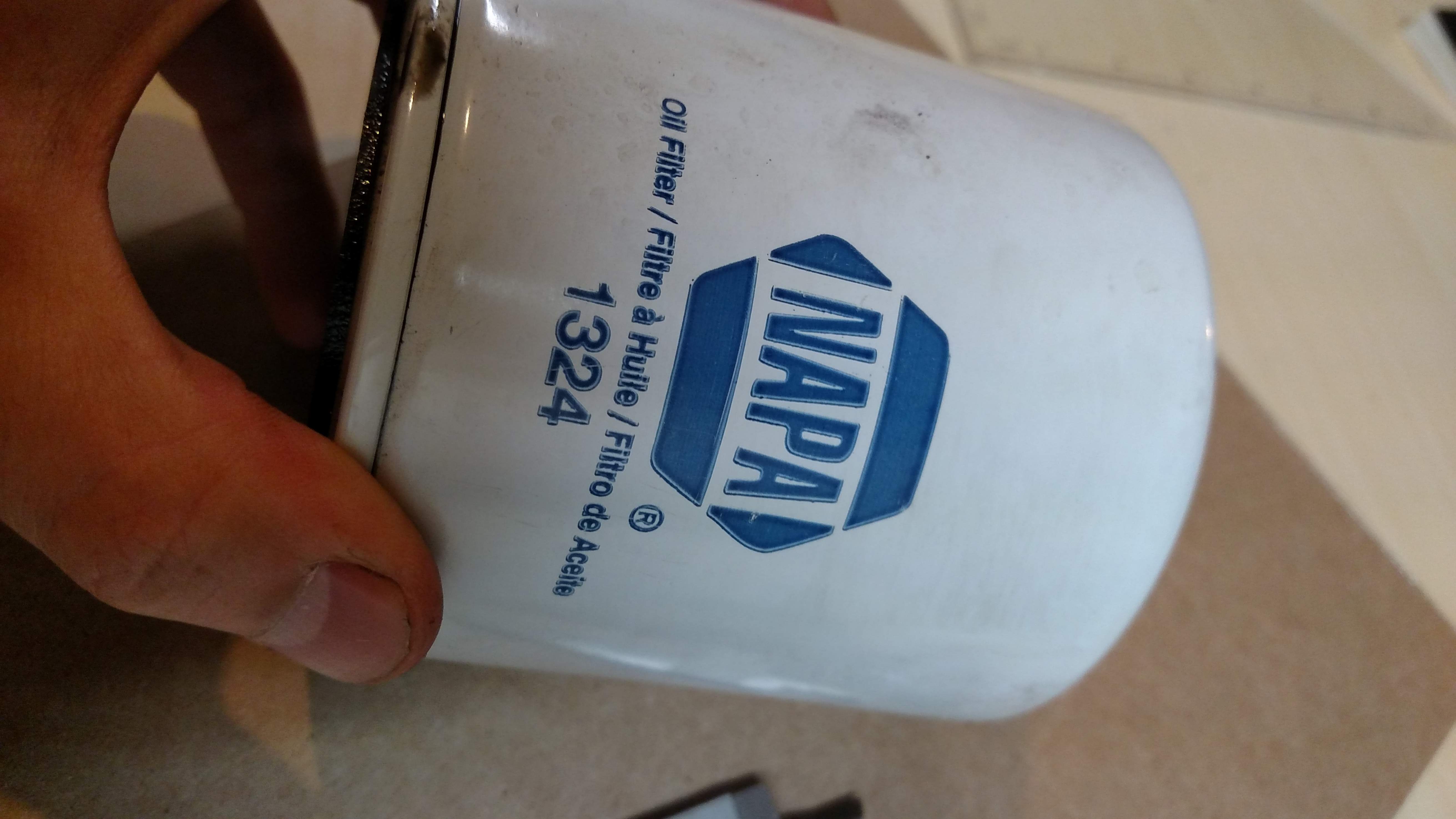

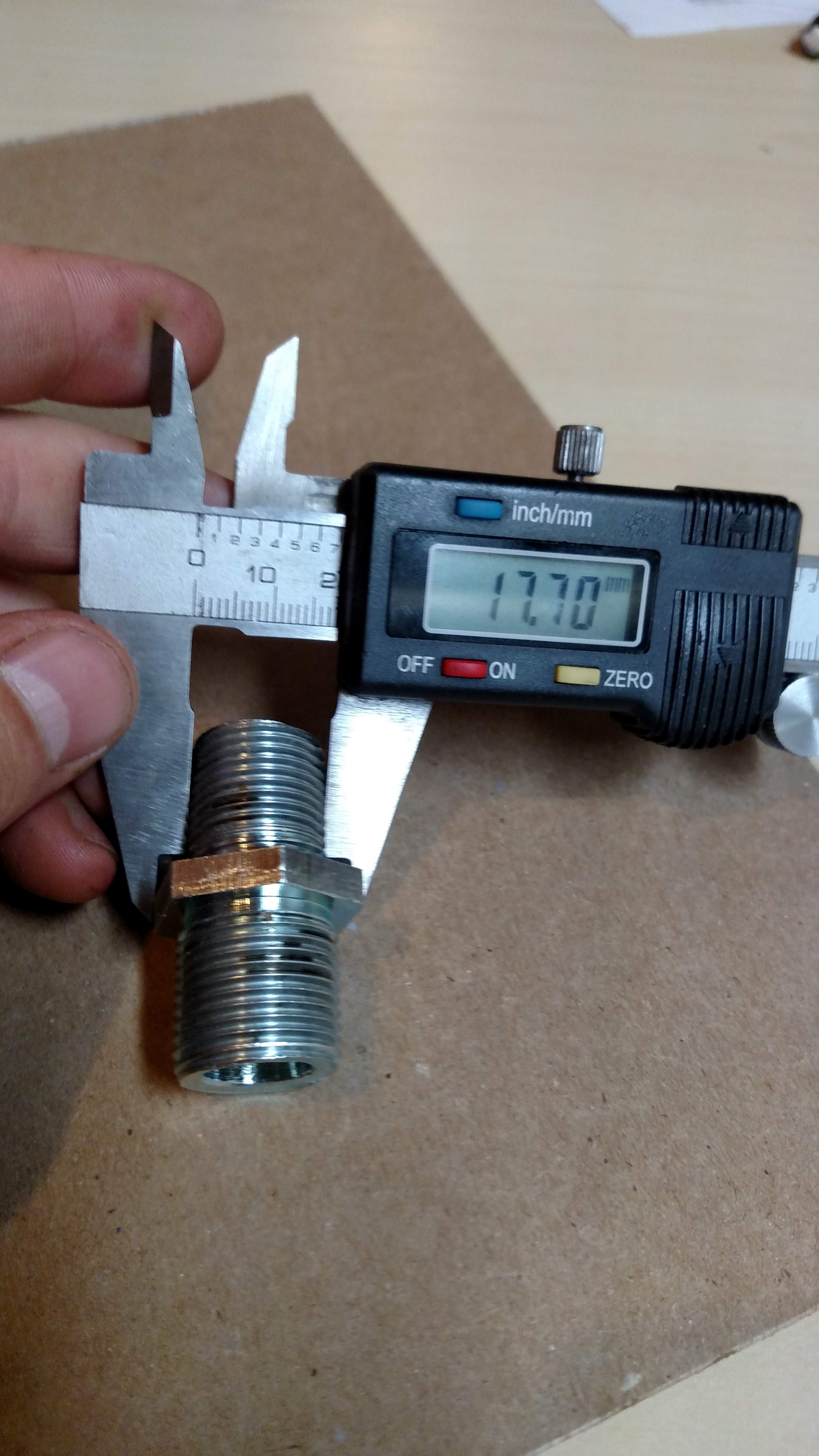

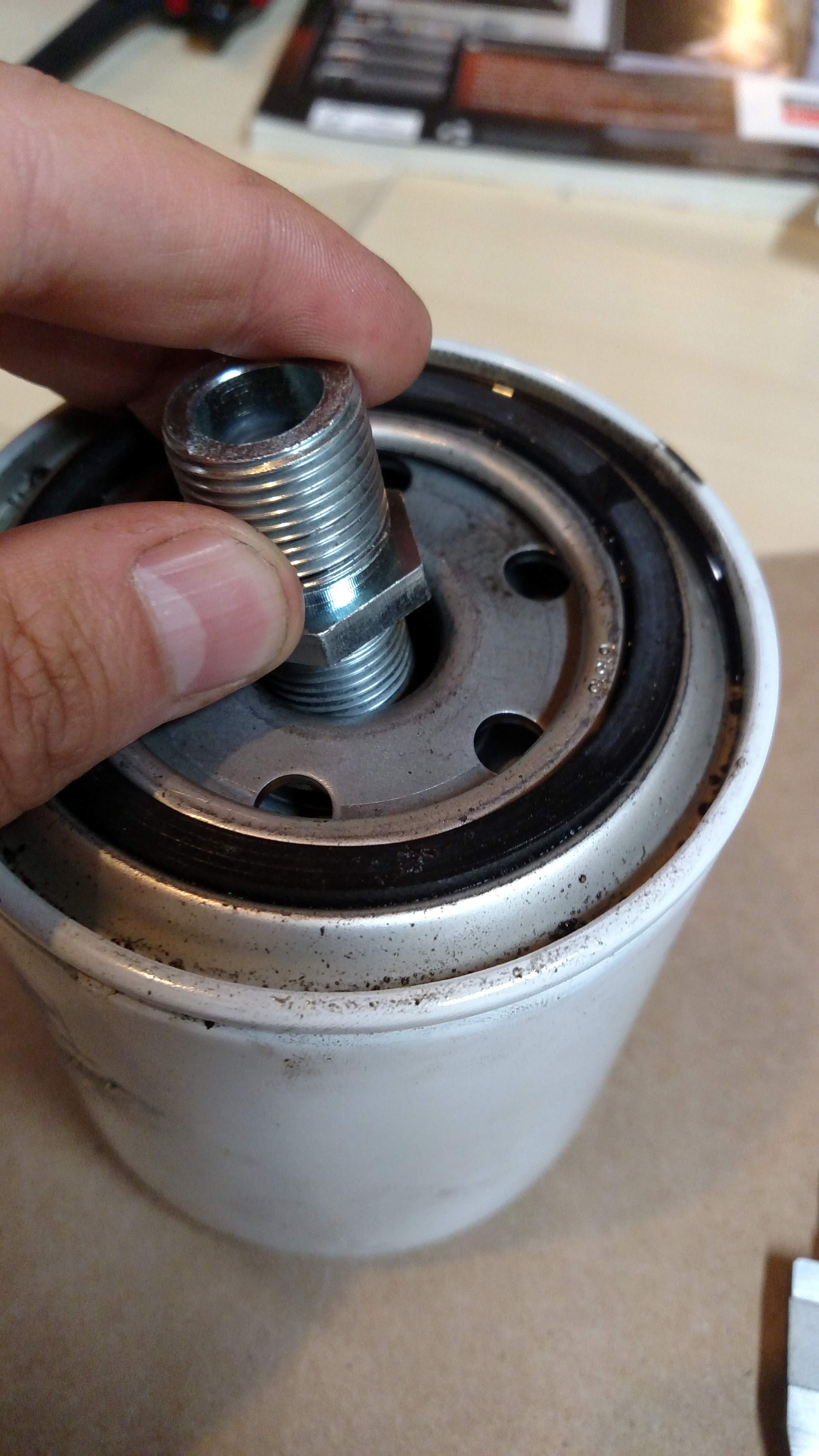

This is the Napa 1324. This is also the "tube connecting", that i ordered directly from bobcat. I thought it would fit the Napa filter, but it's exactly the same as the one on the tractor.
It can't be a coincidence that i ordered both the "tube connecting" and the bobcat 6696286 filter, and they match up exactly, and are exactly what's on my tractor.
The only thing i can think of is that maybe Napa assumed the Kioti was the same as the bobcat and used that as the reference. Maybe some bobcat's use the Kioti stuff, and some the bobcat.

What is the measurement on the other end of that adaptor. Perhaps that is the end that goes in the block.
What is the ID measurement of the bobcat filter.
The bobcat filter you claim you got that fits, is listed at 20mm threads. Exact same as the Napa.
Do you have a picture of the bobcat filter beside the Napa one?
I guess what I am getting at is:
1. We know the Napa filter is 20mm threads
2. The bobcat filter is listed the same.
3. Both should work.
4. You claim the Napa filter is different. Actually, the Napa matches specs exact, so technically you are claiming the bobcat has threads smaller than listed.
You aren't doing a very good job trying to convince.anyone. IE, you are only telling one side of the story.
1. Take a picture of your calipers on The threaded adapfer ON THE BLOCK.
2. Take a picture of the filter threads side by side.
3. Take a picture of your calipers measuring the thread ID of both filters.
Only taking pictures of the Napa filter and showing that it has 20mm threads like it is supposed to does nothing to help figure anything out.

Not wanting to cause a riff either but just an obseration. Looking at both the Bobcat CT235 and Kioti CK35 on line parts list the pictures both indicate the large end of that adapter is where the filter screws on. May be a bad drawing but that is what it looks like. Would be interested to know the size of the large end?
   / Oil filter doesn't fit!! Weird
#37
I should have taken a photo of that too. The big end drops right into the NAPA filter too. It's too small for the Napa filter.

The adapter is on correctly, and i measured the correct side. And as i mentioned, BOTH ends of the adapter drop right into the Napa filter. BOTH ends are too small for the 20x1.5 filter threads. That can't be the problem.
