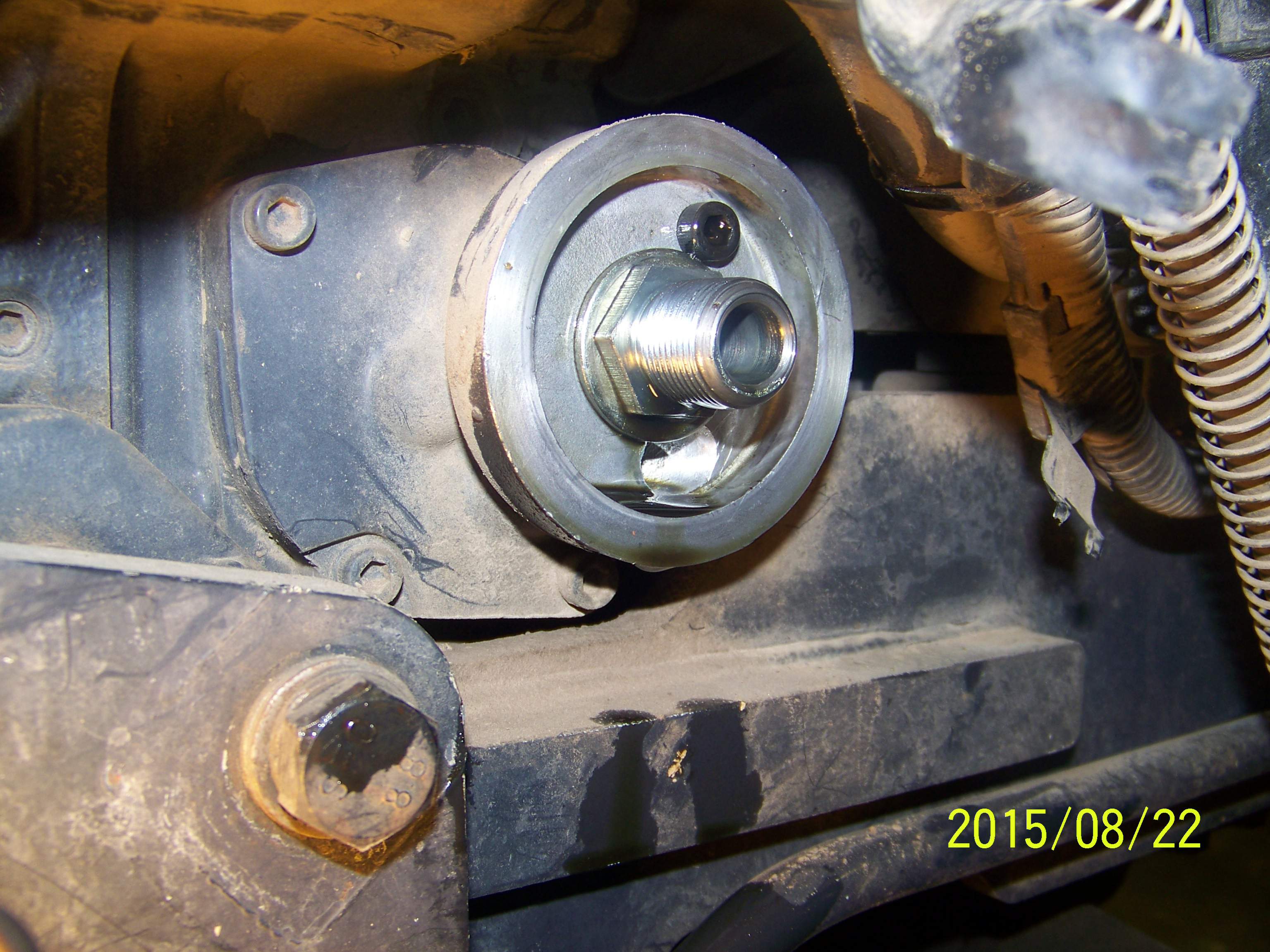

Check out these photos.
/ Oil filter doesn't fit!! Weird
#32
This is the Napa 1324. This is also the "tube connecting", that i ordered directly from bobcat. I thought it would fit the Napa filter, but it's exactly the same as the one on the tractor.
It can't be a coincidence that i ordered both the "tube connecting" and the bobcat 6696286 filter, and they match up exactly, and are exactly what's on my tractor.
The only thing i can think of is that maybe Napa assumed the Kioti was the same as the bobcat and used that as the reference. Maybe some bobcat's use the Kioti stuff, and some the bobcat.

What is the measurement on the other end of that adaptor. Perhaps that is the end that goes in the block.
What is the ID measurement of the bobcat filter.
The bobcat filter you claim you got that fits, is listed at 20mm threads. Exact same as the Napa.
Do you have a picture of the bobcat filter beside the Napa one?
I guess what I am getting at is:
1. We know the Napa filter is 20mm threads
2. The bobcat filter is listed the same.
3. Both should work.
4. You claim the Napa filter is different. Actually, the Napa matches specs exact, so technically you are claiming the bobcat has threads smaller than listed.
You aren't doing a very good job trying to convince.anyone. IE, you are only telling one side of the story.
1. Take a picture of your calipers on The threaded adapfer ON THE BLOCK.
2. Take a picture of the filter threads side by side.
3. Take a picture of your calipers measuring the thread ID of both filters.
Only taking pictures of the Napa filter and showing that it has 20mm threads like it is supposed to does nothing to help figure anything out.

You really don't believe me. I'm not sure it's worth trying harder. I'm not trying to prove you wrong. Just trying to put this info out there, because i've learned from other people's experiences on this forum.
The adapter on the tractor is identical to the one i show in the photo. I threaded the new filter onto it (fit perfect), then i put the new filter on the tractor, where it filters now. It fits perfect, and matches the filter i took off the tractor exactly. I'm not pulling it off.
Where are you seeing the specs for the bobcat filter? The Napa site?
All i'm suggesting is that Napa has an error in their cross reference for the bobcat filter. I'll get my filters from Bobcat. No big deal.
Maybe someone else will benefit from this info, if they come across this problem. Hopefully it helps them.

I should have taken a photo of that too. The big end drops right into the NAPA filter too. It's too small for the Napa filter.

The FIRST thing i did when the Napa filter didn't fit, was go to the parts store that sells Wix. I assumed Napa gave me the wrong one. I had gone to a Napa while out of town on business, so i couldn't easily go back to that same one.
I brought in the Napa and Bobcat filters. The parts guy measured both. He pulled the correct Wix, and it matched the NAPA exactly (Confirming the Napa wasn't a foul up). He dug through his books for the better part of a half hour trying to figure out what the old filter was, but couldn't. The threads measured around 18mm on the filter. Could be standard threads i guess, rather then Metric.
That's when i assumed the adapter was changed. So i ordered one. For the **** of it, i ordered the filter too, just because i figured i may have gotten dirt in the NAPA one while screwing around.
The adapter is on correctly, and i measured the correct side. And as i mentioned, BOTH ends of the adapter drop right into the Napa filter. BOTH ends are too small for the 20x1.5 filter threads. That can't be the problem.
I will dig the old one out of the trash and post more photos with measurements. I may even pull the new filter and adapter off the tractor, although, it will be a massive waste of time.
Someone have a Bobcat dealer close by? Go buy a filter and measure it. I don't have one nearby. The closest one is 30 minutes, and is open 7:30 to 4, while i'm at work.
