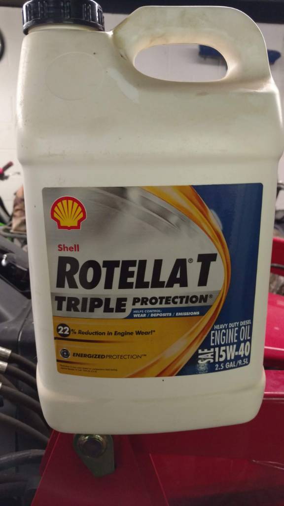

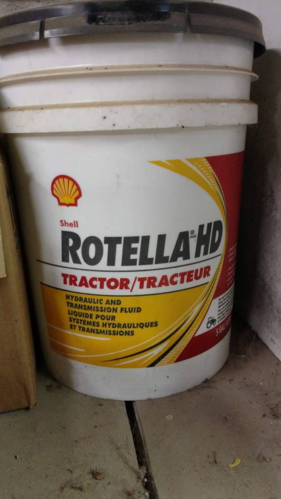

/ Oil Equivalents #13
Here is what I use in mine. IMG_20190525_100337011.jpegIMG_20190525_100353261.jpeg
